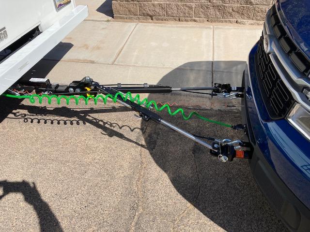

Hello all I am a new member and am expecting delivery of a hybrid XLT next week. I purchased this vehicle specifically because it can be flat towed behind my motorhome with all four wheels down (per the owners manual). Anybody out there with experience towing a Maverick?​
My 2023 Lariat completed and tows like a dream. Used Roadmaster base plate and bar and Demco stay and play duo brak,ing system all for less than $4000. Install was done by "Just For Tow" in Yuma Az (in business 39 years) and it came out perfect and tows well behind my V10 22M Minnie Winnie.

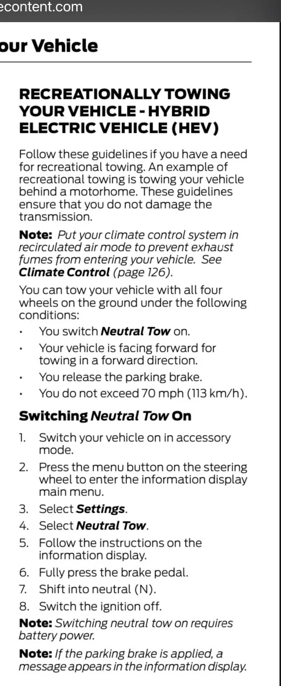

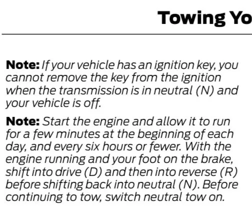

I wouldn't unless unless you physically disconnect it at the wheels. Better to use a tow dolly.
Absolutely incorrect. The hybrid is designed to flat tow. A few simple steps to put it in tow nuetral. Pics are from the owners manual. Never understand why people respond when they are just guessing.
Yeah? Okay.
