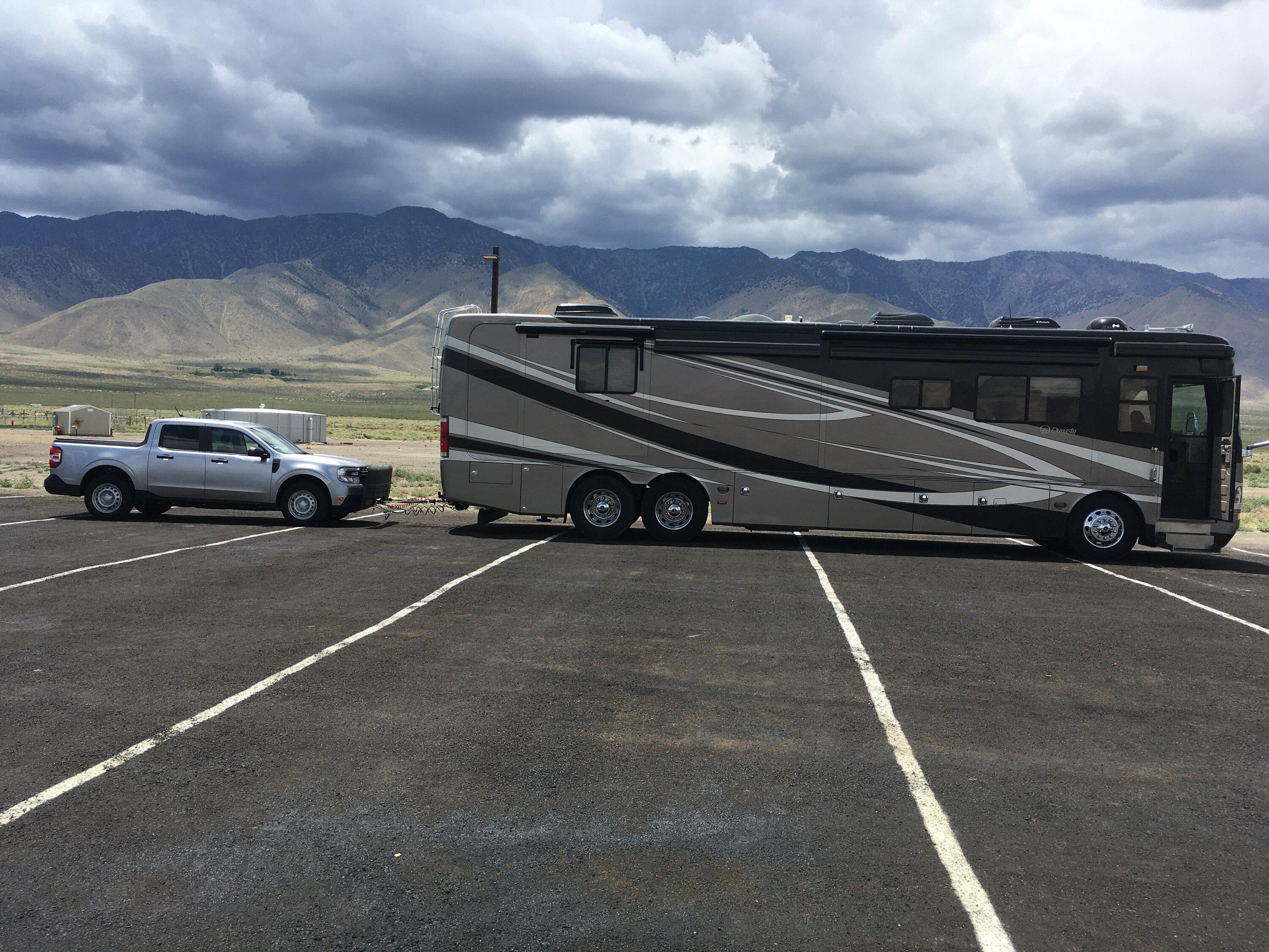

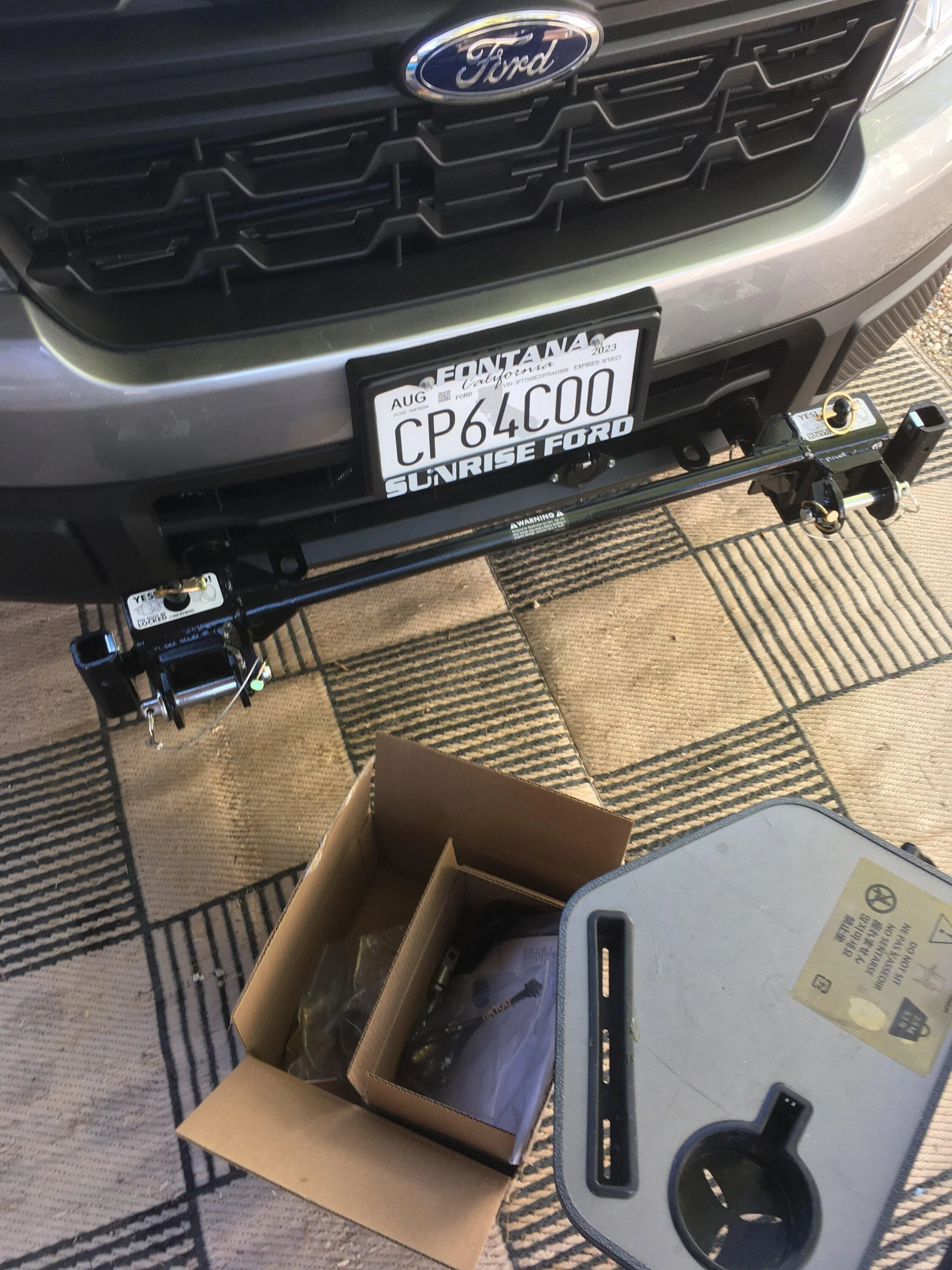

I’ve been flat towing since May with no problems. I bought my roadmaster base plate and everything needed to tow the Maverick from Etrailer they know and sell everything you need. I would recommend you call them and tell them what your towing and they will tell you everything you need.

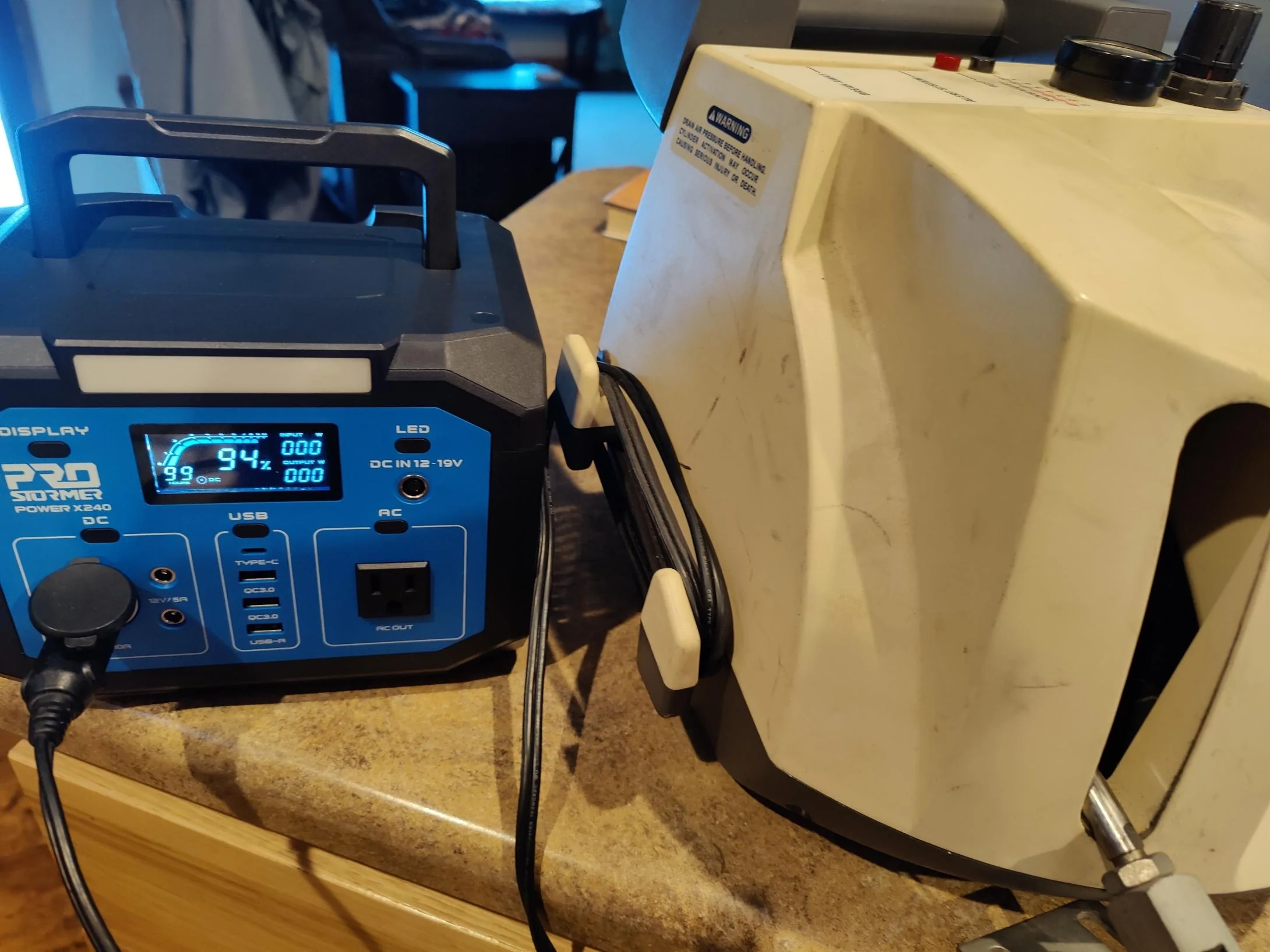

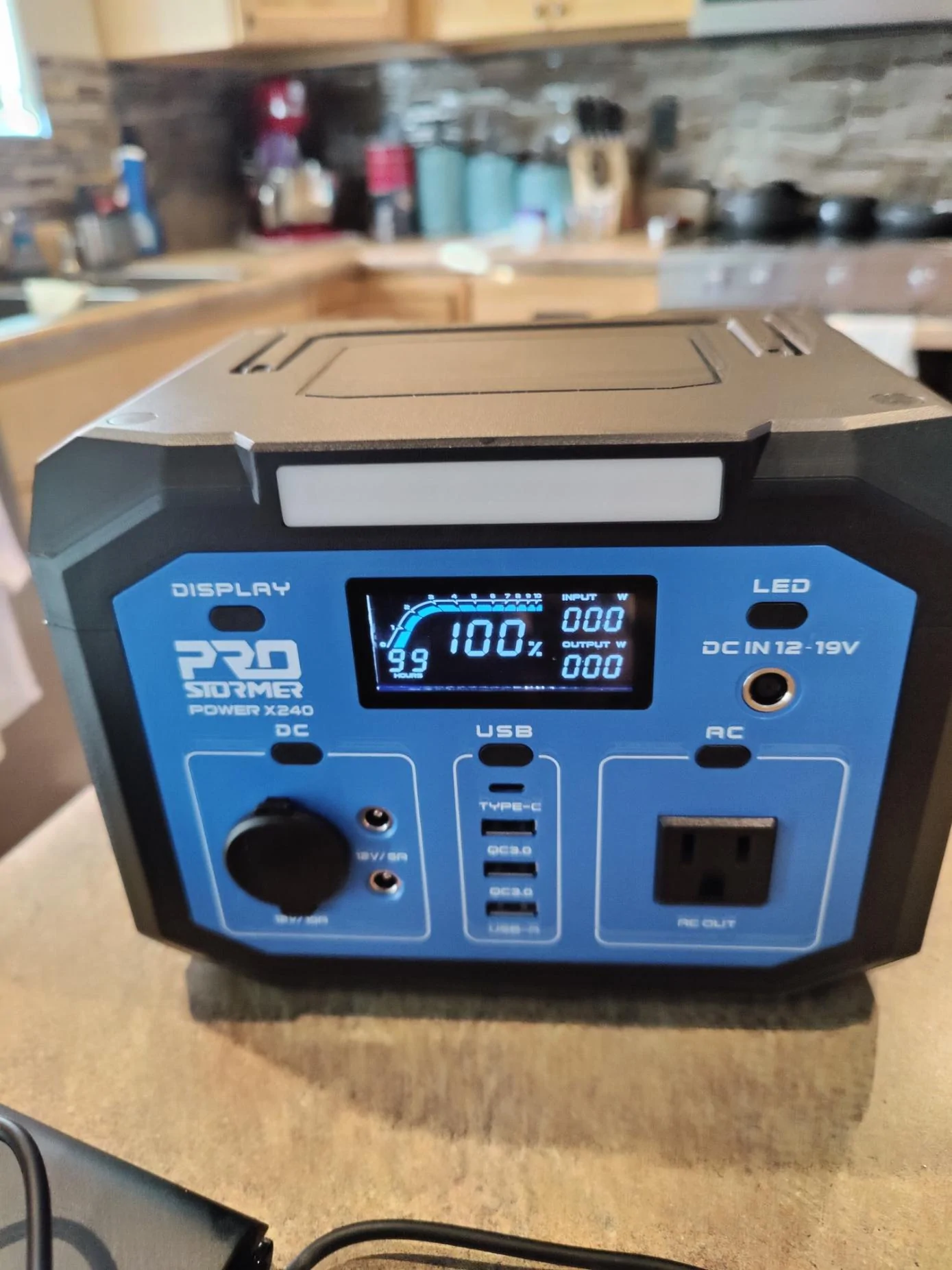

I had a new revelation thanks to someone, somewhere here or on Facebook.
Background:
I don't just tow the Maverick, I tow other vehicles. Powering the old Brake Buddy Classic I've used for 20+ years has always been a challenge. My Jeep has a constantly-live 12 volt outlet to power the Brake Buddy...but it has no charge wire. The Maverick, on the other hand, has a charge wire, but I was planning on having to add an extra 12 v socket, running directly to the battery under the back seat...or out at the charging posts in the engine compartment. When I towed last summer, the brakebuddy was un-powered after the 30 minute delay, because I had no dedicated, always-on power.
The revelation:
Someone posted that they had a jump box that had a 12v outlet. Schumacher makes a variety from $100-$300 and Walmart has something similar. The person sets theirs in the passenger floor to provide power for their braking system. Great idea.
My solution:
I found the pictured ProStormer power box on Amazon that has a 201.6 watt-hour lithium battery and all sorts of outlets: 110v, 12v (10A), and various USB ports. Amazon says Currently Unavailable today, but I bought it just this week for $54.95. Now all I need is to set it on the passenger side of whatever towed and plug the BrakeBuddy into it. No extra socket; no dead battery worries.
When the compressor in the BrakeBuddy runs, it takes about 100watts (8.3 amps) and less than 2 minutes to charge from dead. 100w times 1/30hr equals 3.33 watt-hours. Thus with 201.6 wh, the thing is capable of recharging the BrakeBuddy 60 times before it needs recharging. That would be a LOT of assisted stops, as I always turn the sensitivity down low to not need supplemental braking except to stay legal. Also, if the Maverick ever breaks away from the coach, the BrakeBuddy's power would turn on and stay on for up to 60 minutes of brake pressure to stop.
I used the test button 3 times and this thing reports that after the three BrakeBuddy recharges, it still had over 95% capacity remaining.
This is going to be a game changer for me, as I did not want to tax the Maverick's battery, nor add anything to cause Ford warranty issues. This thing will charge via a 110 cord OR an included 12 volt cord. And as you can see, it reports its charge status.
