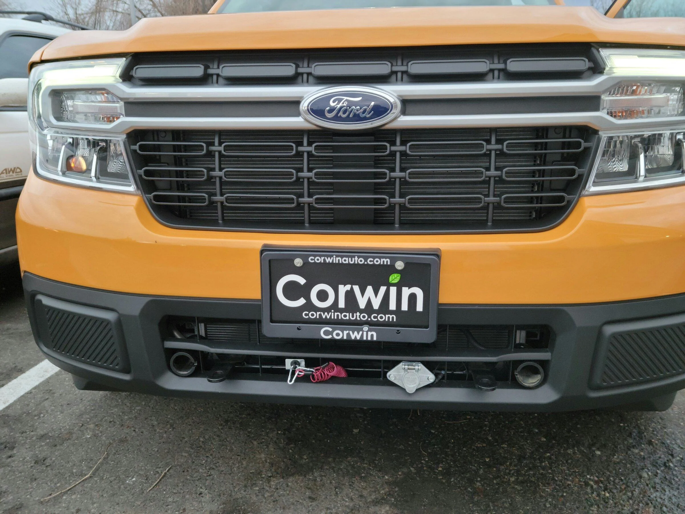

Roadmaster posted some picks of a CO Lariat being fitted for a baseplate on a RV forum website. Coming soon…..

Roadmaster posted some pics on iRV2 the thread has since been taken down. The thread got a bit off topic thus the removal. From what I saw I looks like a fairly easy install. No trimming of the fascia. Just a little trimming of the air dam. The install for the escape hybrid is very similar. Here is a link for the escape install,
https://www.roadmasterinc.com/pdfinst/524465-4.pdf

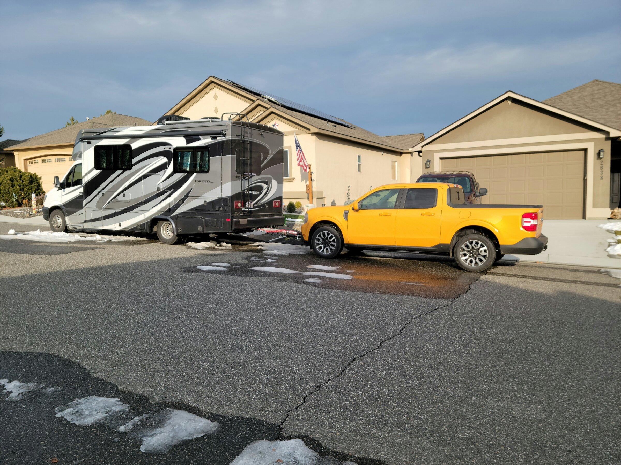

Here is a picture of the first Hybrid Maverick being towed. I am using a NSA Brute Elite tow bar with the newly designed Roadmaster Base Plate and all wiring. I also had a Roadmaster Invisibrake Braking System. Also included with the install is a trickle charger from the tow vehicle. They asked me let everyone know that the Base Plate will be available in 7 to 8 weeks and to please not call asking for date to be available but feel free if have questions about System. They are very busy getting everything available.

The Maverick towed very nice and the Roadmaster system is very quick and easy to unhook and hook up. Took maybe 2 minutes to hook/unhook easiest I have ever done.

They took 5 days for mine yours may not. I decided not to use because I couldn't really see a way of getting through everything like my jeep. Just to let you know NSA does not have the correct clevis for the Elite and Roadmaster. The clevis they sent me for the roadmaster does not fit any of Roadmaster parts. They had to adapt there part to fit my clevis. Order the aluminum 3/4 inch clevis for Roadmaster from NSA.
