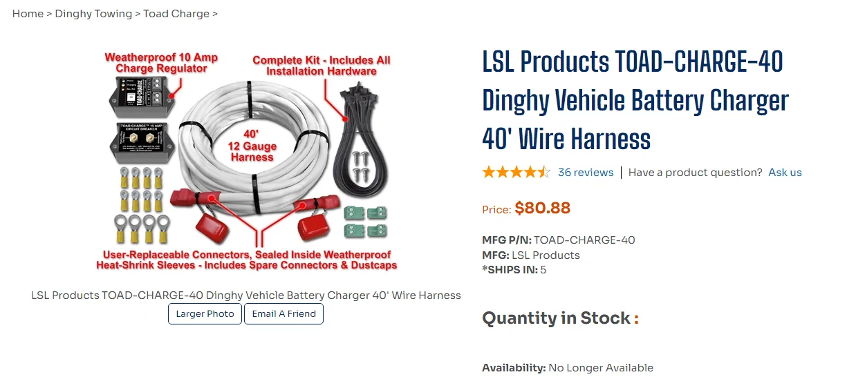

To add to this, I used a "toad-charge" unit on my C-Maxes, and now a Hopkins Battery maintainer on my Maverick. It takes the +12 volt line from the 6-pin tow cable and fees it through the unit that has a 5A fuse AND a diode in it to prevent power from being taken from the Maverick back out to the motorhome.
While it is generally always referred to as a "charge wire", it is NOT simply a wire running from the motorhome to the towed.
The Toad-charge was nicer and had a circuit breaker instead of a fuse, but the manufacturer died and they are now pretty much unavailable. The Hopkins worked fine on my 2622 mile, 2-1/2 week trip.
https://www.amazon.com/Hopkins-39332-BrakeBuddy-Vehicle-Maintainer/dp/B004RCXB8A/ Here is the older Toad-charge...if you can find one. You don't need the cable if you connect the two items to the charge wire from the 6-pin.

On my Cmax and the Maverick I have run the wire from the battery charge circuit of the motorhome directly to the battery ( in the Maverick I used the under hood jump post). I checked and confirmed the battery charge circuit from the motorhome is fused and good to go. I did add a diode on the Maverick circuit as some thought it was a good idea. Never seemed to matter to the Cmax, it never had a diode. May or may not help the Maverick.
When I was getting ready to get the Maverick towable, I looked closely at these "toad charge" type of packages. I would have bought the one....that is no longer available. But I cannot see where they really do anything that I didn't do by adding my diode?
