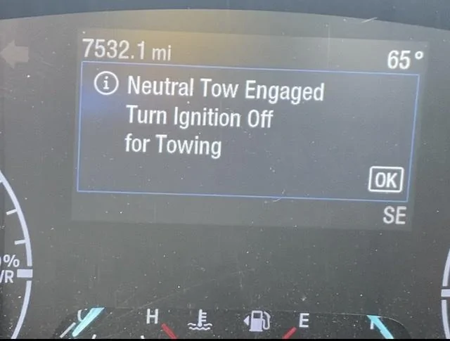

Ford Maverick Flat towing the Maverick? 24CBED5D-E9EB-4363-B117-E1CB5BB57B2B
Ford Maverick Flat towing the Maverick? 6BC23314-507D-4466-81AC-6E51C72F6A98
Ford Maverick Flat towing the Maverick? FB5A11FD-9615-44A9-80FF-545B3A0A75CE
Ford Maverick Flat towing the Maverick? 121E9D7A-B139-4585-8748-0C5B80D7DB9D

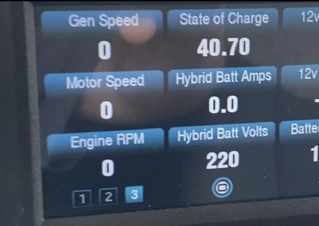

You tell ignition is "on" because fuel is reading "F" above.
Ford Maverick Flat towing the Maverick? 1468F2FD-CE61-4AF4-869F-ACC8F1050B6F
You can tell ignition is "0ff" because now there is no fuel (or temperature) sender data above

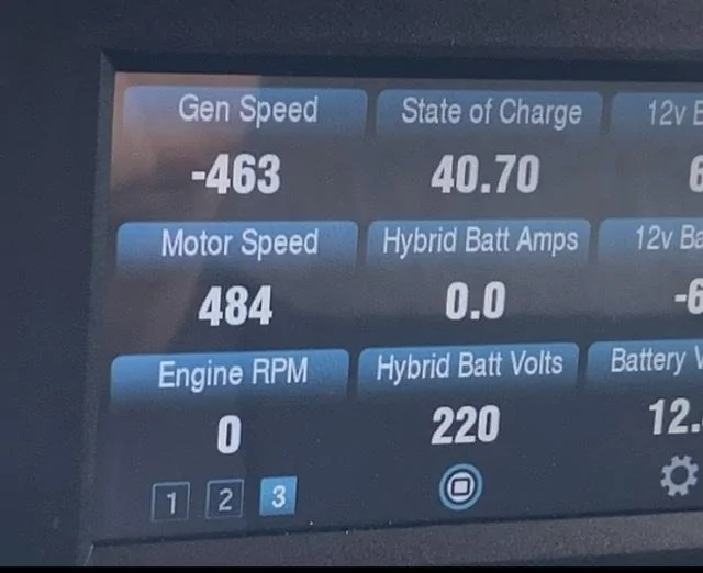

Next, I started to roll down a gentle slope in an empty parking lot since I did not have an RV to "tow" my Maverick. I started at a dead stop
Ford Maverick Flat towing the Maverick? FEC80AFC-A77E-4D15-B5C2-6B3DFF4965F5

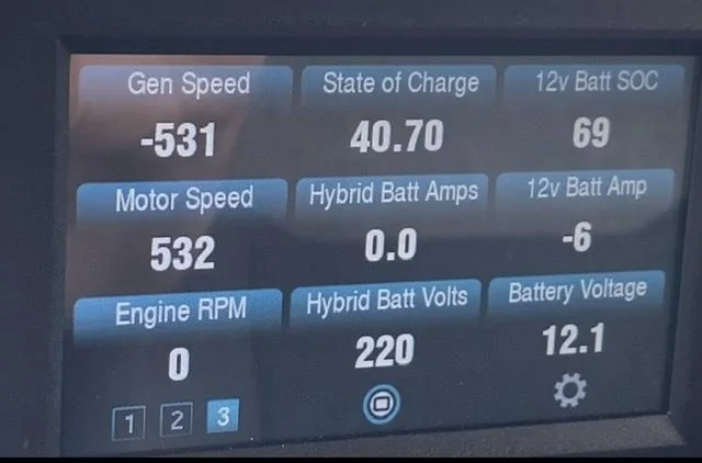

At ~4 mph both generator and traction motor were being spun
Ford Maverick Flat towing the Maverick? 43B616CA-6B52-4E39-BD0C-9C42DAF686D7
Ford Maverick Flat towing the Maverick? 45479576-A7B7-4B53-AD4B-4794509E5BC7

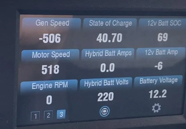

At ~ 5.25 MPH
Ford Maverick Flat towing the Maverick? 4AA063C4-080F-4587-B38A-9F53F1EB4E41
Also you can tell the ignition key is to off by looking at the 12v system. At 12.1v you know the DC/DC converter is off. Normally it provides 14.5v to 15.0v.
The scary part is the truck is consuming 6 amps in TOAD mode.
