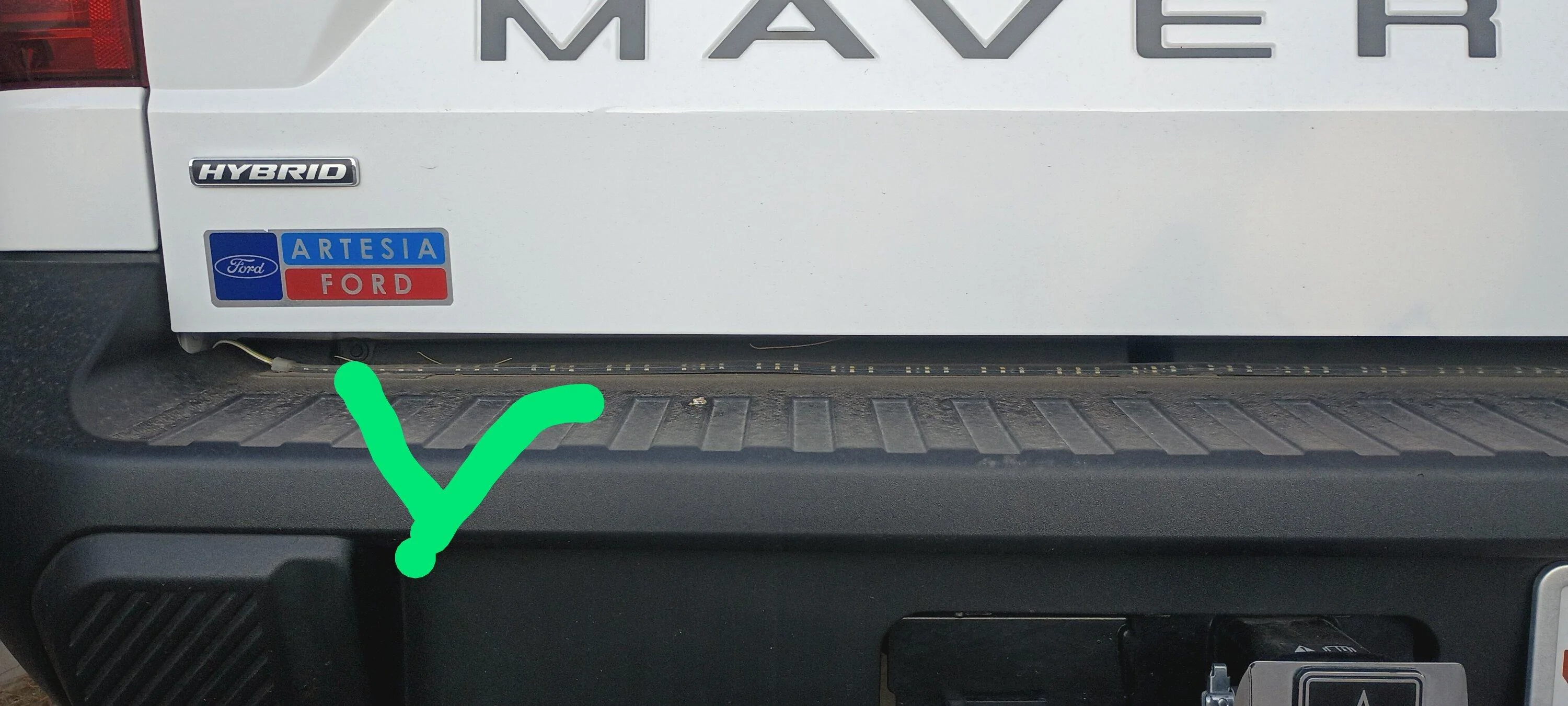

A word of caution regarding the diodes. I had mine professionally installed then later had my passenger tail light go off intermittently. I took it to the dealer for a recall and asked them to check on the tail light issue. When they found out about the diodes and lasfit bulb upgrade, they required me to have it restored to factory set up before they would do any recalls or computer updates. I restored it back to factory, Ford did the update, tail light now working. I ended up just using a tailgate stick on light for my tow lights and it's totally independent from the factory wires. Good luck,Hope this helps.

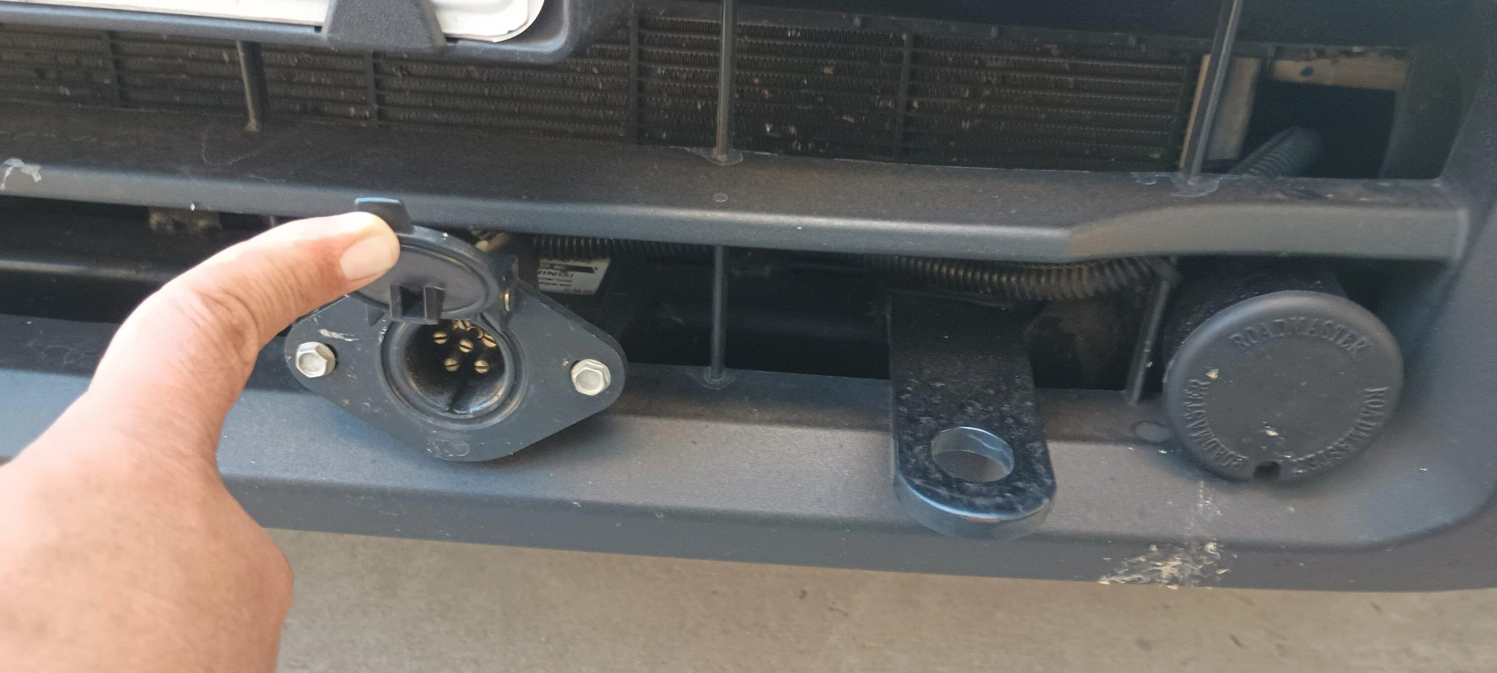

I kept the standard round RV light connector and wiring to the back. Instead of connecting to the diodes, I connected the wires to the tailgate light strip. It has its own 3m tape to stick it on with.

Better make sure your tow bar will work with the Blue Ox baseplate. My Blue Ox Alpha tow bar, and my new Ready Brake towbar will NOT work with the Blue Ox baseplate without heavy modification. Blue Ox claims they have a tow bar that will work with the Maverick base plate, I would call and confirm that.
The problem is the 41" between the attachment points of the Maverick base plate. Typical is 24-31". In a tight right or left turn the tow bar runs out of clearance and the bars bottom out in the pivot area. That causes extreme binding of the components!

I could remove the Blue Ox baseplate. There are covers on ebay to cover the front fascia areas that need to be cut out to allow the Blue Ox tow parts to protrude. But I think I have the problems associated with it worked out. Took a good bit of machining........
