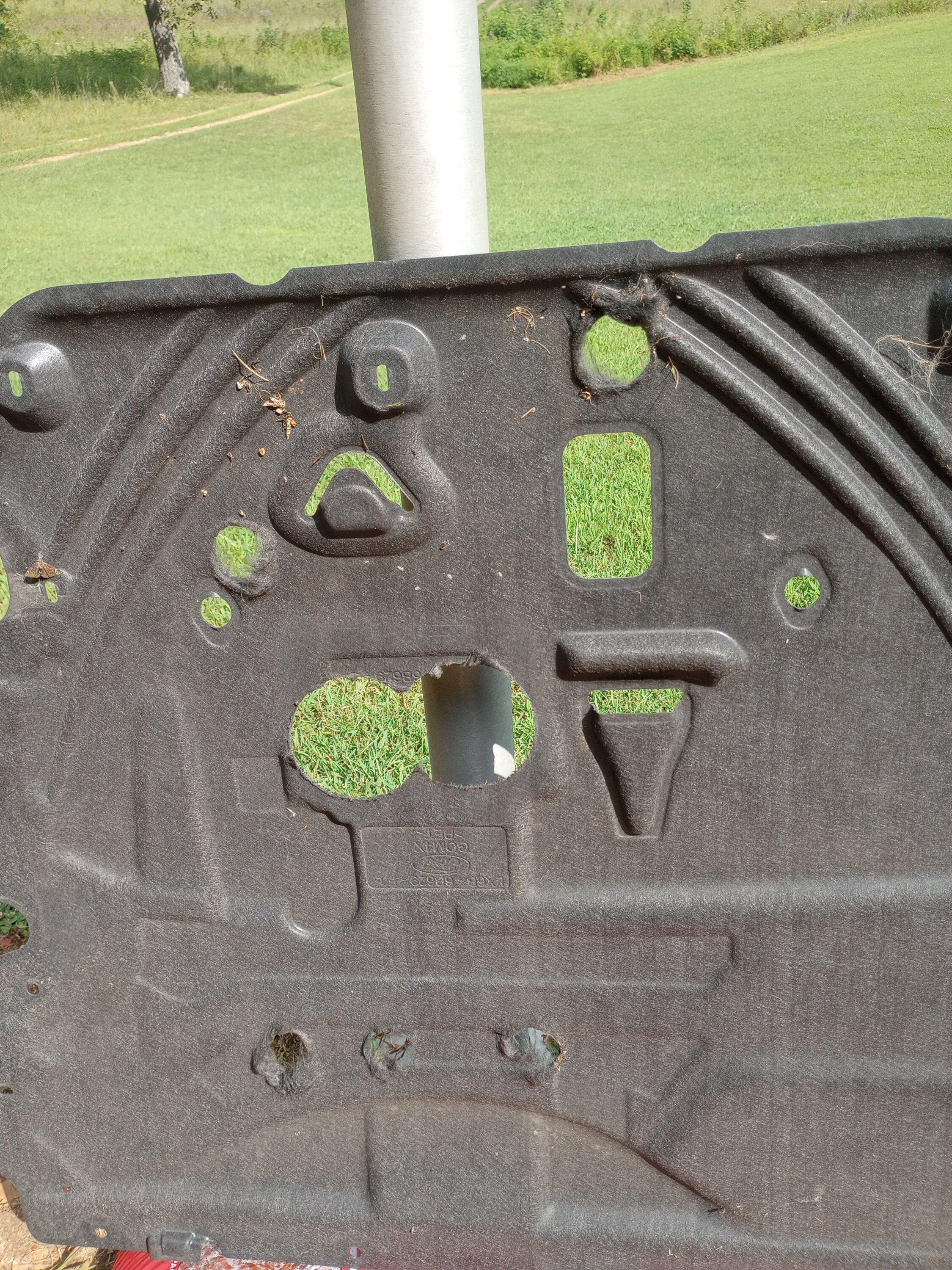

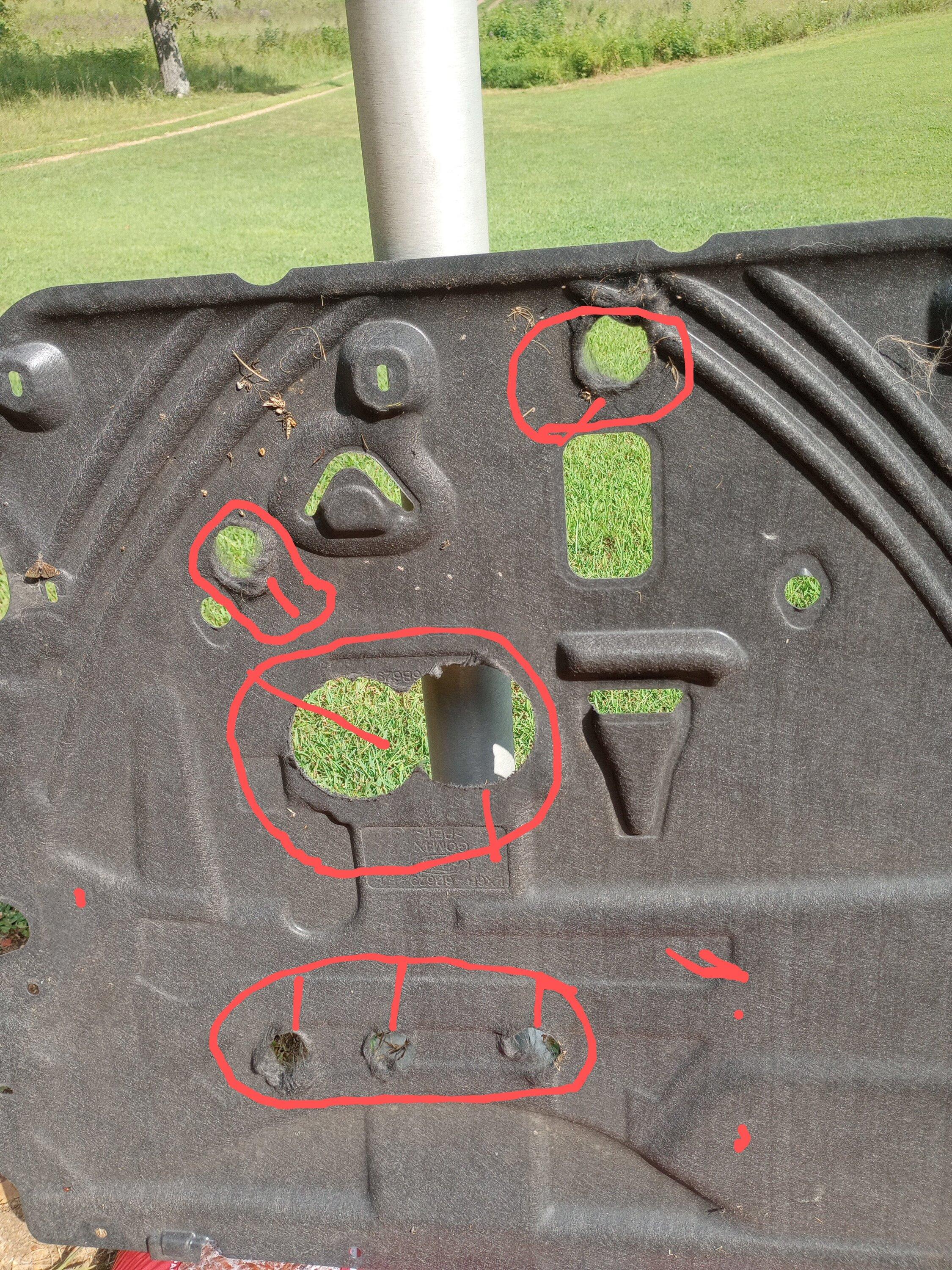

Next time I change my oil I'm going to cut a hole in the bottom pan. so I can change the oil and filter with out taking it off . Going to put hinges and a small latch to secure the piece back in . Hey Ford are you listening I'm sure you could do this also and look alot better then mine will look but you won't hell my pan is so butchered from the dealership and falling apart and you won't replace it . I love my Maverick But Fixed Or Repaired Daily with all these recall repairs are crazy Also Ford wears your second recall repair for the fire problem you said it would be out in October of 23 well if you're not looking at your calendar it's October of 23 late October of 23 just thought I'd let you know Ford ⁉
Mine after I cut out the square for the oil filter, and an additional cut out for the drain plug.....
