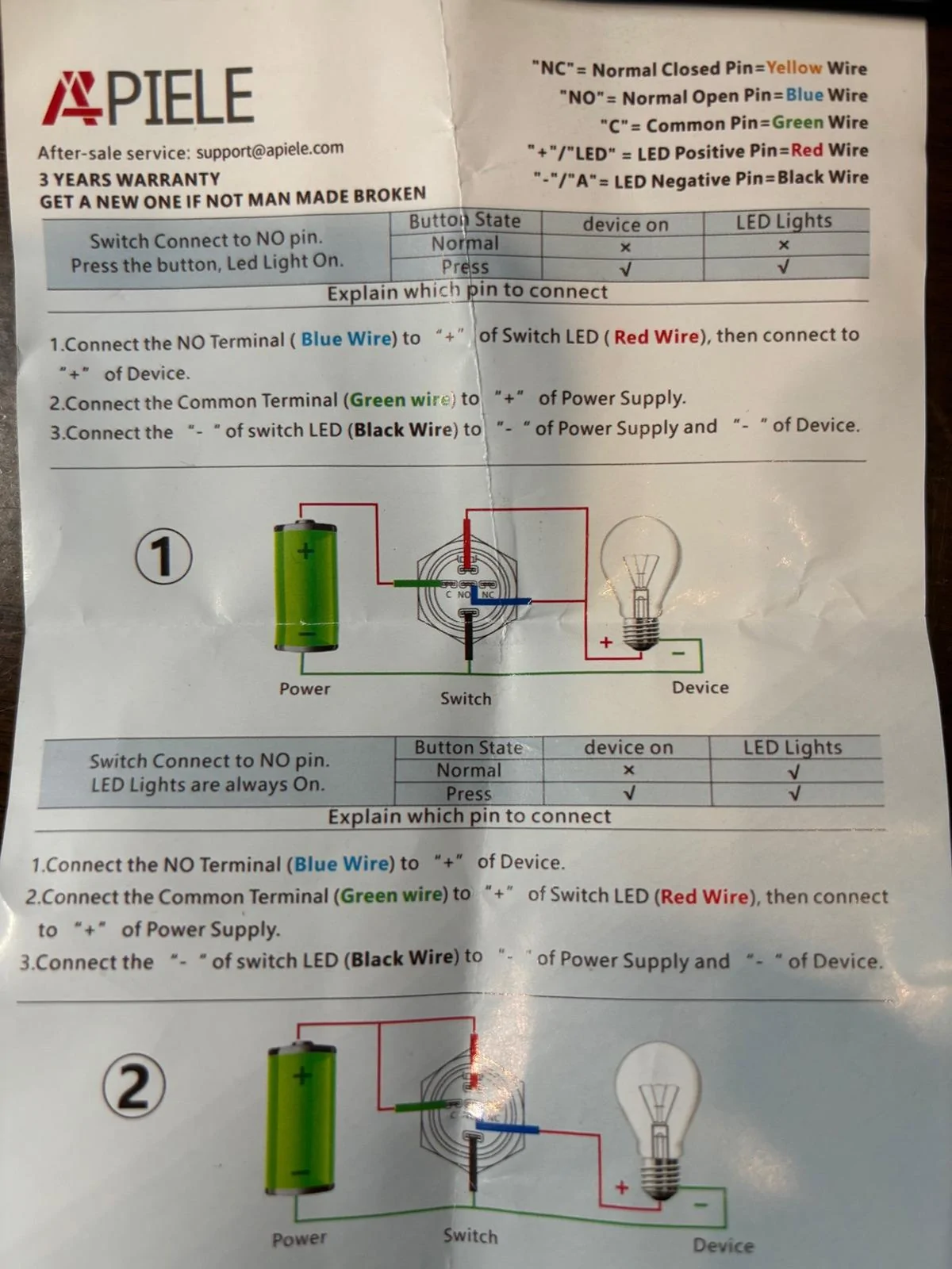

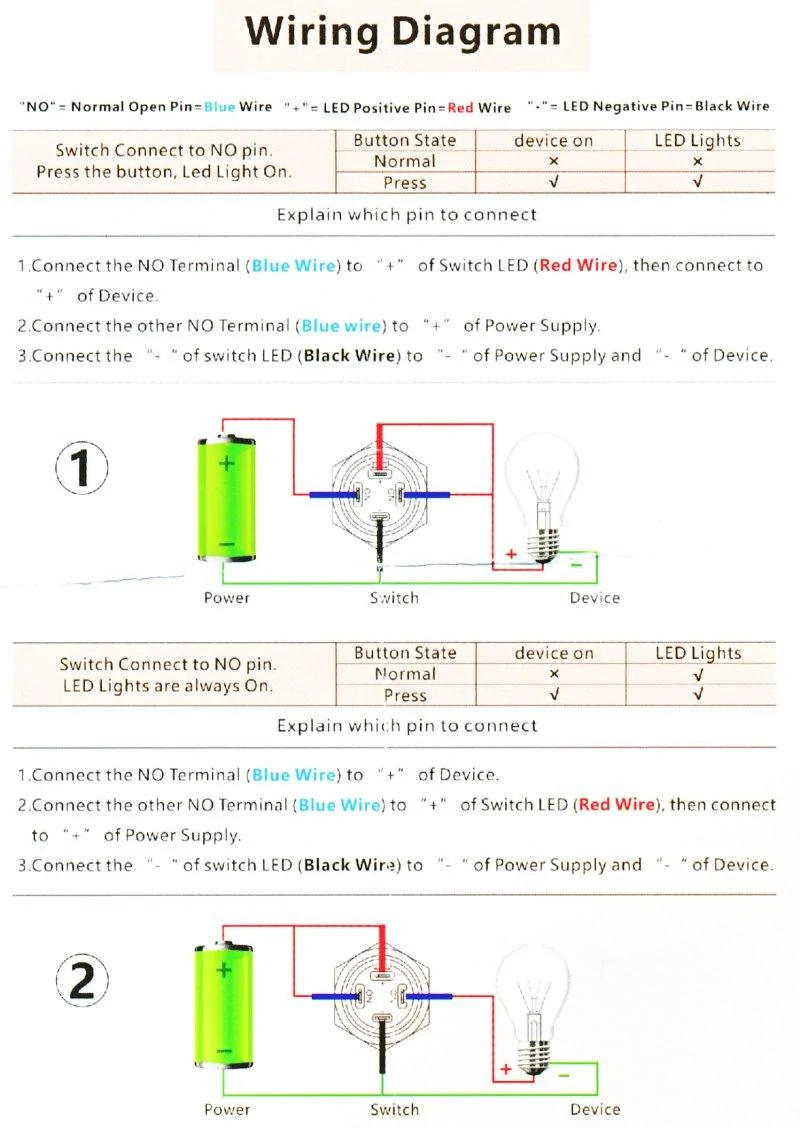

I got this same switch to swap out the one from DD, but am confused on which leads it goes on - i assume the ground chassis goes to common, and then the others are NO and + ?
If it's the same switch ground is common. I attached mine to a bolt above the brake pedal. The switched leads go back to the module and the LED ring positive can go either to the always on 12 volts so it's always illuminated or to the switched positive wire so it's only on when you have the fogs on.
thank you. Looks like mine is slightly different - but I think its mostly the same, attach the ground chassis wire to common, and the other two one goes to positive and the other to NO depending on if I want the LED ring to be on all the time - did I understand correctly?

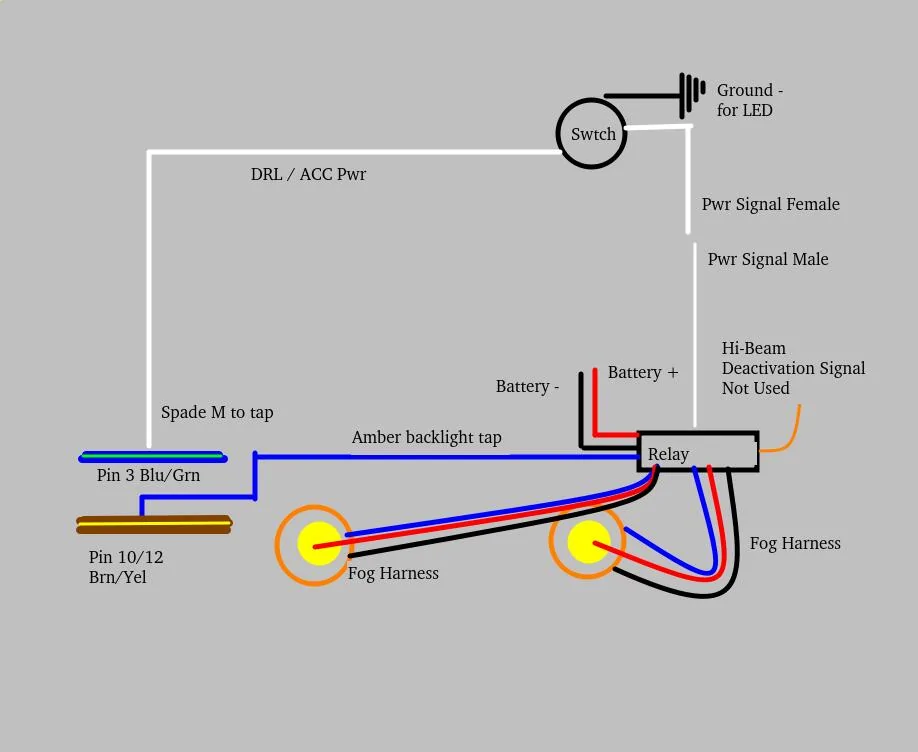

I used a dremel and then a microfiber cloth to debur...breaks off the remains easily. You have to remove the front fascia from the truck...if you already installed fender flares it will be somewhat of a hazzle. DD does include wires with their relay block...power with a fuse, ground, backlit amber wire, foglight activation wire and a deactivation wire - incase you really want them off with your highs.
https://www.mavericktruckclub.com/forum/threads/foglights-installed-diode-dynamics.42427/
This link provides more info and there is a video on their site that shows how to install. I wired my up differently but to each his own. I would have easily paid Ford $300 for these fogs.
My wiring...
I plan on doing very similar to this and following your wiring diagram.
Please advise why you felt the need to add resistors to the switch LEDs.
The Maverick is extremely sensitive to current draw for the turn signals. After the latest software updates it became even more sensitive to the current draws for the turn singals and other leds on the truck. Without placing the correct resistances according to my diagram you will get hyperflashing when you turn your turn signal on. With these resistors in place as per my diagram...wherever it is on this forum, you will stop the hyperflashing of the turn signal and it will blink at the same speed as it normally does. You can try installing without the resistors first but I suspect it will hyperflash on you. Mine was Lariat. Those resistors GET HOT if the blinkers are on for even short durations so place the resistors up in a safe area. I mounted them to an aluminum base and placed on top the strut towers with spacers to allow for air flow. I did this more than a year ago and have had ZERO issues with them to this day. Everyone says it is easy to spot my truck now since it has distinctive leds on visible during the day.
Very much appreciated your clear answer as I also know that resistors can get very hot.. I googled before asking your advise and it went down a rabbit hole of Arduino and GPIO. I know what those words mean but not much beyond that. Your diagram is here on this thread. Now I know what to look for. I thought the diode dynamics only tapped into the DRLs but I will study your wiring layout more closely as there are options. Tapping the DD backlights into the signal indicators is an intriguing idea.

Ford Maverick Diode Dynamics Fog Lights Installed NewWiringDiagram
Received the Diode Dynamics Elite Fog yesterday.
My interpretation of the vendor install instructions.
There must be a good reason but it seems really weird that the instructions consistently tap into the passenger side Ford harness despite the power, relay, and switch being on the driver side.
I plan to NOT follow these perfectly and tap the amber backlights as AUX turn signals if it will let me without hyper-flashing. And no vampire taps. I learned my lesson as a teenager. I will try something close to pins.

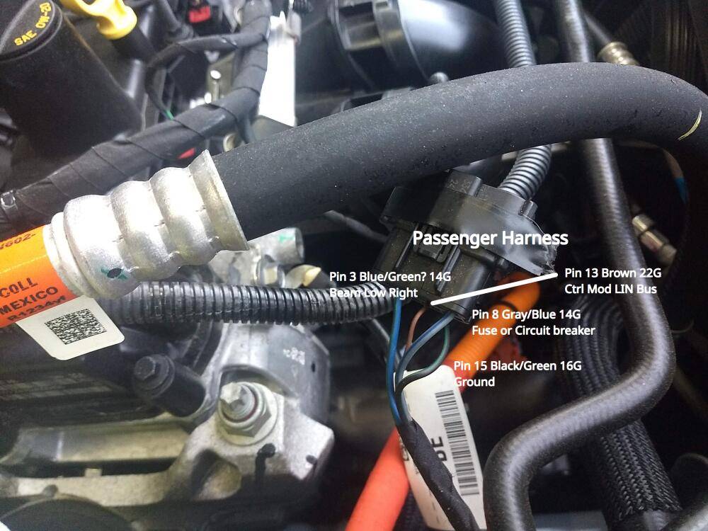

Bummer. I was hoping to bench test with a 9V and I could not even get the backlight to flash, didnt try the full-power.
Weird this thread shows a pinout with 16 pins 2x8 while the Diode Dynamics instructions talk about a 12 pin, and using pin 10 that the pinout does not show.
My mistake. The 16 pin goes to the Headlamp. There is a separate I guess 12 pin down by the running lamps that is only accessible once the fender liner has been removed.
Unclear why they opted to tap here. I would guess that they also recognize that vampires are NOT great but less bad happens down here. Still have not found the 12 pin connector in the schematic PDF.
12 July EDIT:
PIN 3 Blue/Green and PIN 10 Brown Yellow are on different Molex connectors. Blue/Green is to headlamp. Brown/Yellow is behind the splash gaurd and leads to bumper. Blue Green is an "activation wire" to indicate that low beams are ON before allowing the switch to turn on fogs. Brown/Yellow is a power source for the fog-backlights as running lights.

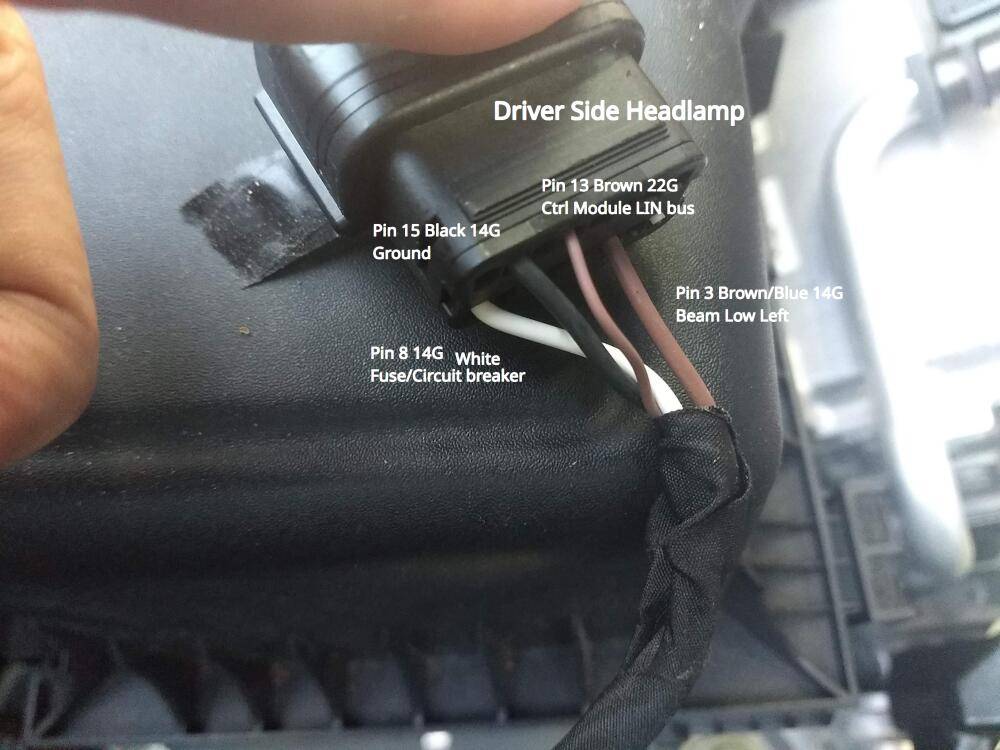

Ford Maverick Diode Dynamics Fog Lights Installed PassengerHeadlightPinoutSmaller
Confirmed that it is a 16 pin molex connector for the headlamp, 12 pin is behind the fender liner that is not obvious.
I plan to tin some wire to make it stiff enough to at least test and will likely just ziptie the insulation on the pin to the harness and declare victory. Fog lights are not a critically reliable feature to me.
Because I am special kind of person, I think I will actually tie all of this stuff on the driver side.
Ford Maverick Diode Dynamics Fog Lights Installed DriverHeadlightPinOutSmaller
