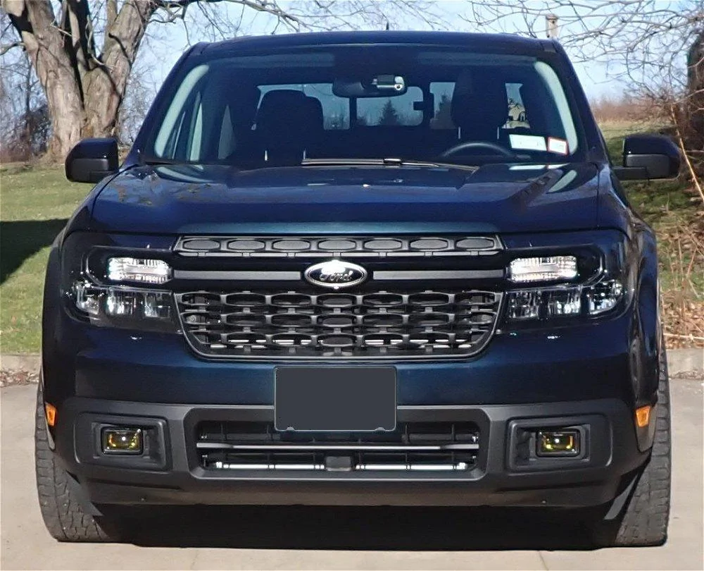

Finally, 2 x 2024 maverick hybrids in Atlas Blue

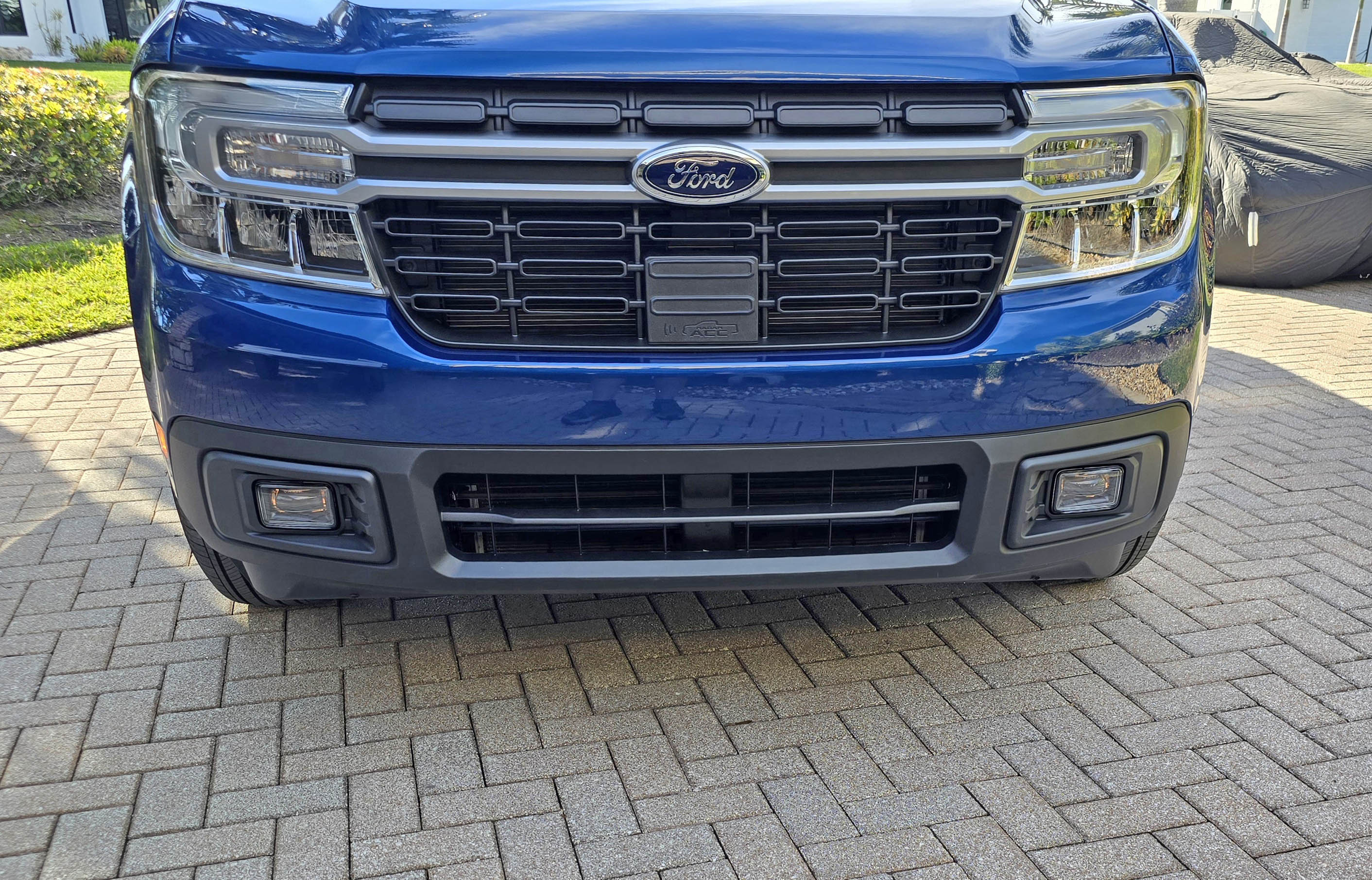

They may look small but produce quit a bit of useable light at night....esp if you are watching out for deer on the sides.
We had Diode Dynamics amber fogs on our Subaru CrossTrek and they were absolutely awesome for spotting deer along the side of the road.
Will definitely be getting them for the Maverick, you did a very nice installation.

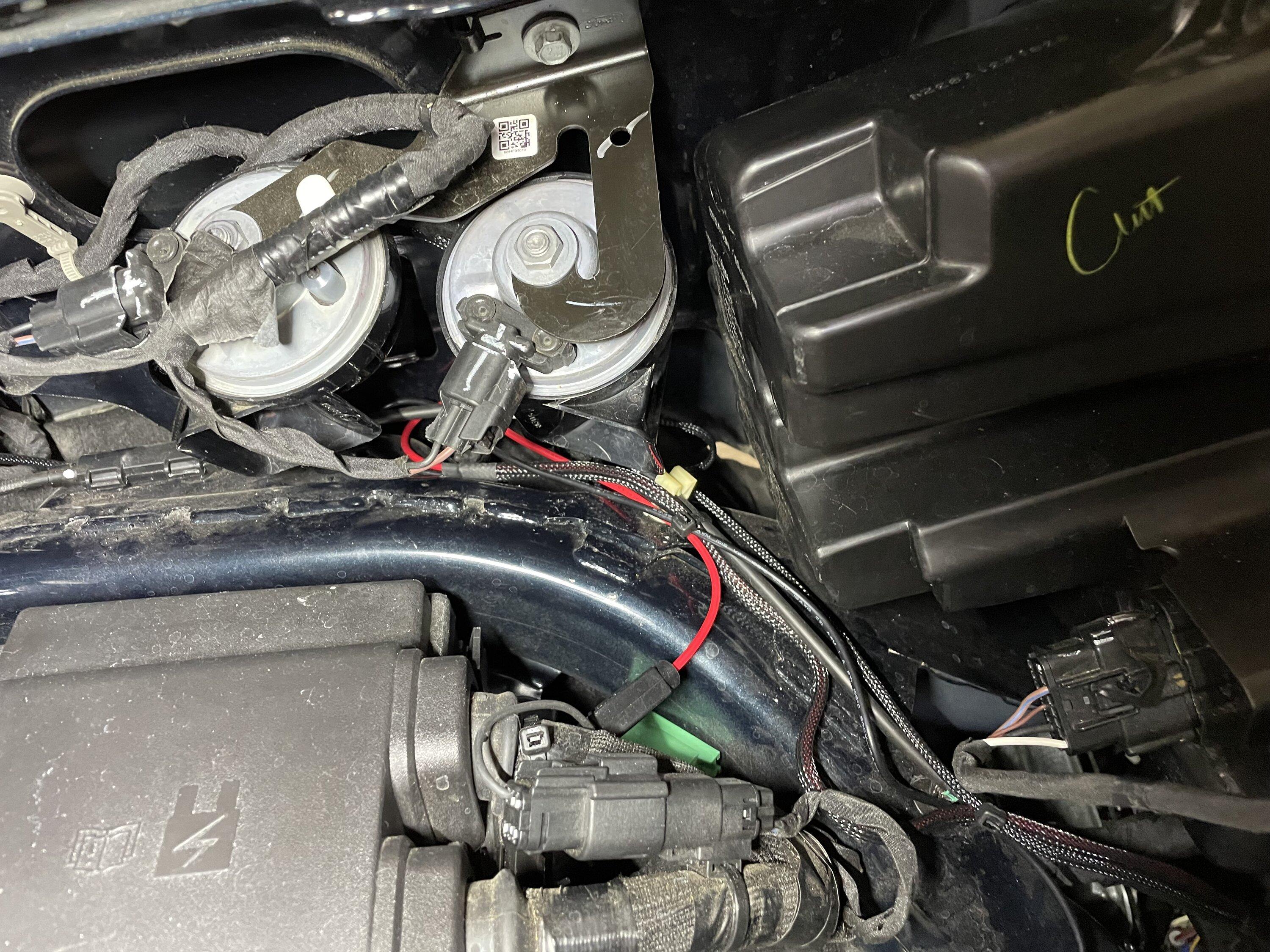

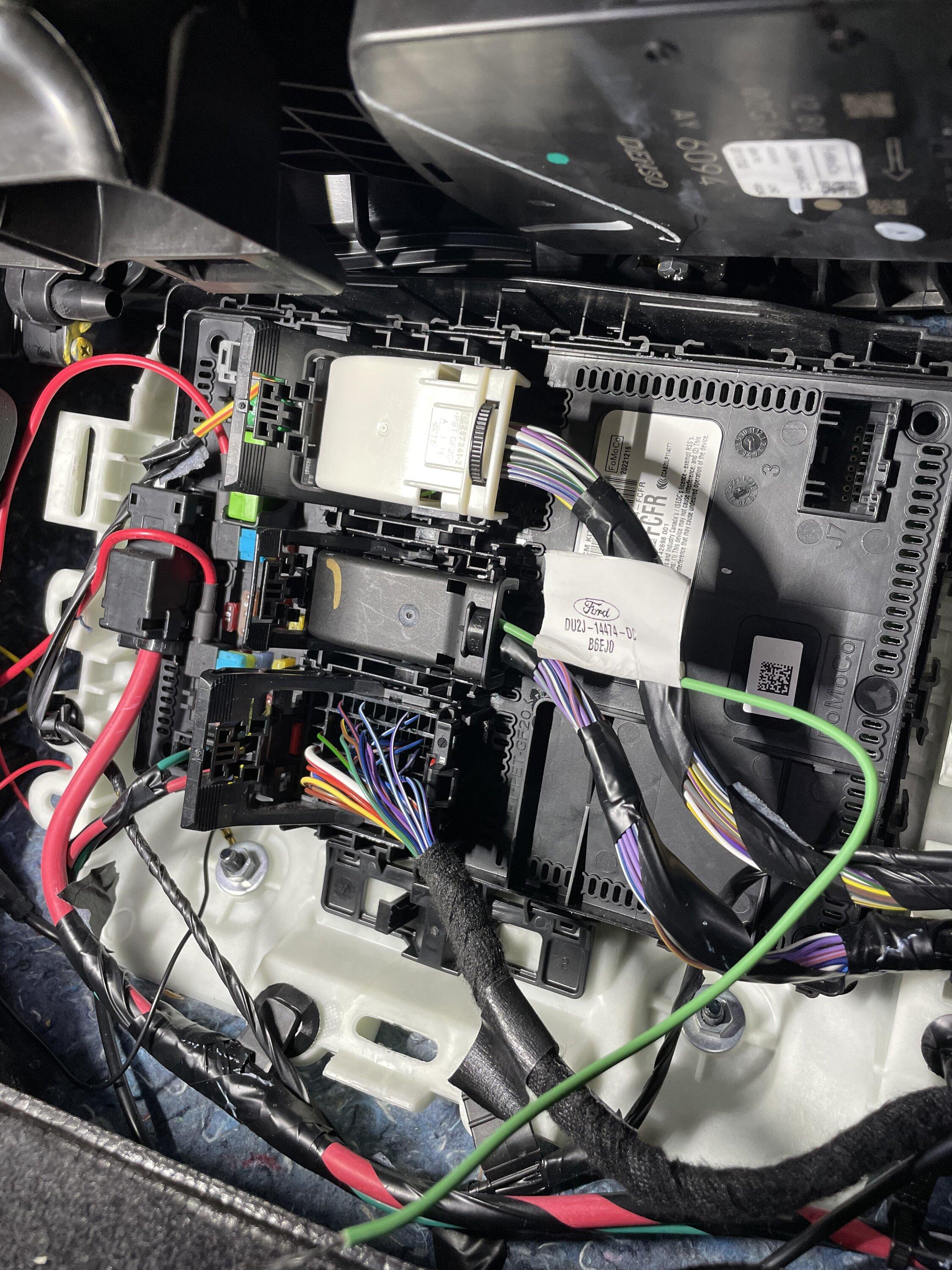

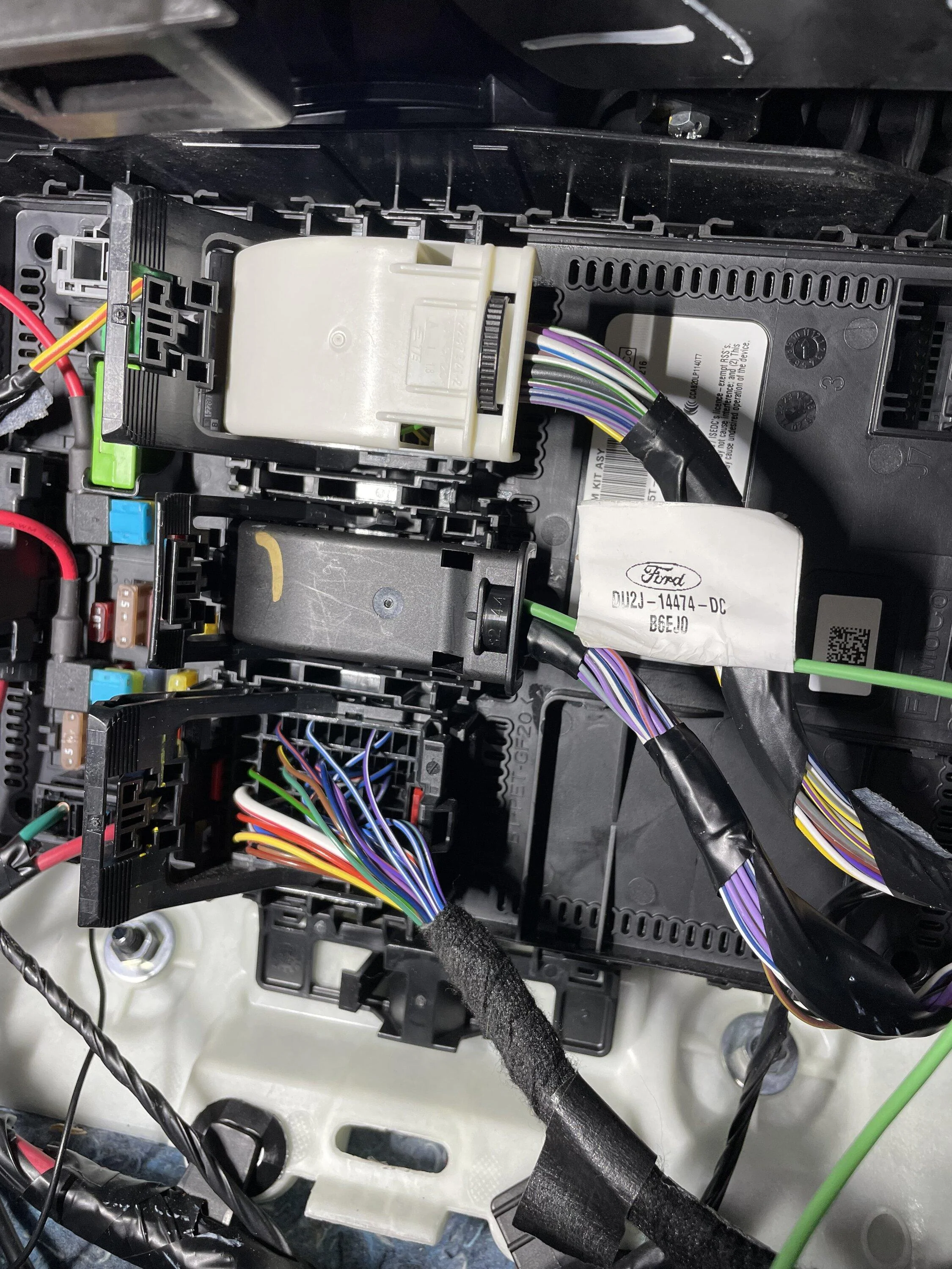

I installed the DD fog light kit and used the f150 hybrid headlight switch and mine turn off with high beams on , used the DD wiring harness but didn’t connect into the headlights ran a wire from the bcm to the switch wire on the DD harness works great just like factory.
Share any details or pictures? Did you still use the DD relay and just run the trigger to the BCM or bypass it and go straight form the lights to the BCM? How did you route the wiring? Did you buy a pin/wire setup from Ford to connect to the BCM?
Going to be doing the same thing shortly.

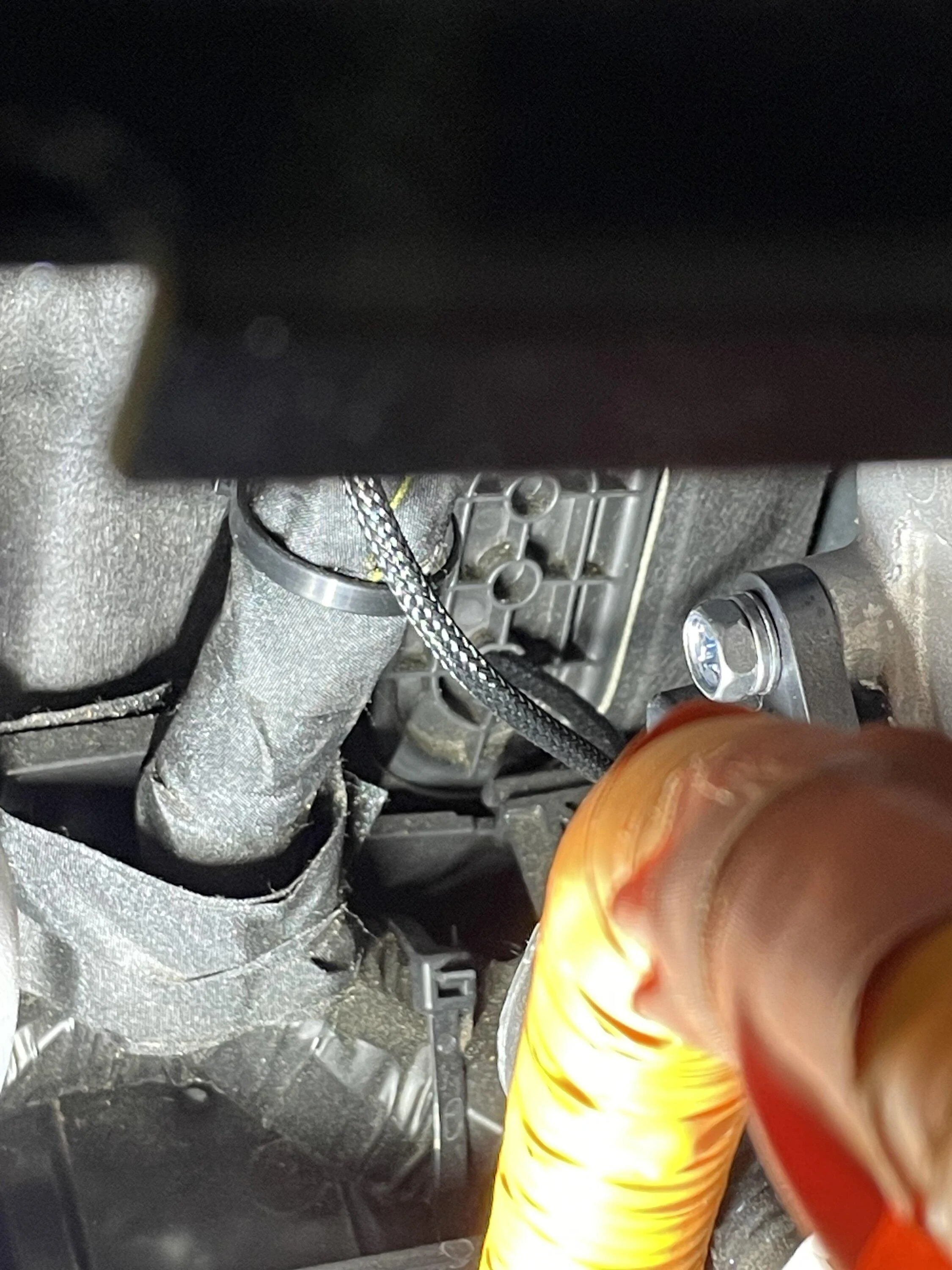

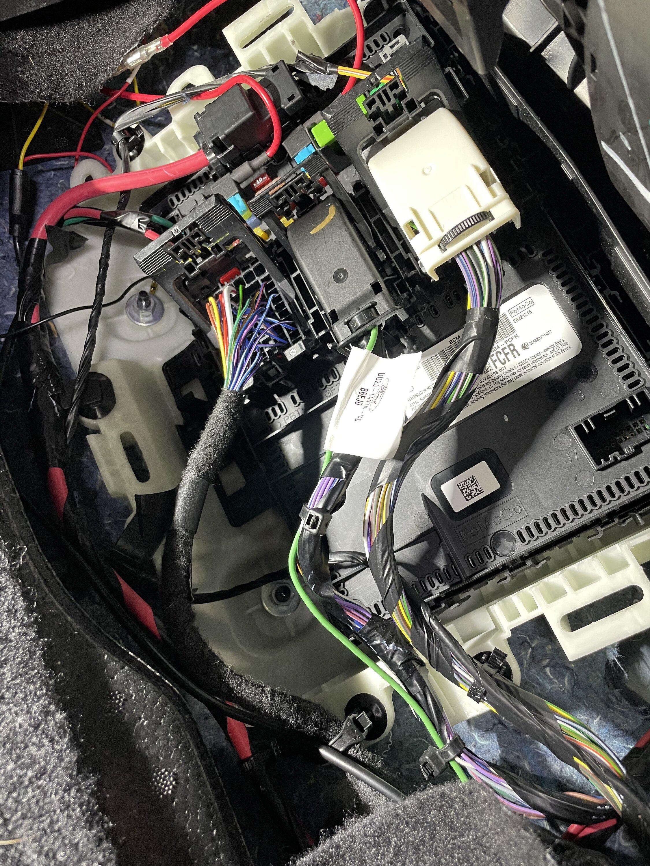

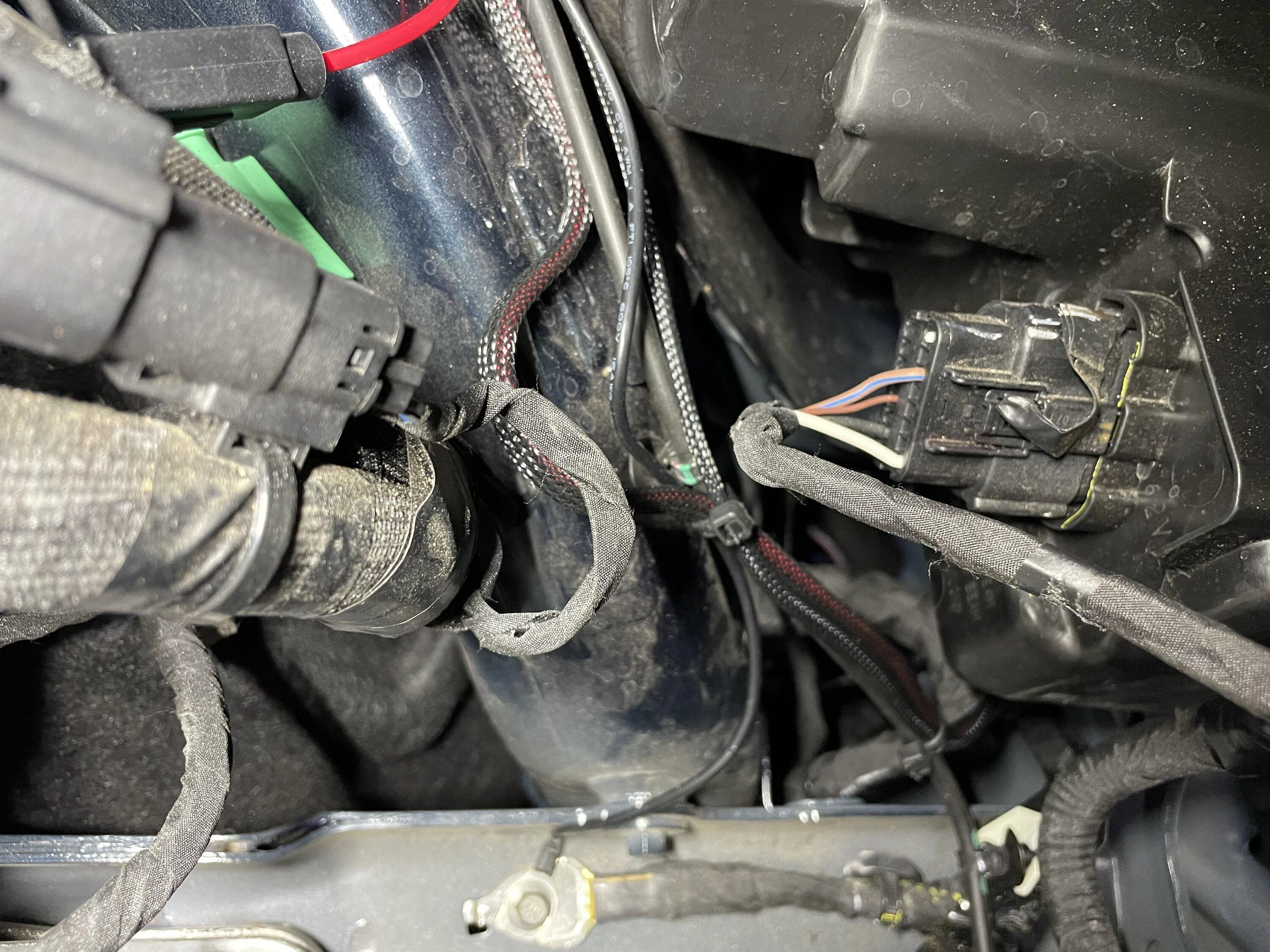

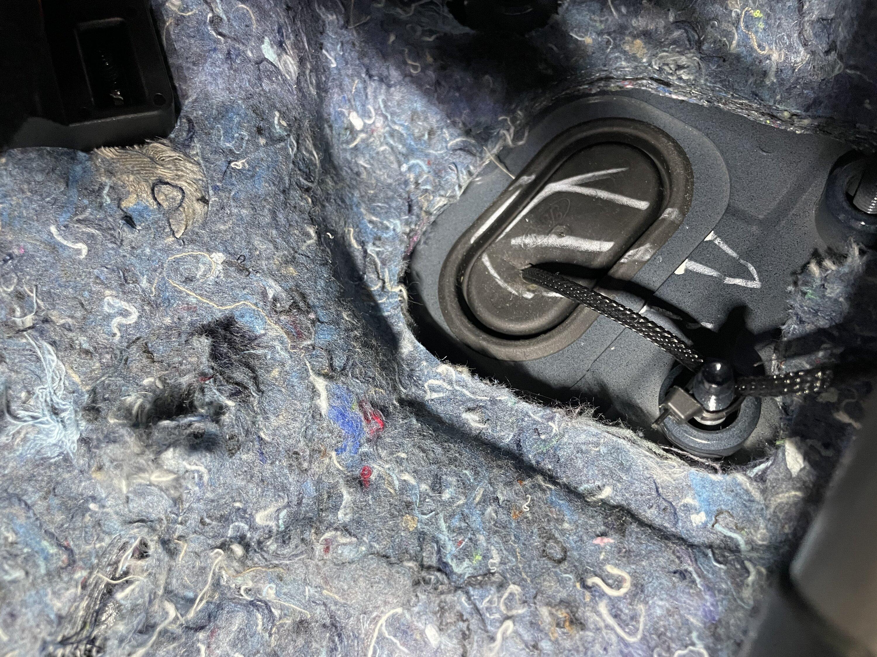

I did a write up last month when I did mine with pictures and the forscan , I wired everything up just like DD shows on the install video, except using their switch I bought a F150 hybrid headlight switch and ran a wire with the pin / wire setup from ford , I ran the wire from bcm over to drivers side and through the firewall to the DD harness trigger wire using their complete harness except their switch . There is two bcm connections but I only used #6 pin and plus I wanted to have the amber lights when not using the fog lights . Not hard to do just time consuming so my wires are all hidden. I did use one switch wire from DD harness to connect at the bcm since it was already wrapped and protected and yes I used the DD relay.
