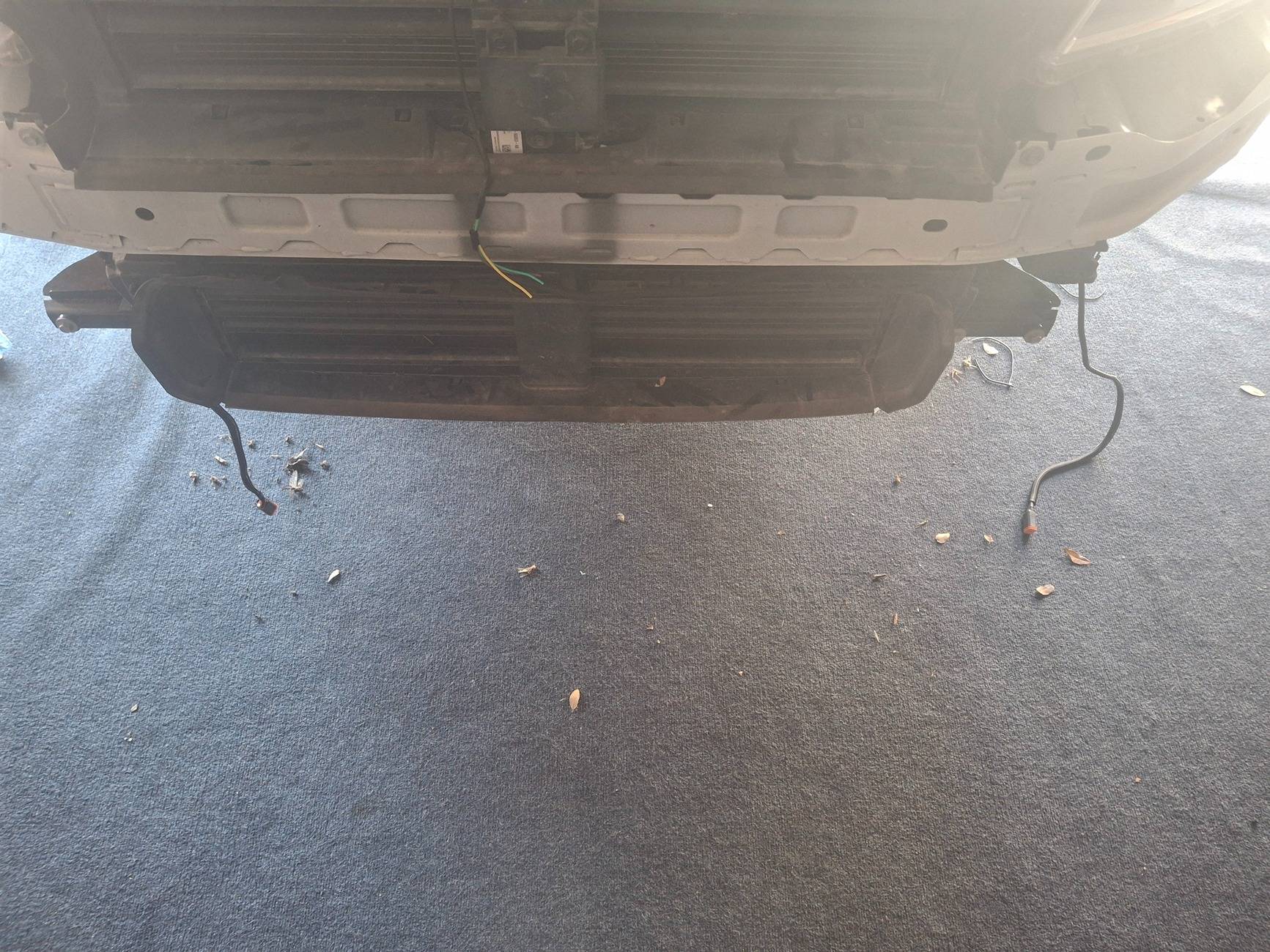

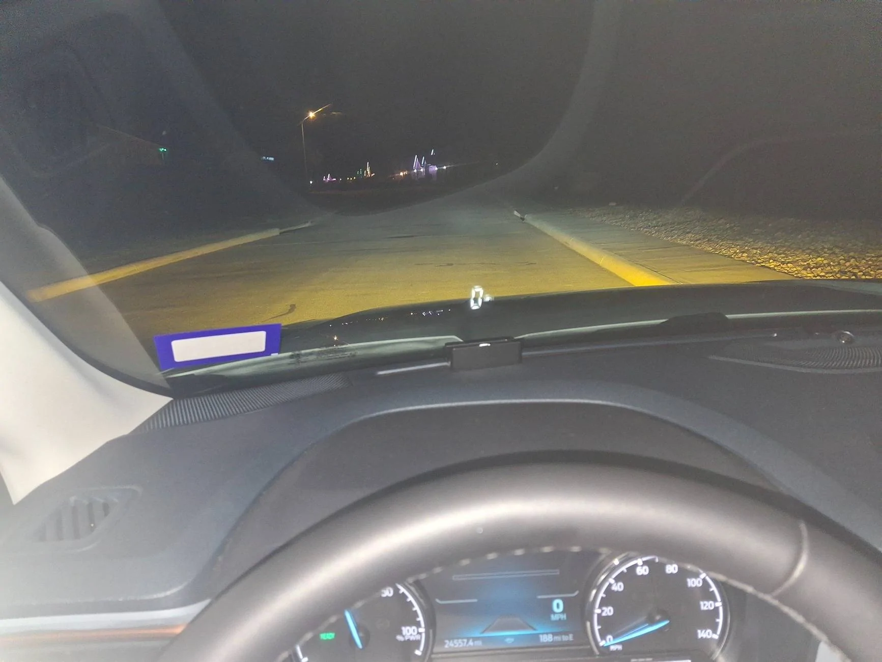

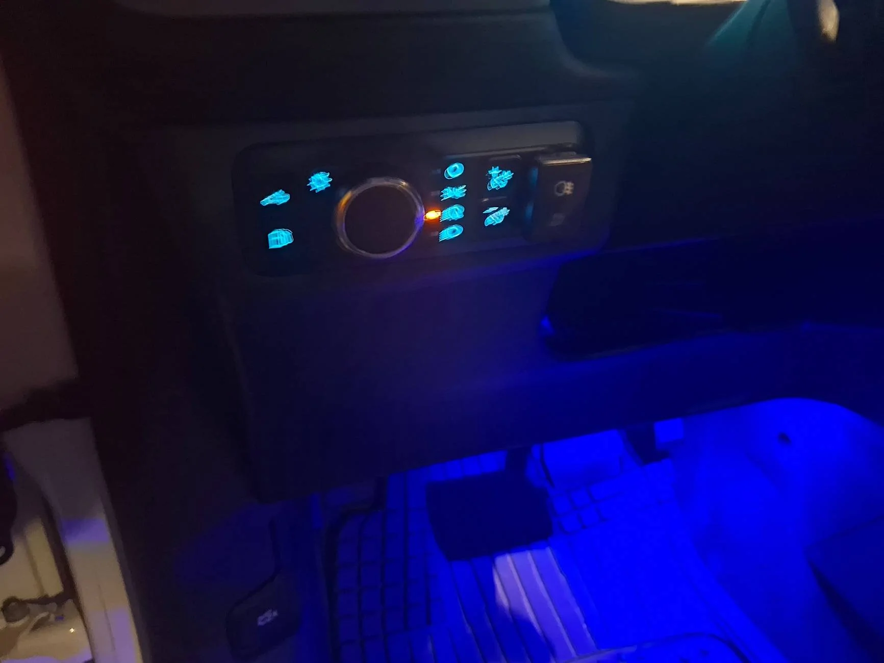

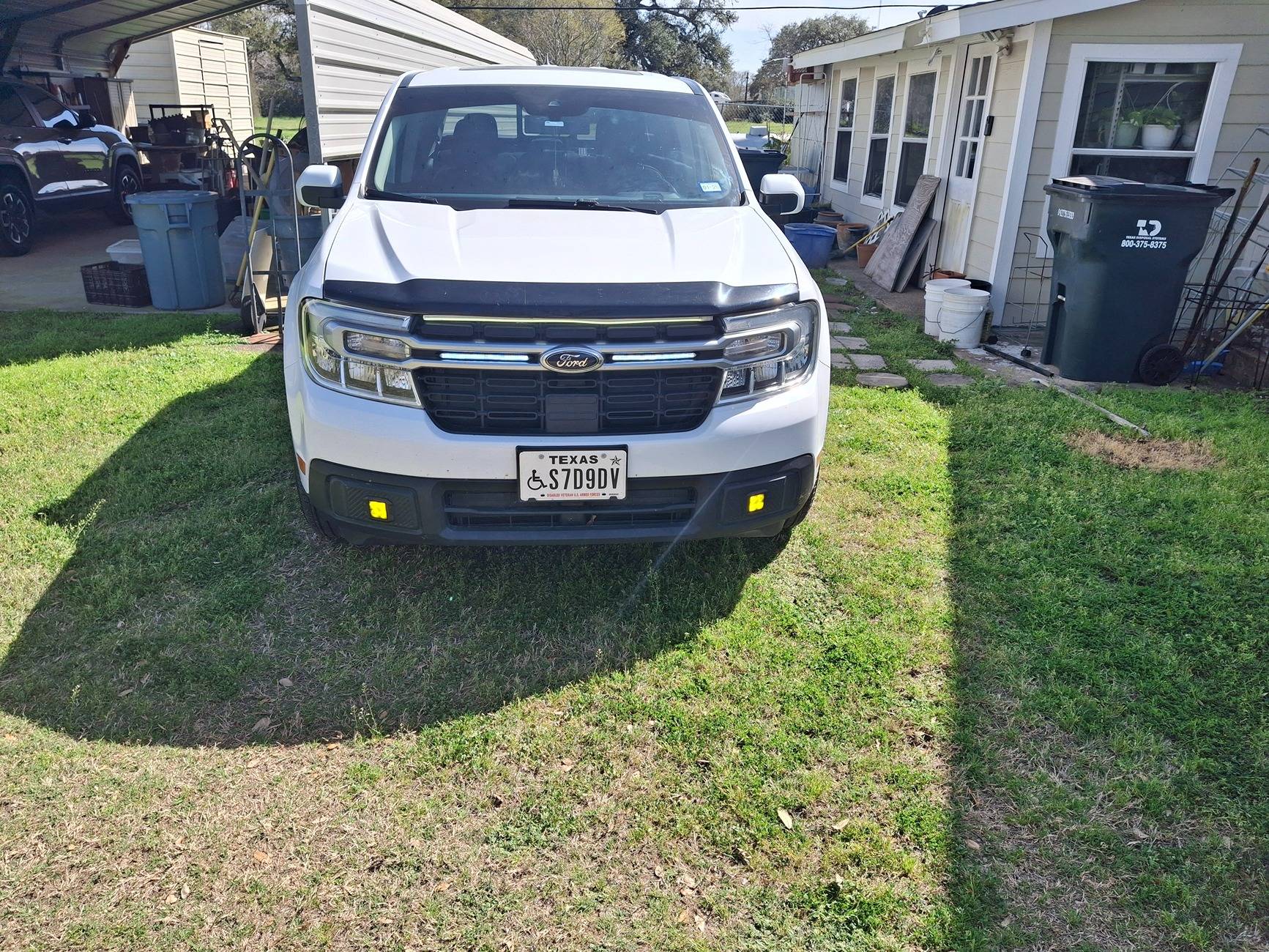

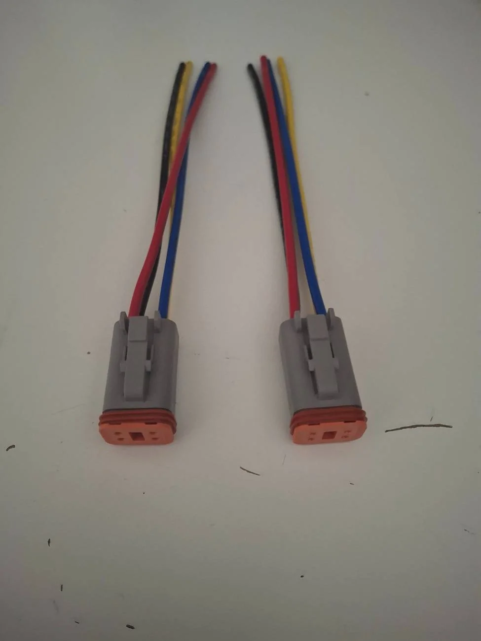

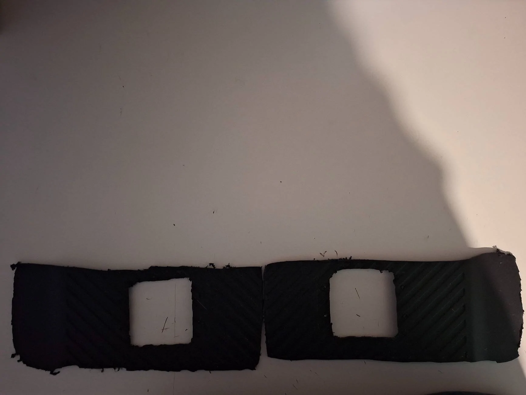

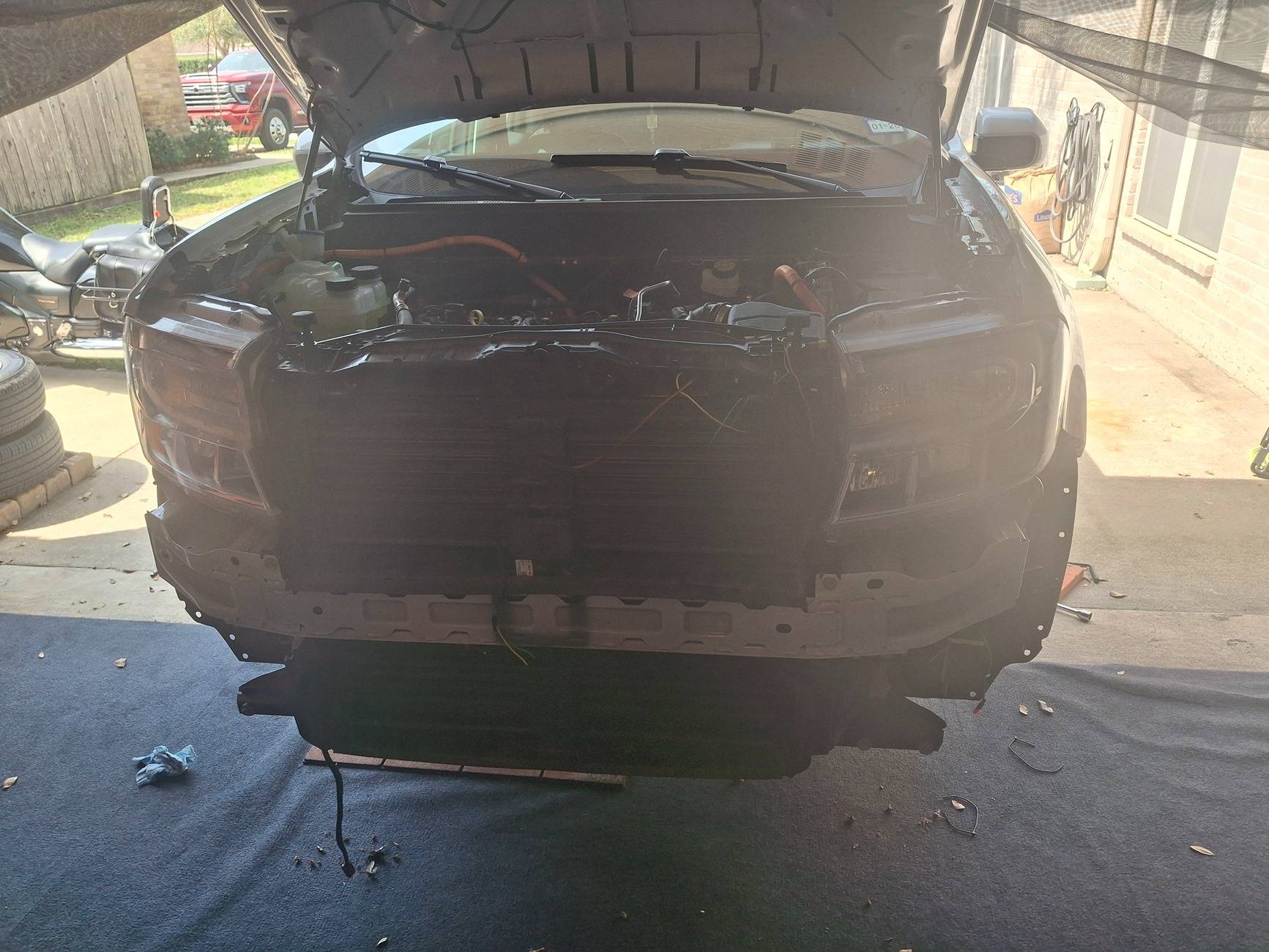

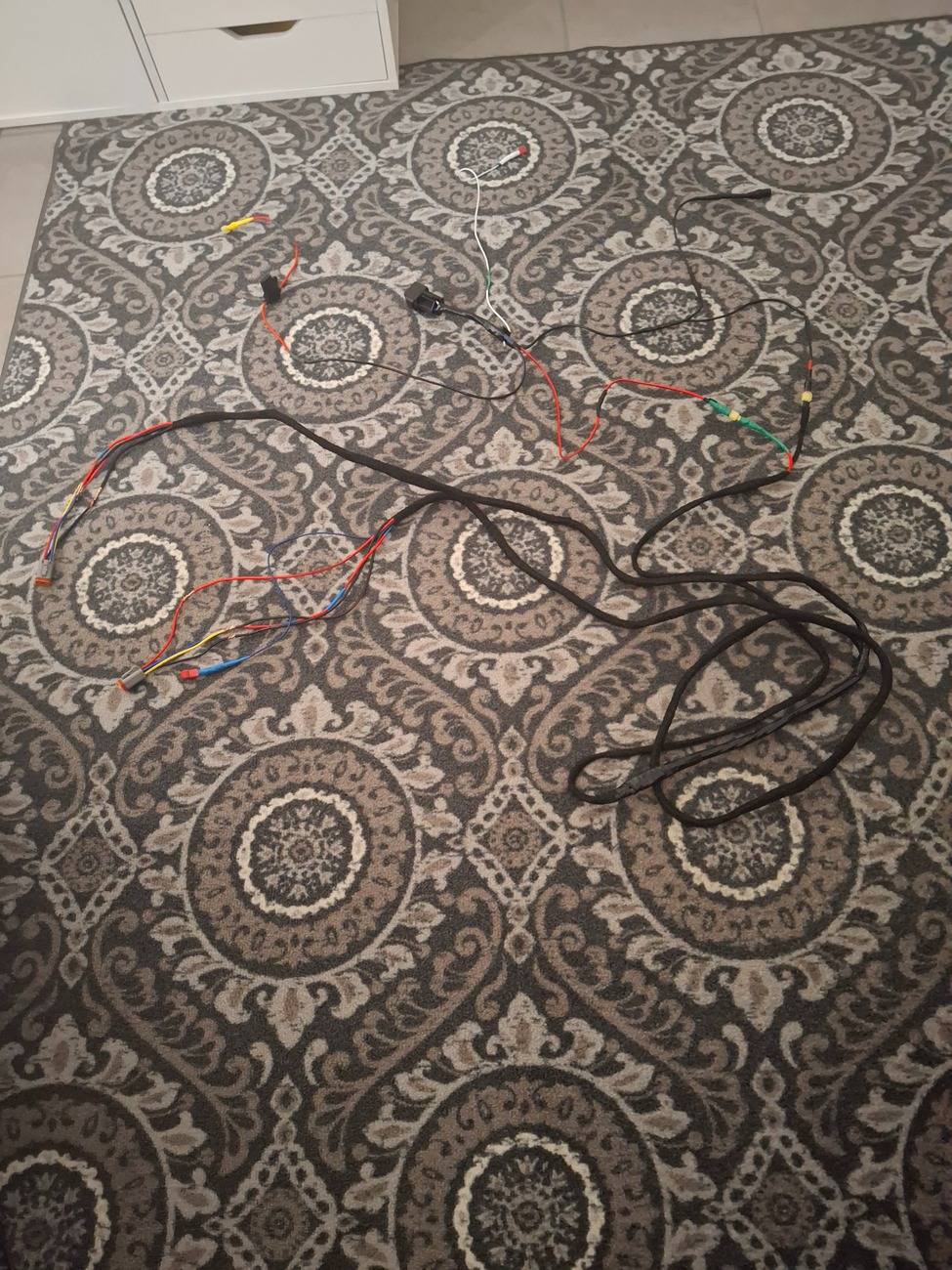

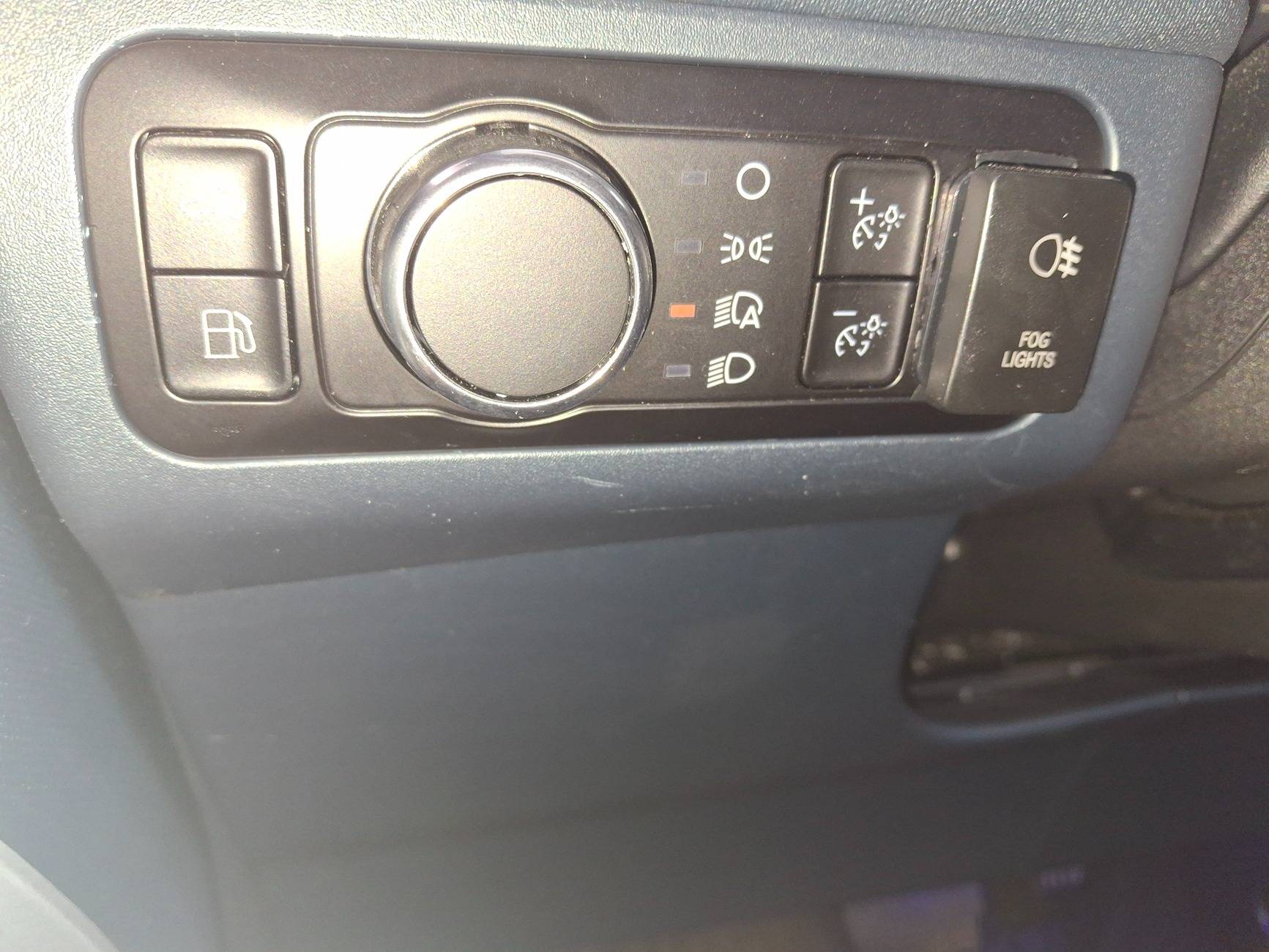

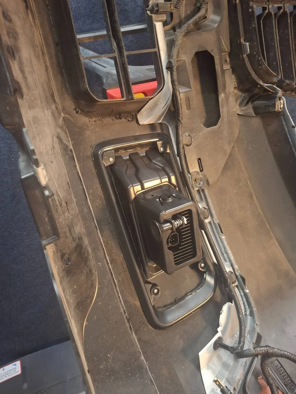

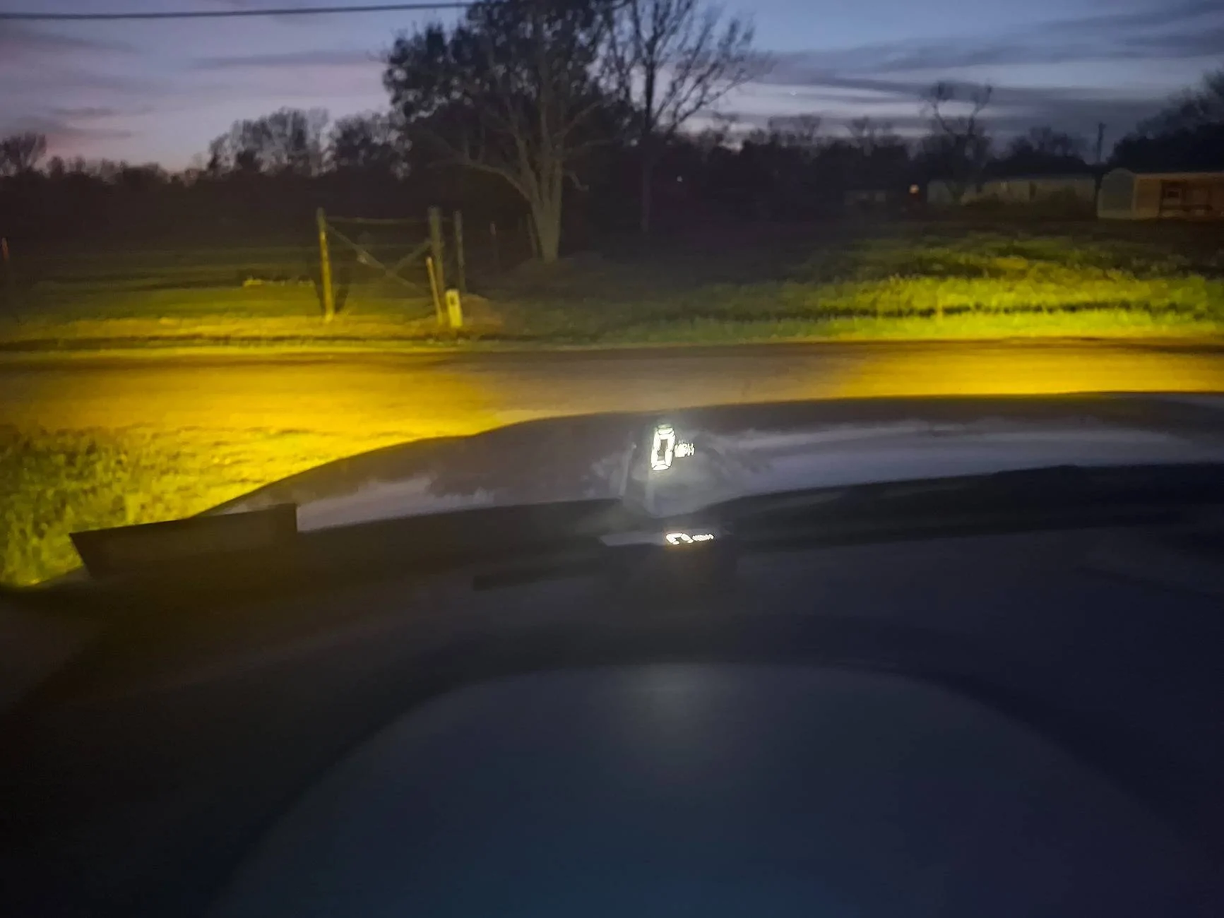

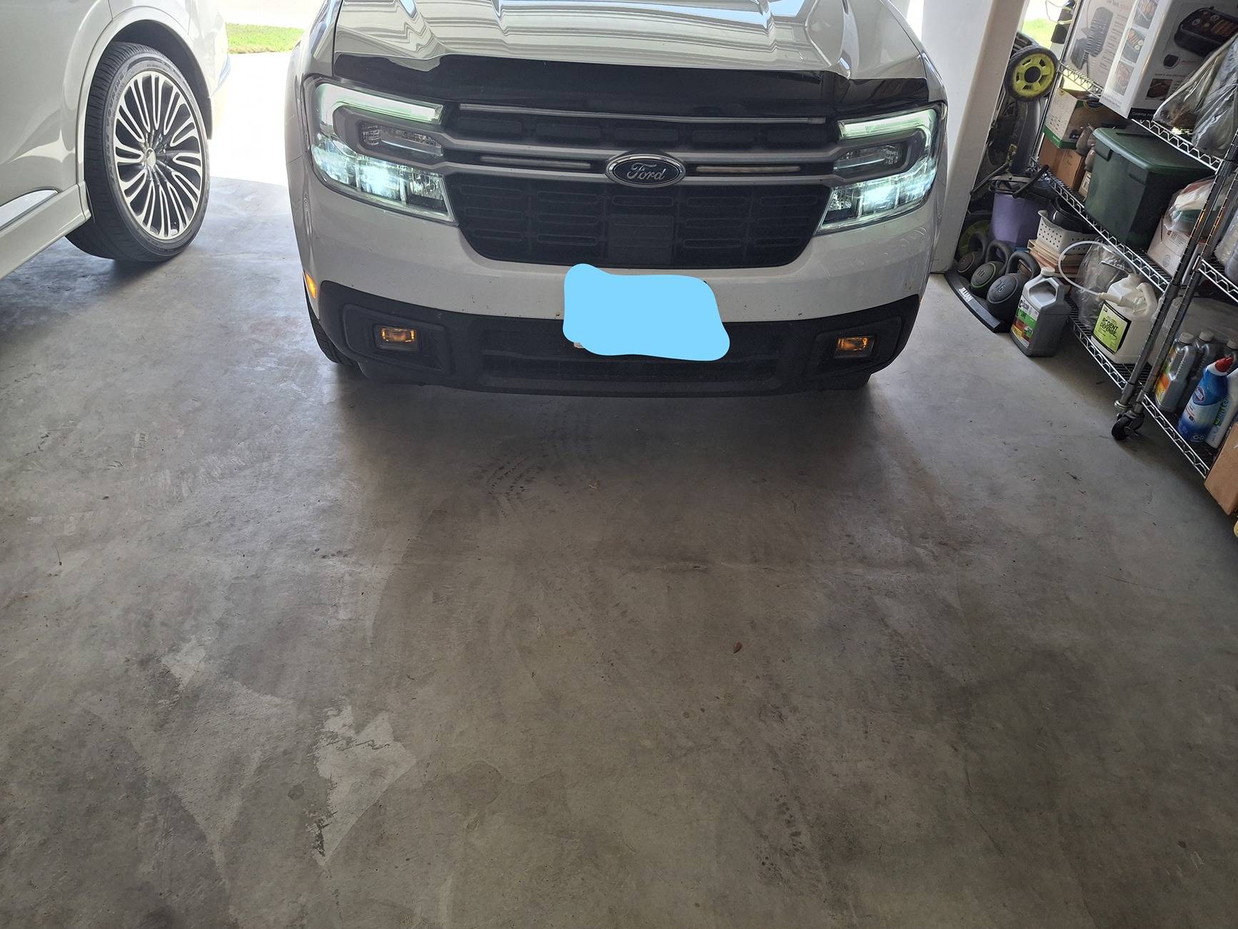

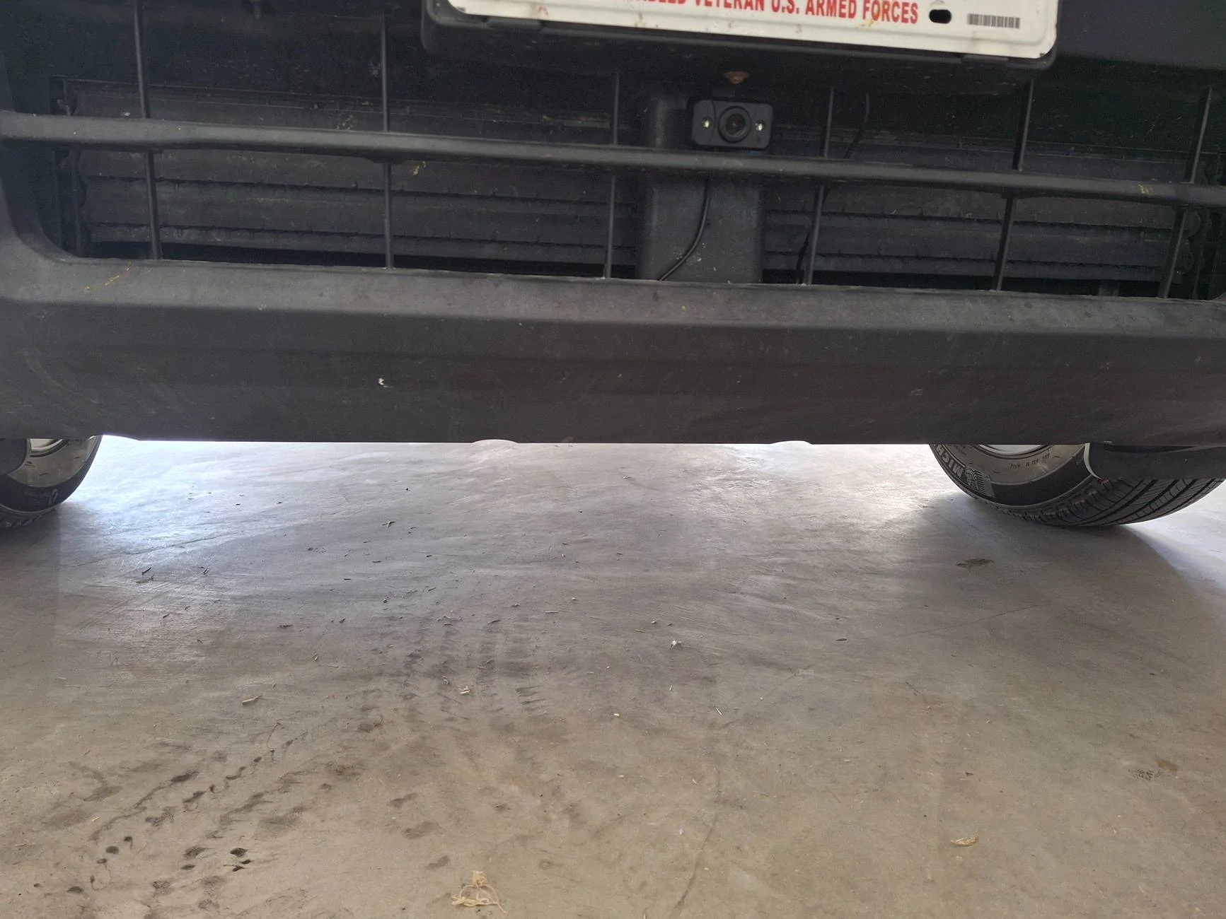

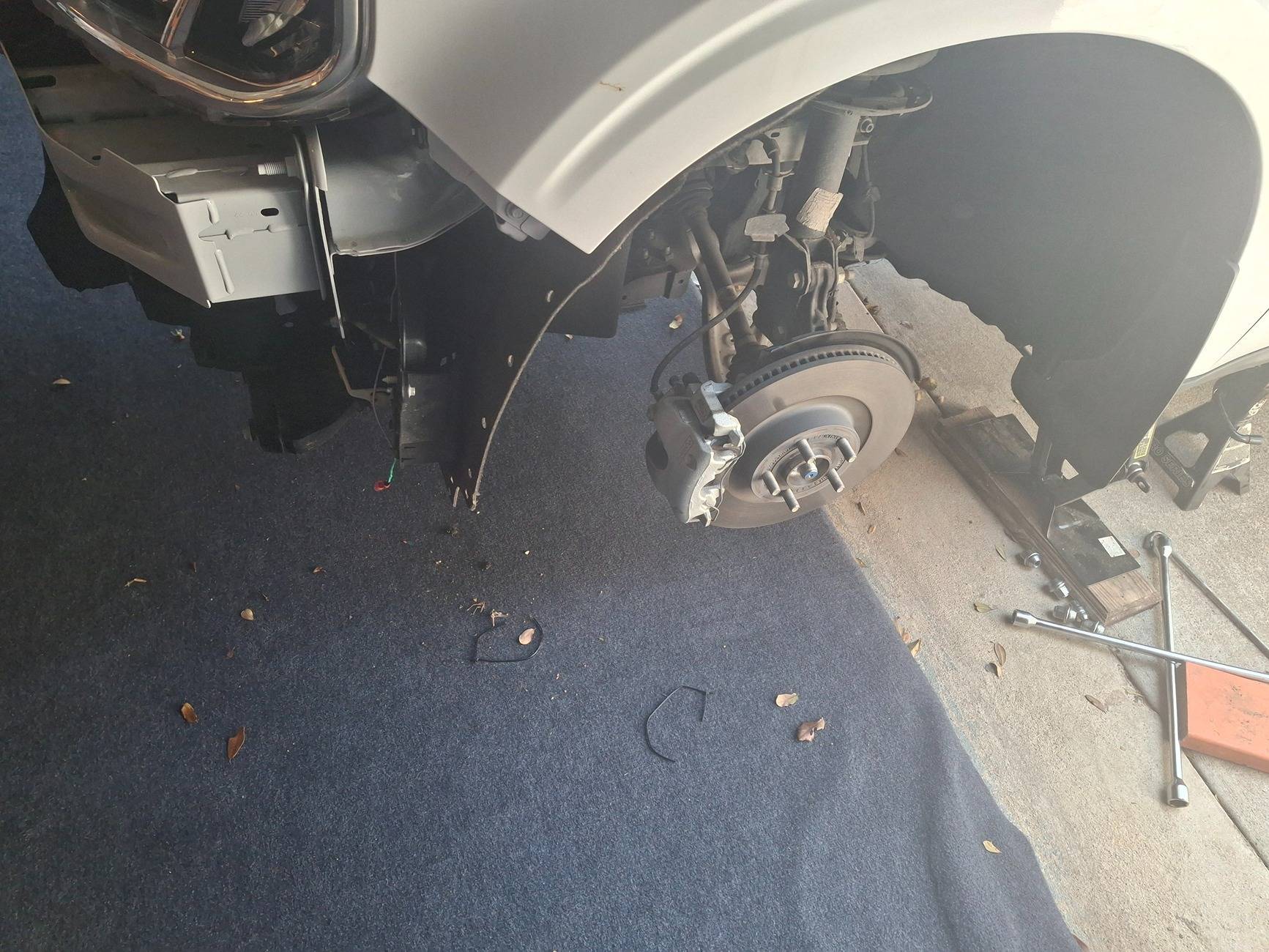

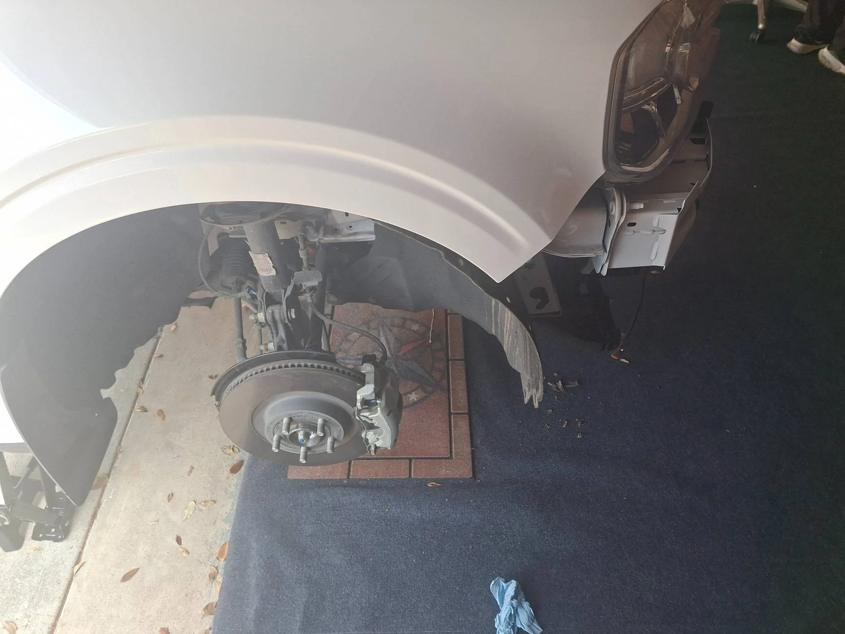

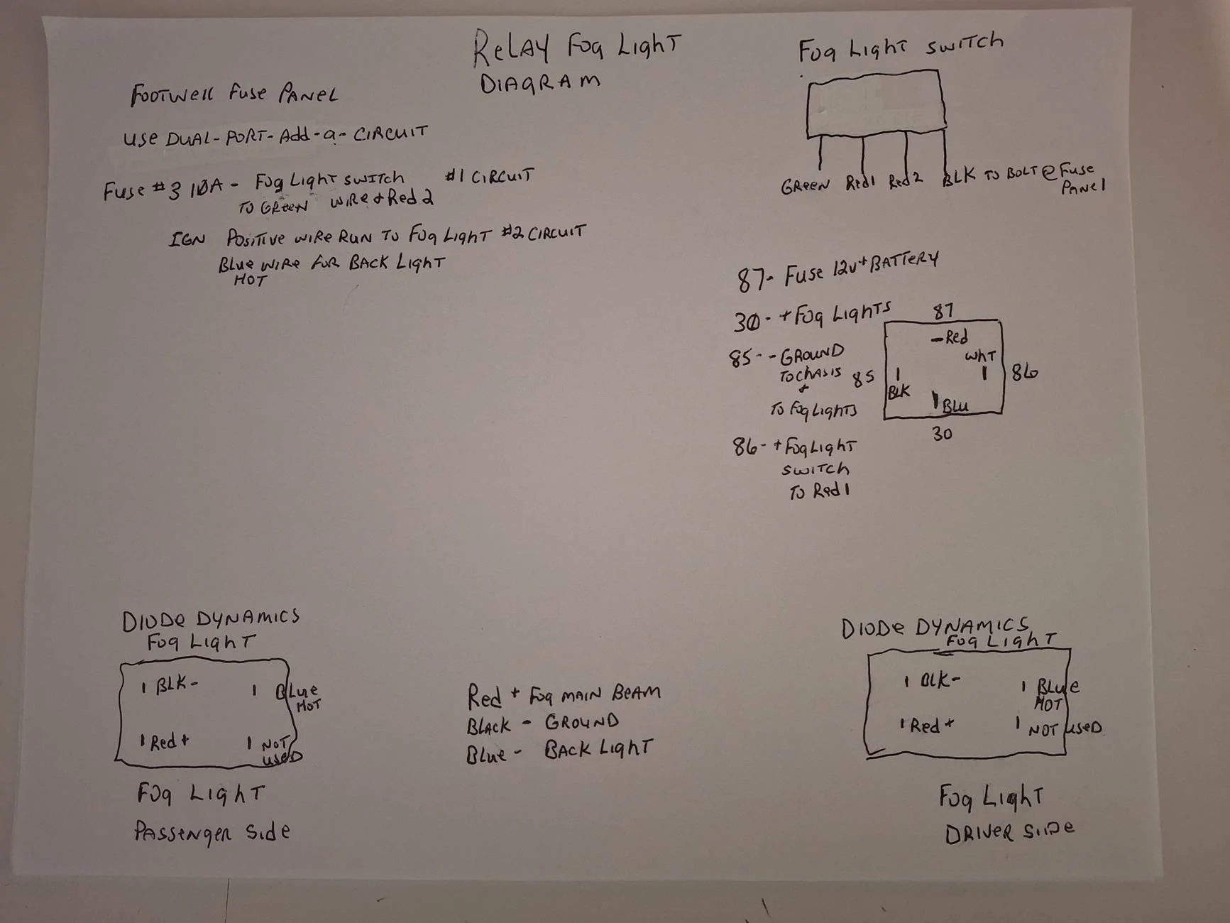

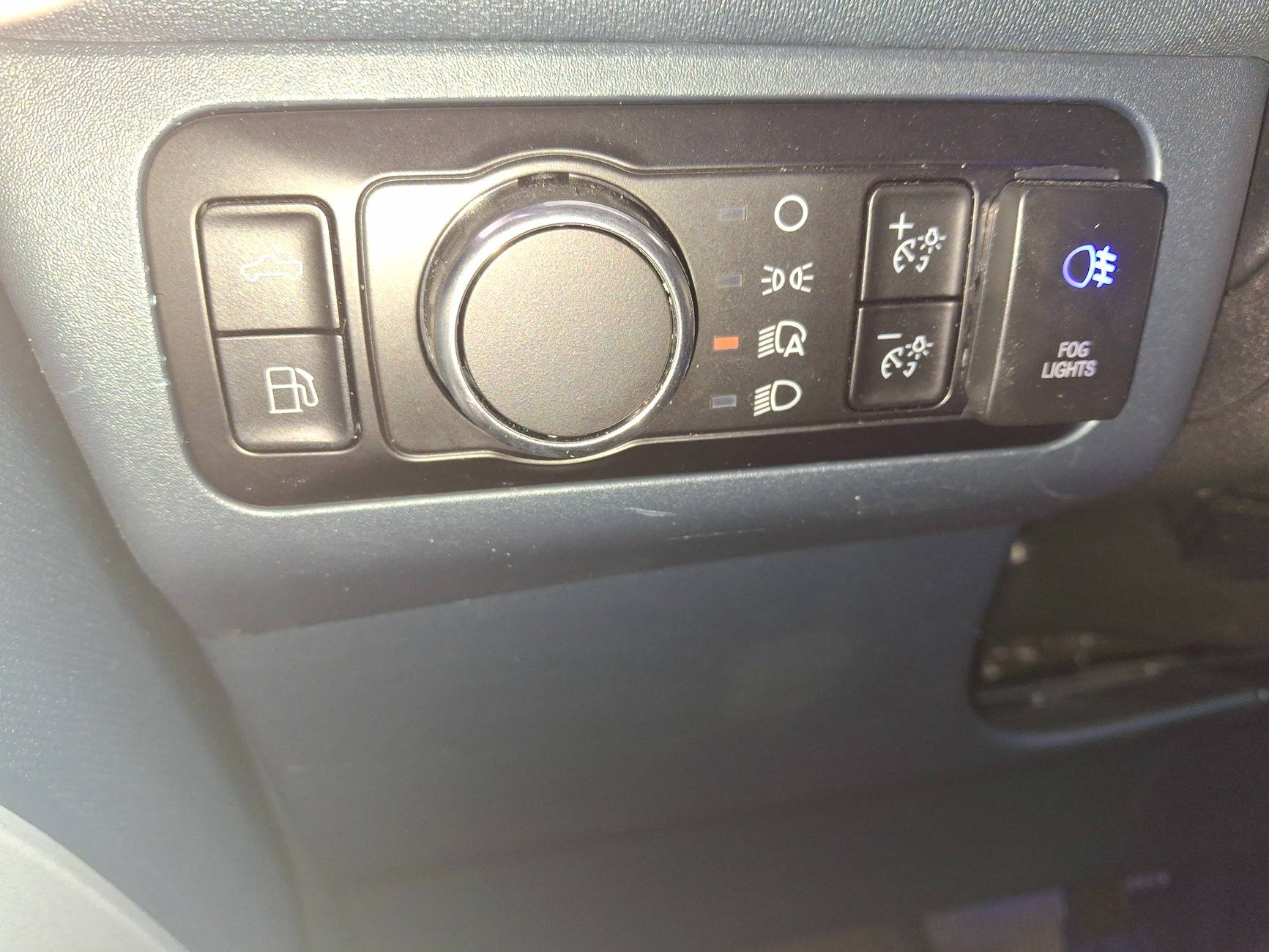

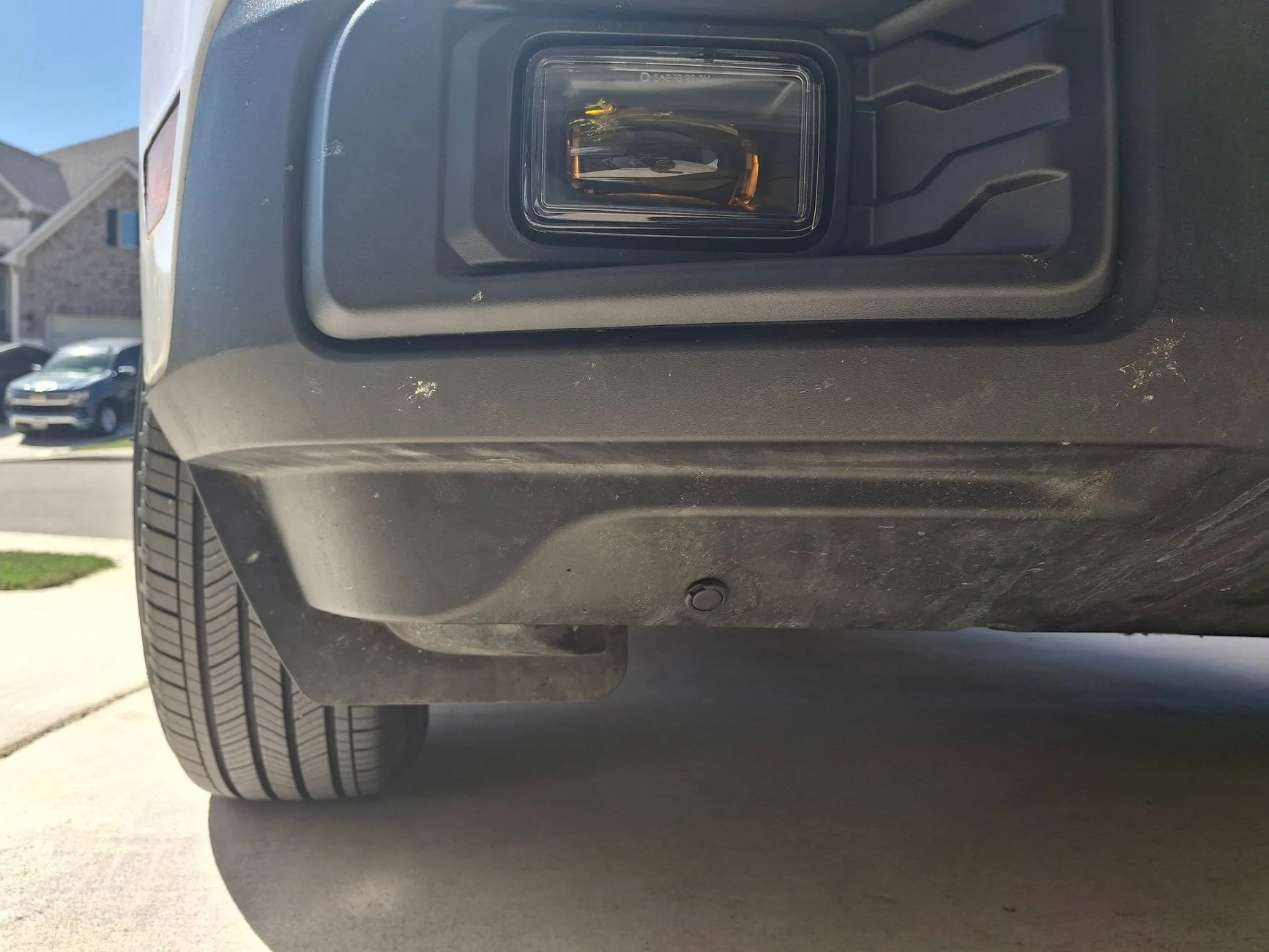

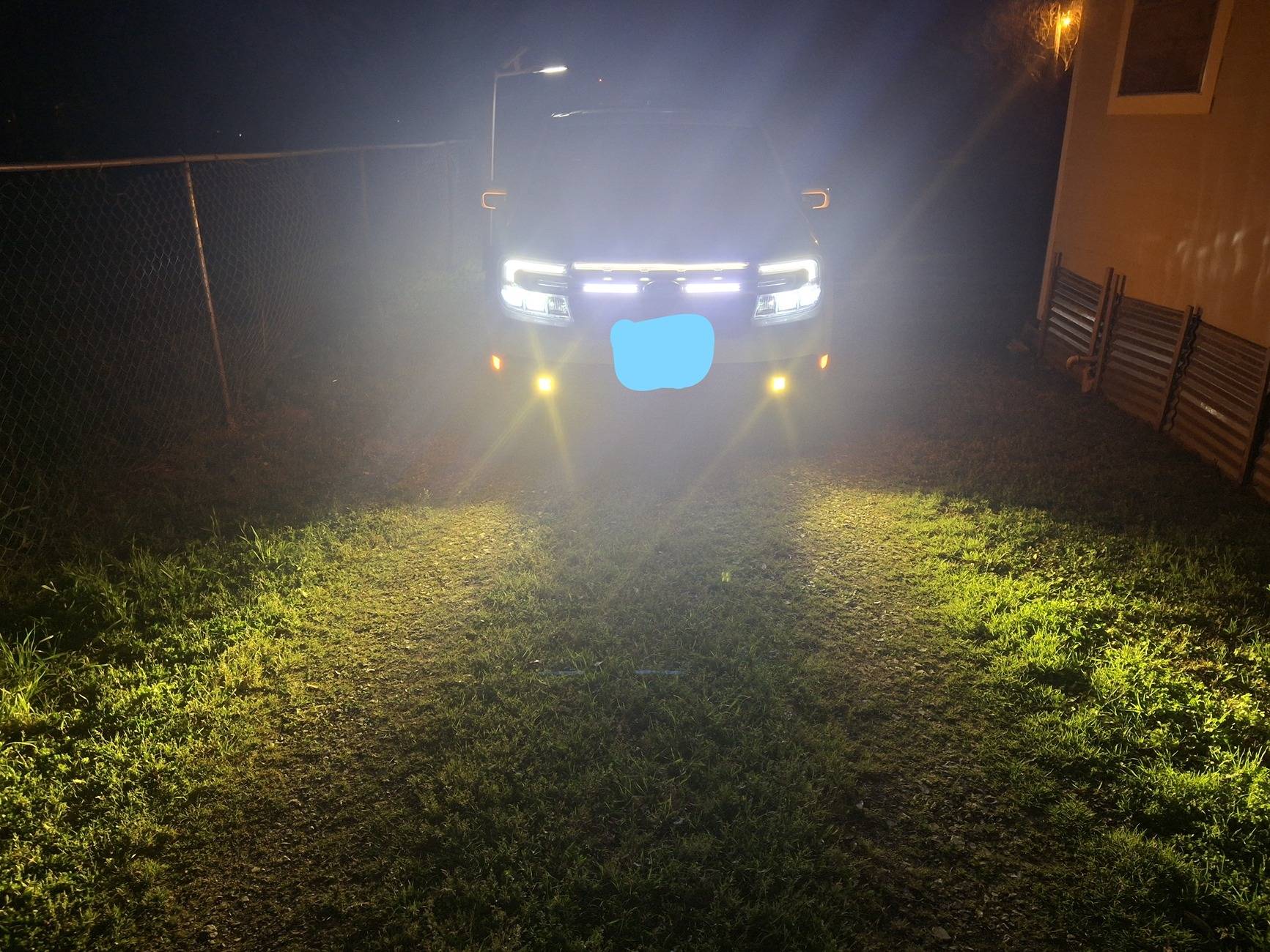

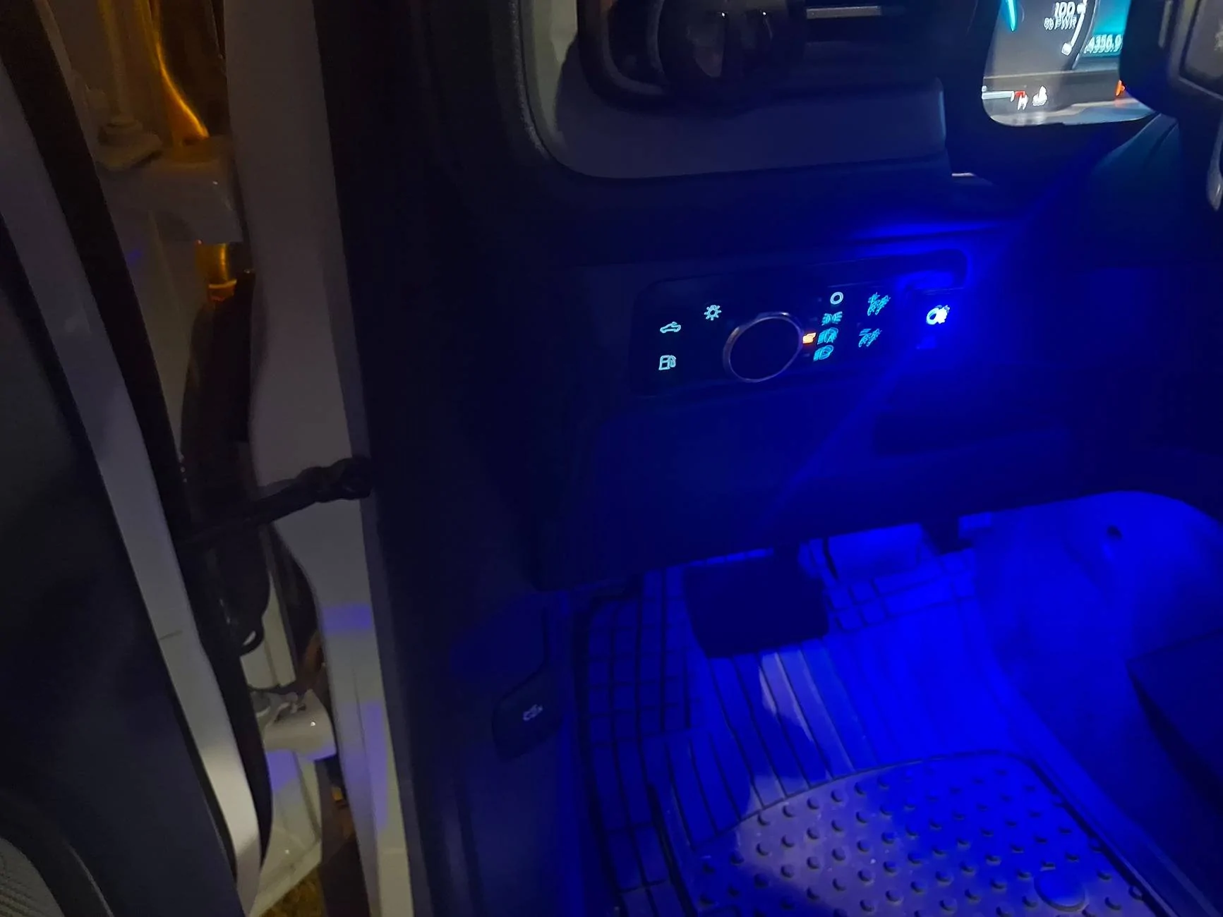

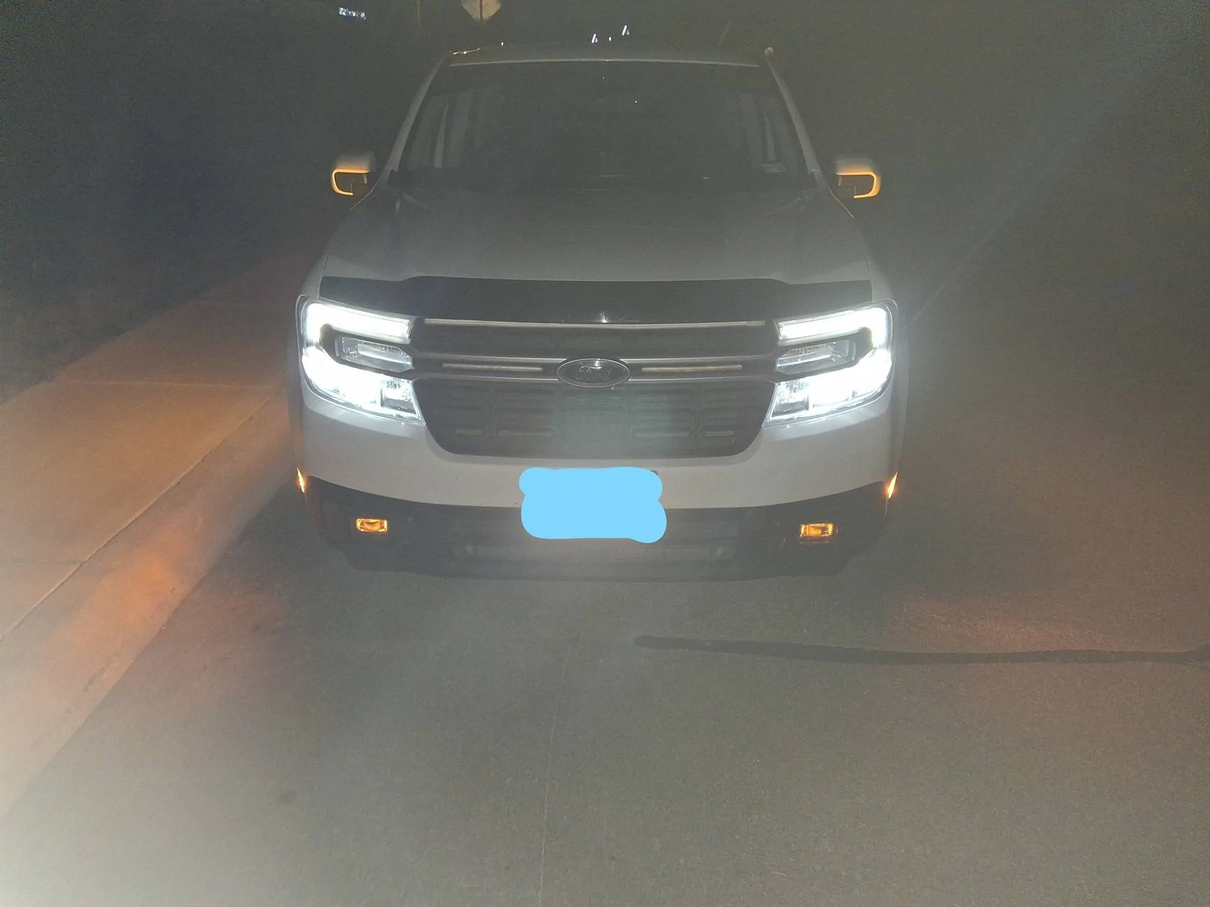

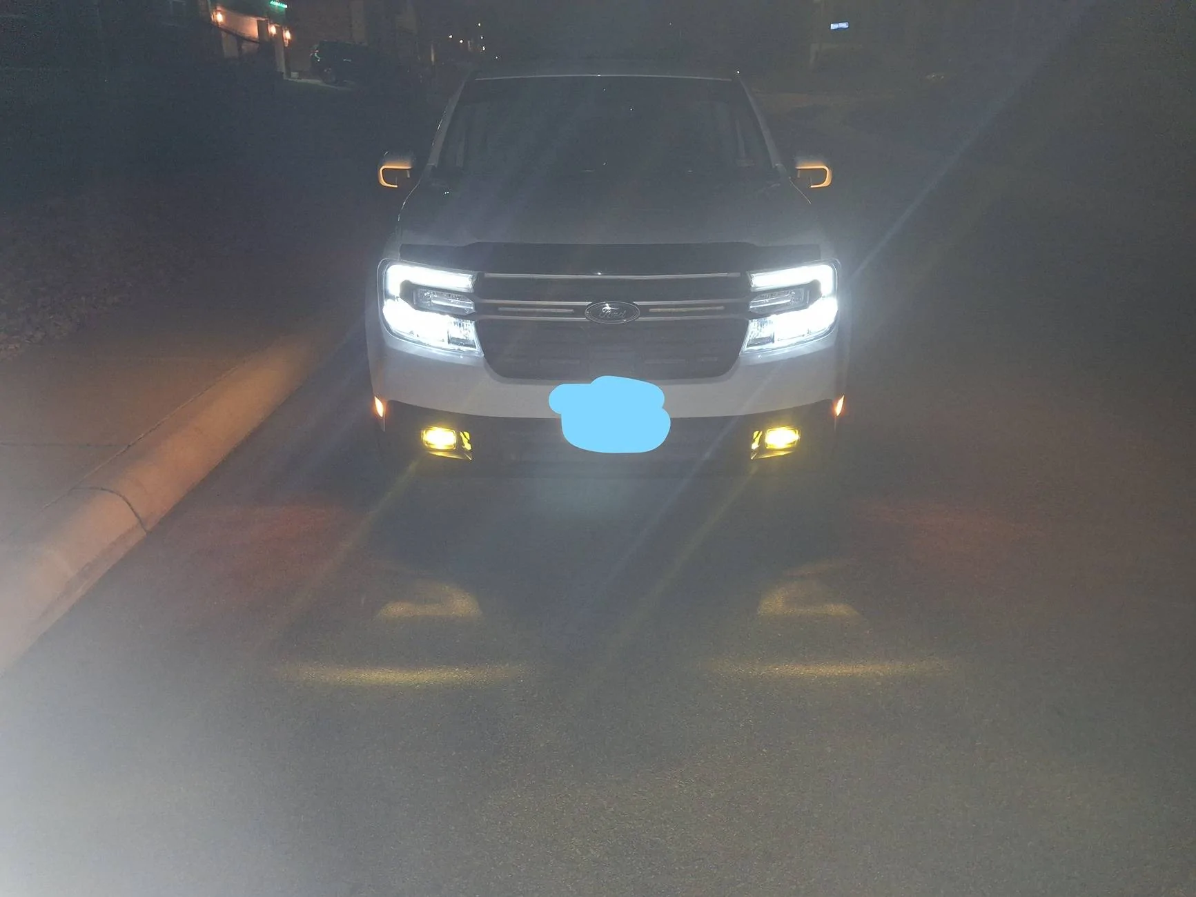

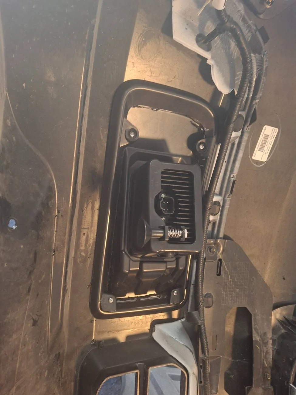

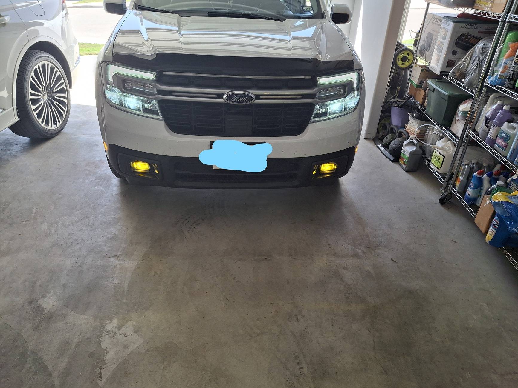

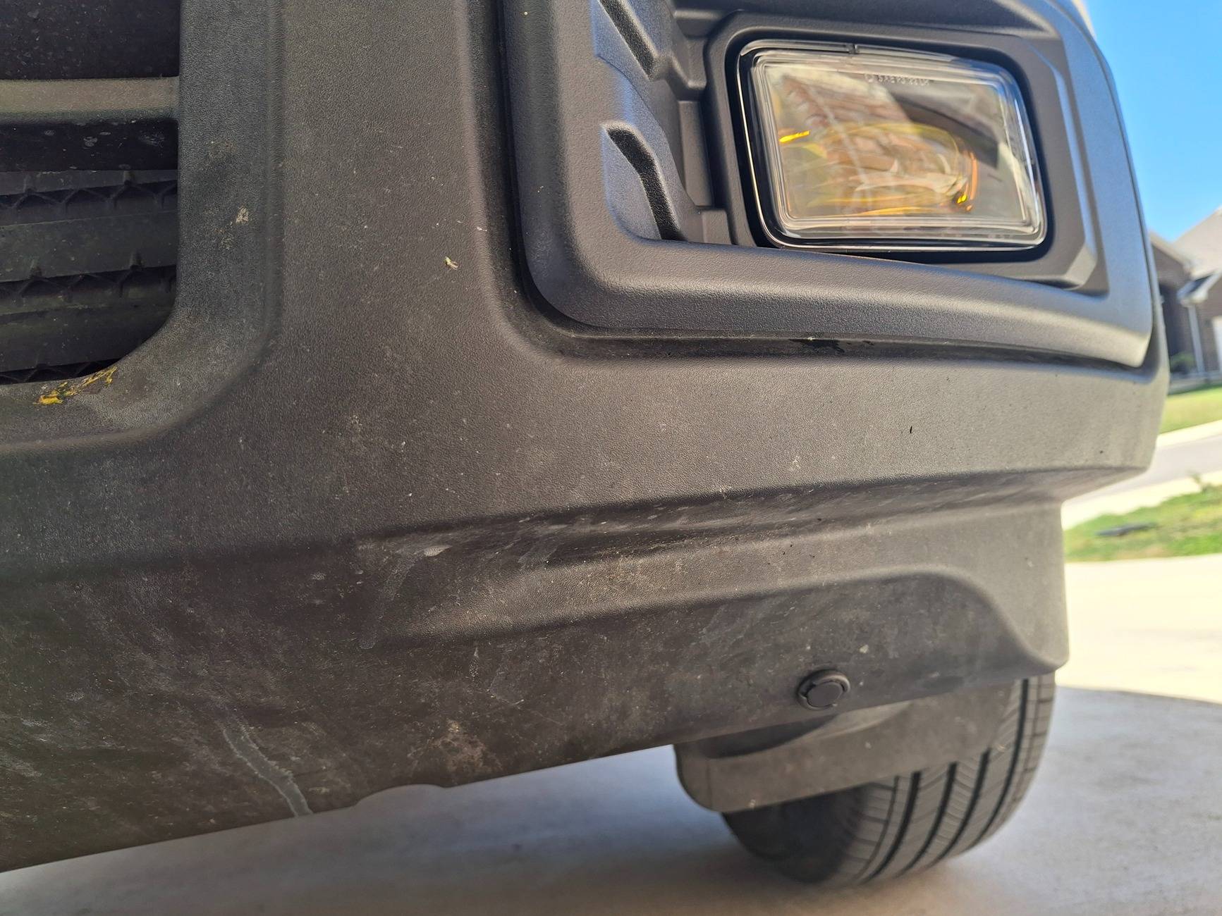

Received diode dynamics fog lights installed with the help of my (2) brothers took us about 6 hours to install. I put in yellow(amber) flush mounted fog lights from amazon about a year ago posted pictures of them installed. With the flush mount lights did get flashed from oncoming traffic so did not use them hardly at all. These dd fog lights are awesome for night time driving I would recommend everyone with a 22-24 non tow hook Maverick to get these lights. Drove home about 2 hours after install back roads in Texas have to watch out for deers & wild hogs crossing road did see 3 wild hogs in the ditch a good distance before i came up on them the lights have excellent visibilty for the ditches on each side of the road. During drive ran fog lights with low beams the entire drive never needed to turn high beams on adjusted lights before i left never did get a flash from oncoming drivers so that let me know that i have the lights adjusted correctly. Also the hole i drilled for the light adjustment i put in push pin retainers pic below. I did not use the wiring harness from diode dynamics since i already had the flush mount fog lights hooked up to a 4-pin relay and fog light switch already in use. The backlight activation wire did not hook to side marker light 12 pin molex ran wire from fuse #3 through firewall under hood connected to blue backlight wire they are always on with the ignition running. Also while the front bumper was off added front camera underneath front license plate frame pictures added.

I need help understanding the Diode wiring. I get a light on the switch, but I cannot get the fog lamps to turn on.
