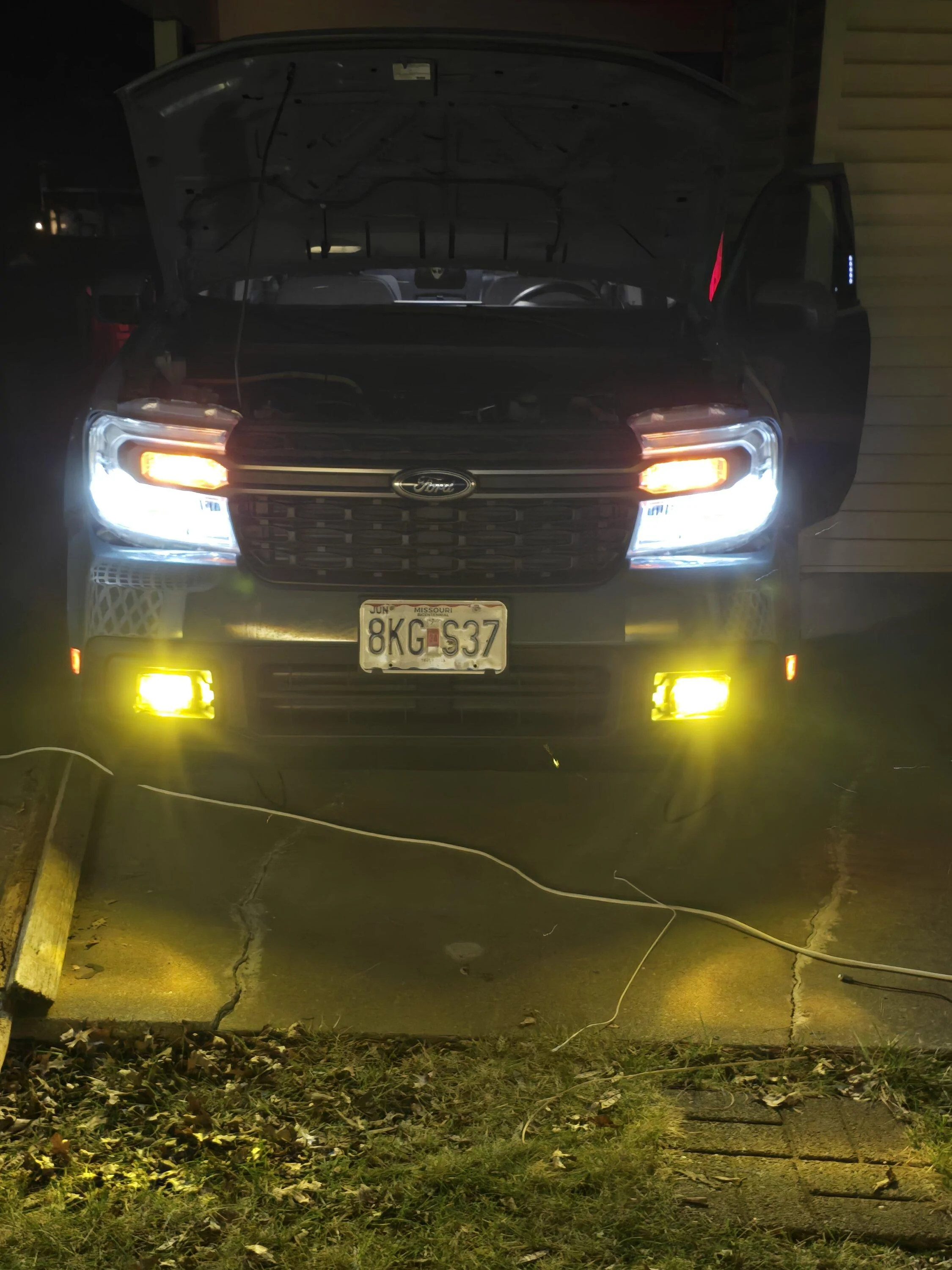

I've got no actual use for fog lights, but this kit looks extraordinarily attractive. If I find $300 under my pillow tomorrow morning this is how I'll spend it.

Wow. Have been looking at these for about a month now. They look AWESOME. Thanks for sharing.

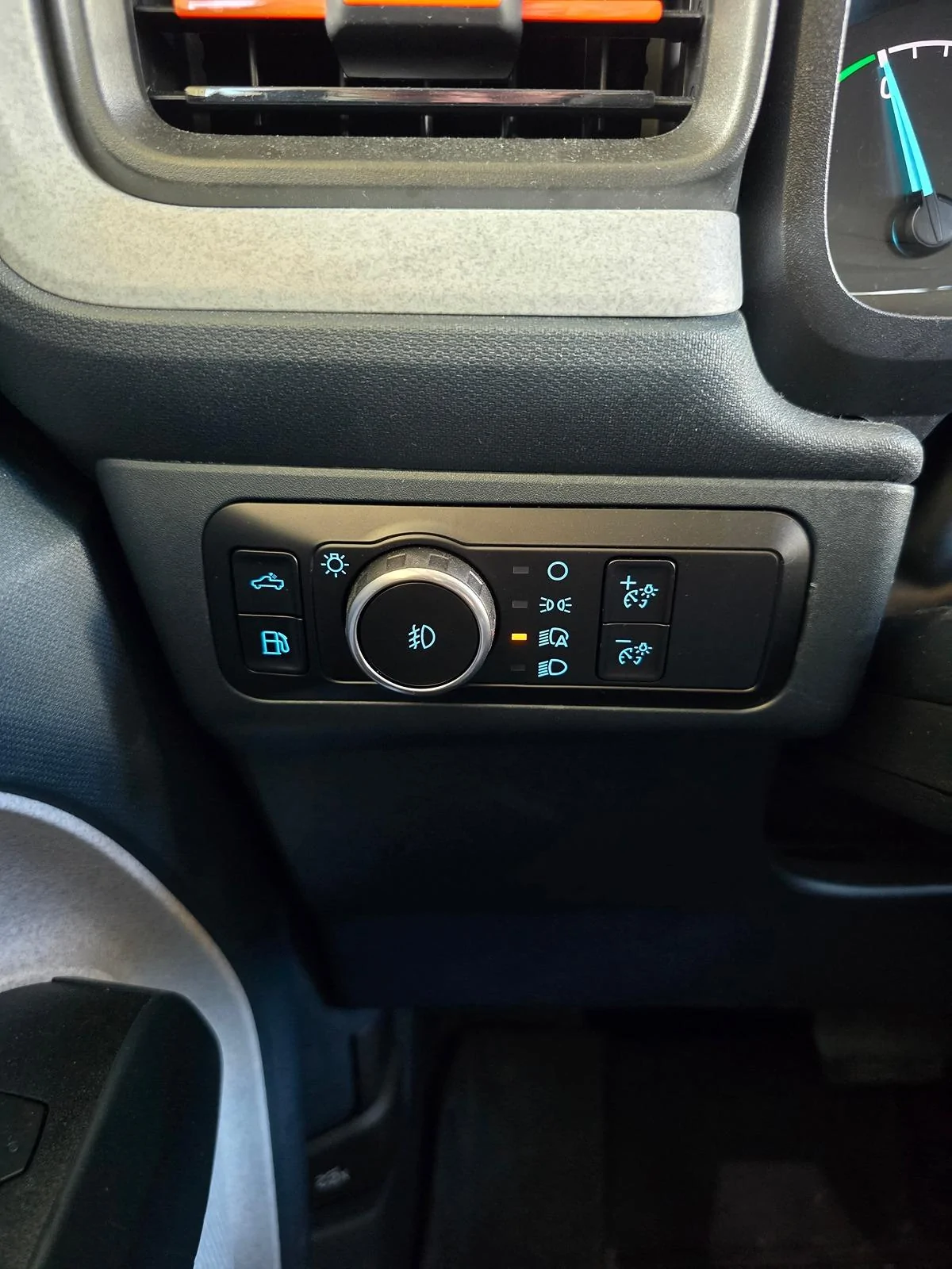

Following the "easy" way should be possible for most people. I am starting to look for someone who can work with me to install them using the F150 headlight switch and wire them that way so as not to damage any wires and not needing to mount a switch somewhere

This is what I also have planned! I just got my f150 hybrid headlight switch in and I'm waiting for the DD kit to ship. I do have one (maybe silly) question....where is the green wire (DU2Z-14474-DA) connecting other than the BCM?

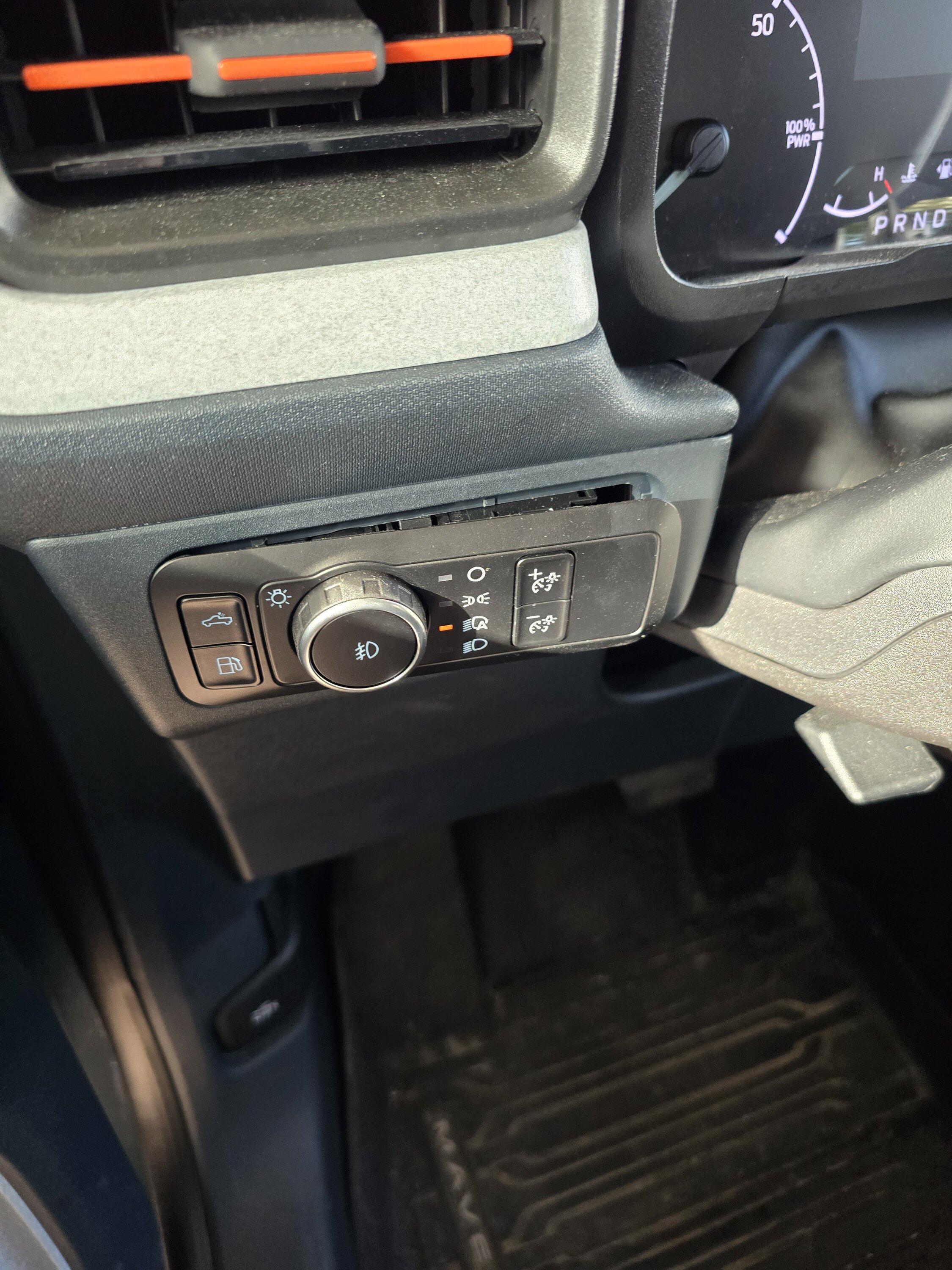

Mine stay on with the high beams unless shut off. Mounted a switch to the right of the headlight selector. Don't want them on unless I need them. Having them on with the high beams in fog/snow/rain is counter productive as they ruin the distance sight anyway.
I got this same switch to swap out the one from DD, but am confused on which leads it goes on - i assume the ground chassis goes to common, and then the others are NO and + ?
