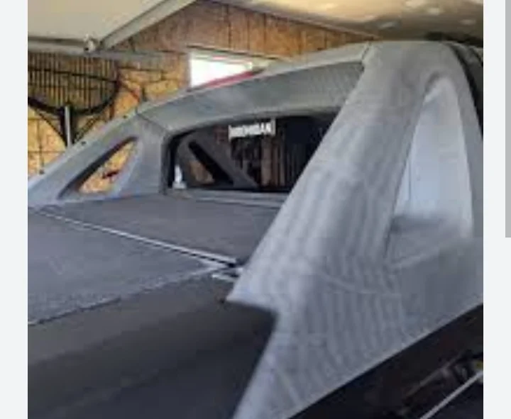

Reminds me of the Plastics they used on the Chevy Avalanche.
I wonder if these were made in China?
