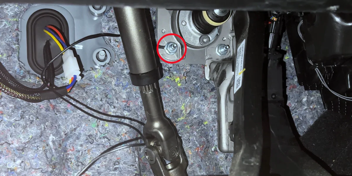

Merry Christmas everyone. I’m looking for the rubber plug/knockout that the white wire for the kit is being ran through. I’ve already pinned the bcm connector and programmed with forscan, ran a jumper from green to white outside the vehicle to verify. For the life of me I’m not able to see where I can run it out into the engine compartment. Thank you in advance
Straight from the DD instructions... Brake pedal and steering linkage visible in photo. Should be something similar on the BCM side if that is your preference.
