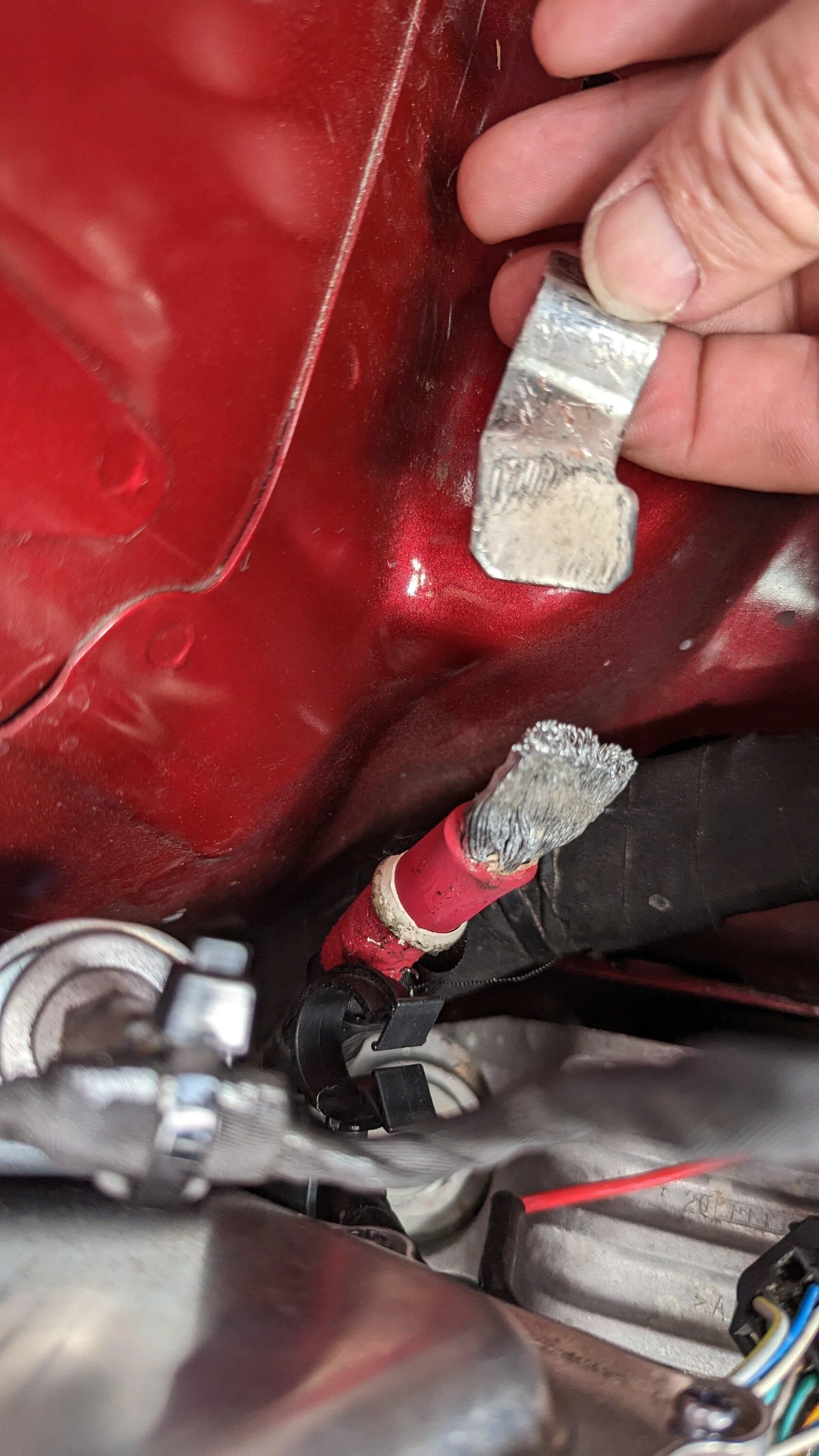

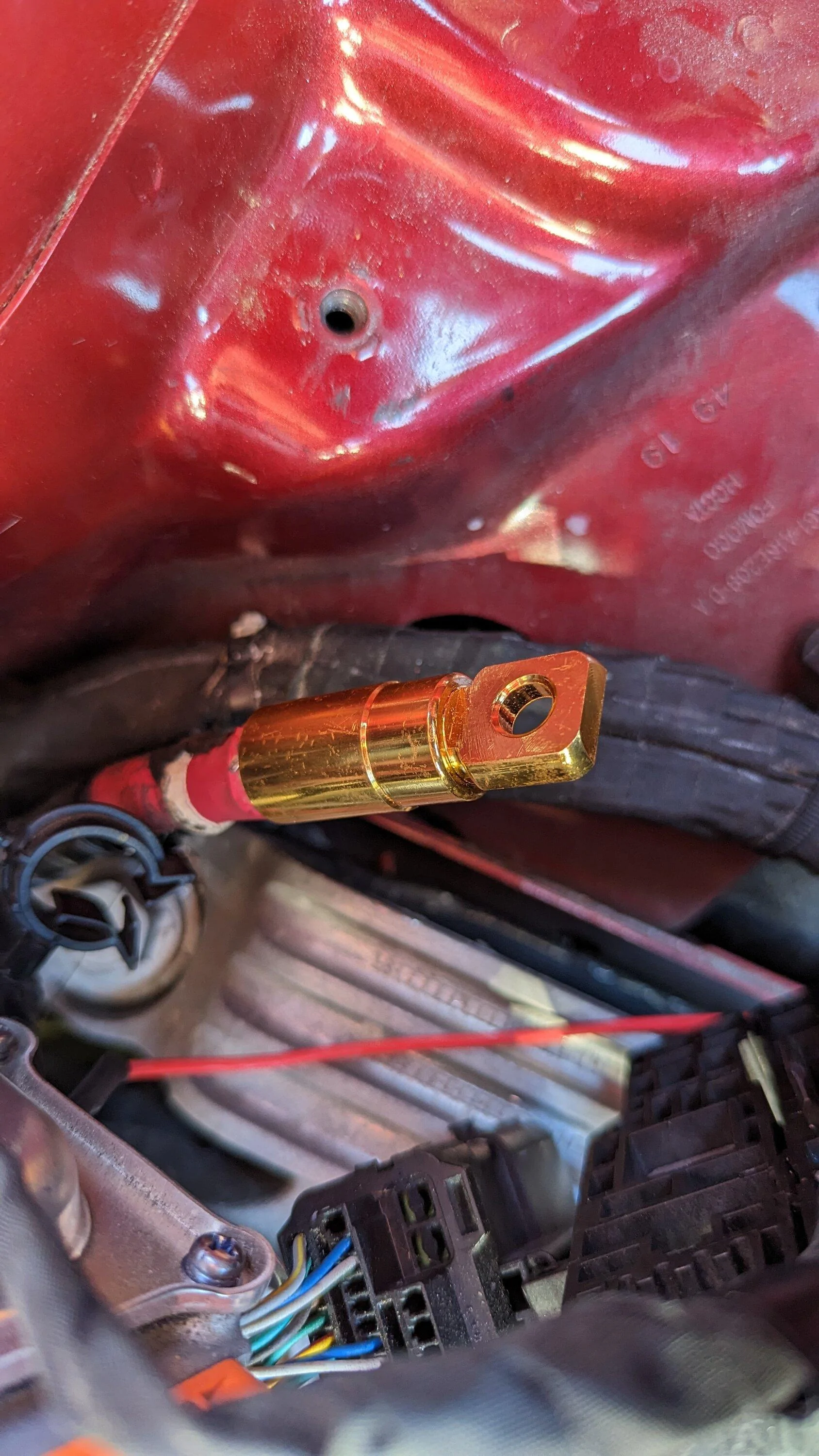

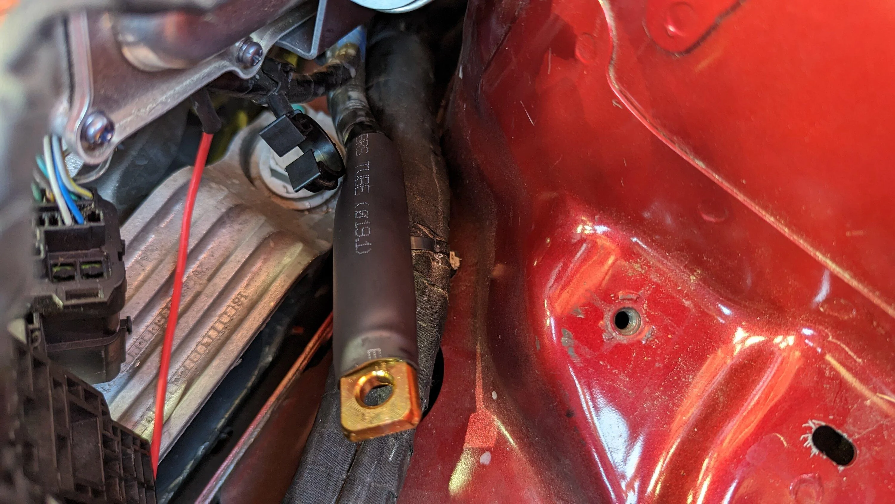

I have the same problem and figured I contact my dealership where I had nothing but a good experience since buying my first Mustang in 2004. Well, their service manager was unwilling to work with me on a solution. He told me to drop the car off and wait 3 to 10 days for a verdict. Ja, no. I ended up fixing it myself. I found below linked ring terminals on Amazon and put one of those on the cable. Shrink wrapped it and within 40 minutes everything was better than new. The ring terminal I used, has a set screw to secure the cable. All I needed to do was squeeze the cable into shape, shove it in, and screw it tight. A 3/4-inch shrink wrap from Harbor freight worked just fine. If I can fix it, you can fix it. Here is a link to the ring terminals I used.
Ford Maverick Dead Hybrid again, AFTER wire harness replacement! PXL_20230210_203126491
Ford Maverick Dead Hybrid again, AFTER wire harness replacement! PXL_20230213_151856715
Ford Maverick Dead Hybrid again, AFTER wire harness replacement! PXL_20230213_152402433.MP
Ring Terminals from Amazonhttps://smile.amazon.com/dp/B00AW17SNO?psc=1&ref=ppx_yo2ov_dt_b_product_details
