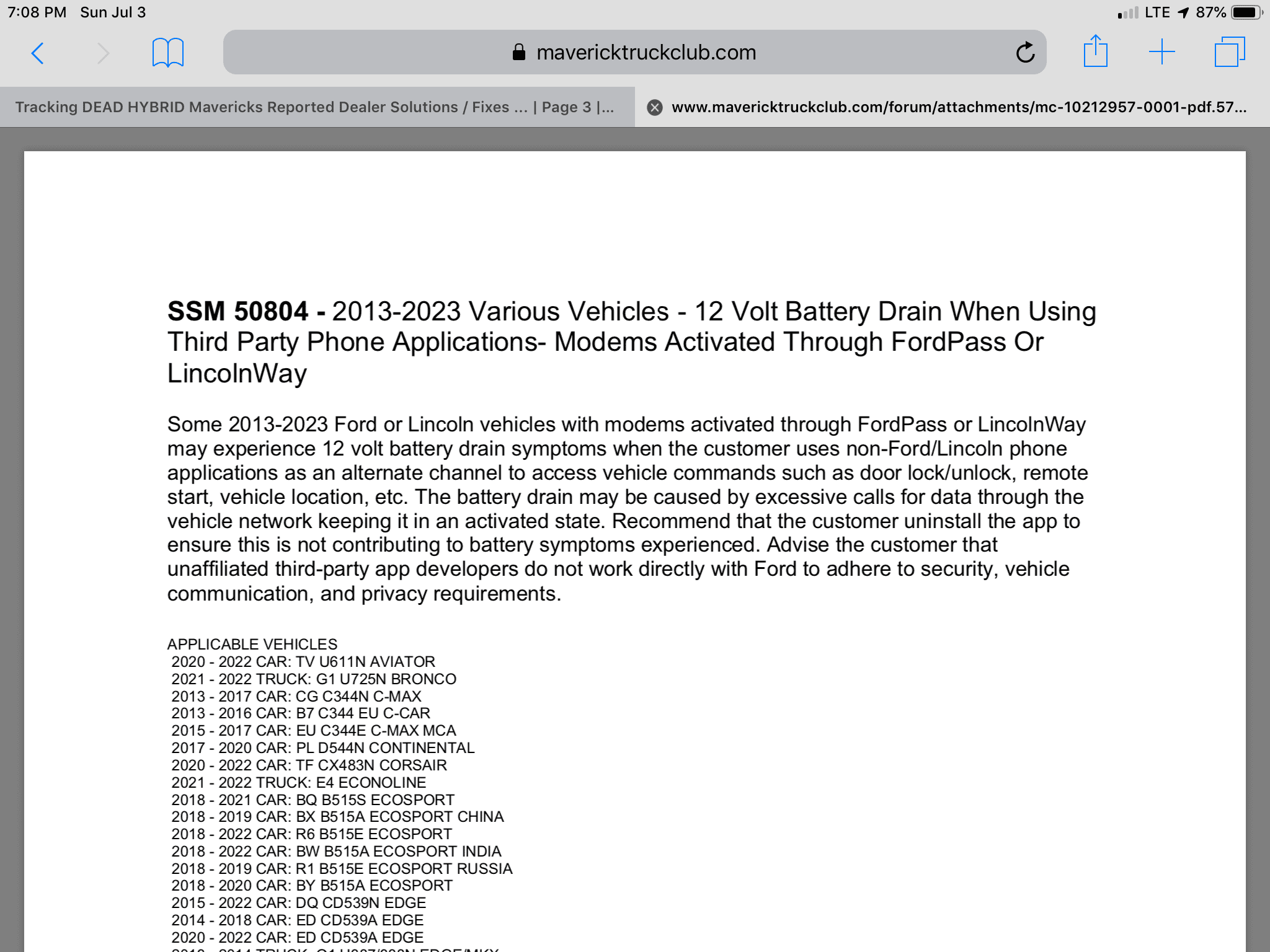

If you read it carefully, that notice is telling folks to uninstall the "3rd Party" app that is causing the problem, not the Ford Pass (or Lincoln Way) app. Huge difference.
If the Ford Pass app isn't active and communicating with the truck, I don't see how it could possibly be causing a battery drain. But a 3rd party app that activates Ford Pass to create the communication link, and then leaves it active and running in the background so it can communicate with the truck - that could definitely cause a battery drain, as Ford is saying in SSM 50804.
This concern is one of the reasons that I make sure I actually unload the Ford Pass app from memory when I'm done using it - every time I use it. On an iPhone, you just swipe up on the app on the iPhone to "discard" it. (I'm not sure how you do that on Android, since I don't use it). And that MIGHT be why I've never seen the Deep Sleep issue with my Hybrid. I wonder if those who ARE experiencing the Deep Sleep issue are leaving Ford Pass running on their phones? If so, closing the app completely might make a difference?

I just shut off apple pay, wifi connection and bluetooth (on phone and truck) and Issue seems to have resolved no more dead battery so far
