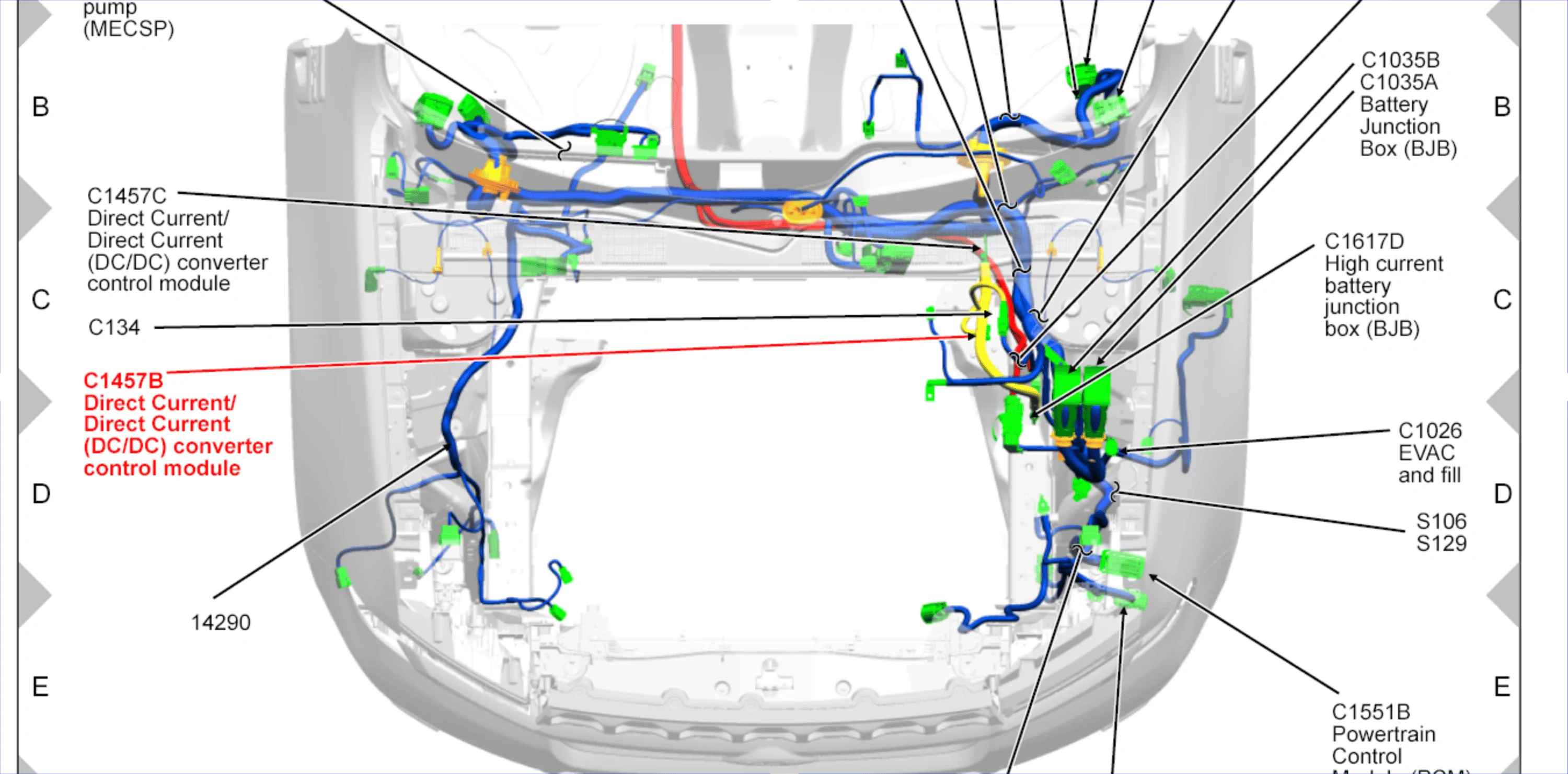

Dealer found multiple low voltage codes. DCDC module not communicating with scan tool. connector C1457B was disconnected. reconnected and was able to clear all codes. truck now no problems at present.

Where is connector C1457B?
C1457B is one of the connectors on the DC-DC converter itself. So in @Mikecando's case where they replaced the 12V cable assembly first they probably disconnected the DC-DC converter to move it as part of that procedure and forgot to plug it back it in.

Ford used to have the connector number actually give you a clue to where it is physically located, I was just wondering if that is still the case.

Looks like it's under the hood near the 12v battery.
Like I said, no logic, on Foxbody Mustangs the actual number represented how many inches is was back from the bummer.
