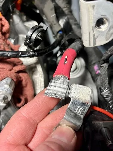

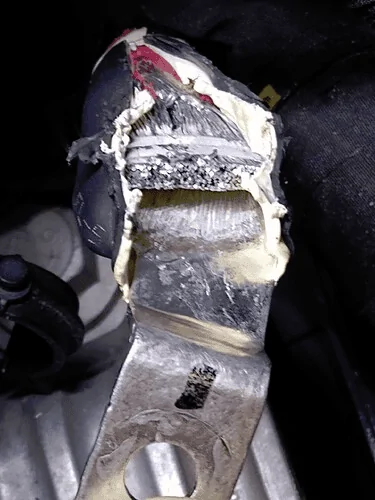

Just my opinion, but the Ford Pass app communicating with the truck should have zero to due with the 12V battery not being charged from the Hybrid battery. It's more likely the cable connection in question. I've had no Deep Sleep/Remote features disabled messages since putting a small clamp on the connection.
And I only got the one when I wiggled the connection to test it, which likely momentarily broke the connection.

Are you taking your MAV to the dealer to have that connection looked at? The Ford app has caused problems for some. It can cause a 12v battery drain. Chicago Mike seems to be experiencing the problem.
Not until a recall is issued, or if I have another problem with it. When I called, they had heard nothing about the issue and wanted me to leave it there for at least a week to diagnose it.
I run the Torque Android app daily and check on battery voltage, consistent 14.5V when running.
