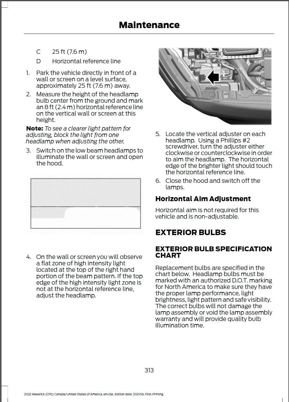

I don't see any information on page 313 about the battery. That page is about headlights.
Ford Maverick Dead Hybrid again, AFTER wire harness replacement! Page 313
MakinDoForNow
Sep 24, 2021
8,650
6,295
They must have reprinted manual. Mine came with truck made in Jan 2022 and delivered to me March 9, 2022. There wasn't much about ten lines on the top left of p313. I will look at the manual that came with my maverick I got in October 2022 when I get home. Maybe they have changed the 12v BMS SOFTWARE and hopefully automated the soc of 12v???
