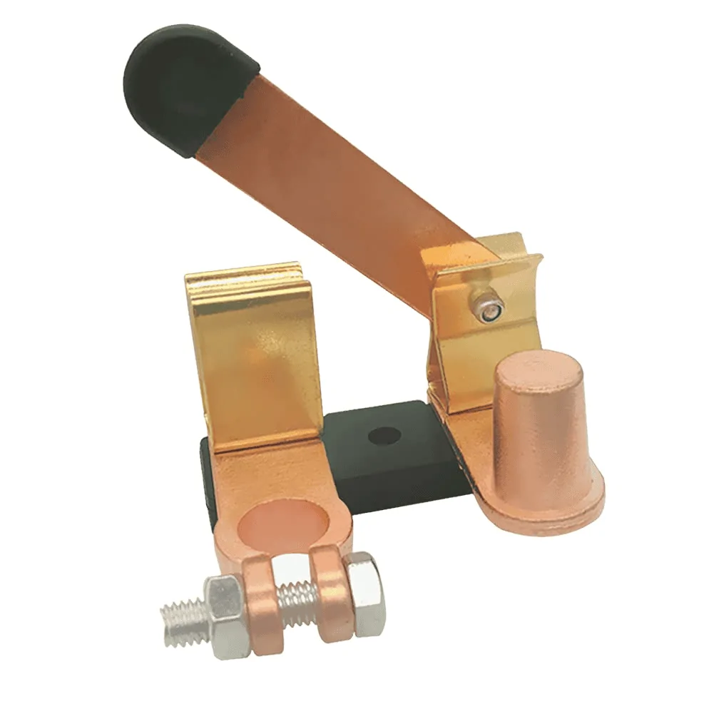

I ike this switch. Also a good theft prevention. Is there any danger in using this on the hybrid daily ?
Maybe even something like this :
https://www.amazon.com/Post-Battery...d-44e8-b17d-9c1e41a24fd2&ref_=pd_gw_ci_mcx_mi
Good question. I hadn't considered that it might be an issue with the hybrid. I don't have one on my hybrid Mav, so it's an unknown.
I do like the version you linked better due to being able to remove the knob and make it more difficult to get power to the vehicle.

I really like the idea of a battery disconnect switch. I may order and try it out. Just doing more research on it first.
One vendor had one that disconnects the negative post using a switch located in the cab. Much more convenient and by hiding the switch you can stealthly disable the vehicle. Unfortunately, I don't remember who I bought that from. Put it in my Chevy Colorado Z71 to make flat towing more convenient. Truck since destroyed, sad to say. Checking Amazon more recently, I saw many that now incorporate a remote fob that eliminates having to open the hood every time. I just typed "battery disconnect remote switch" in the search box.
