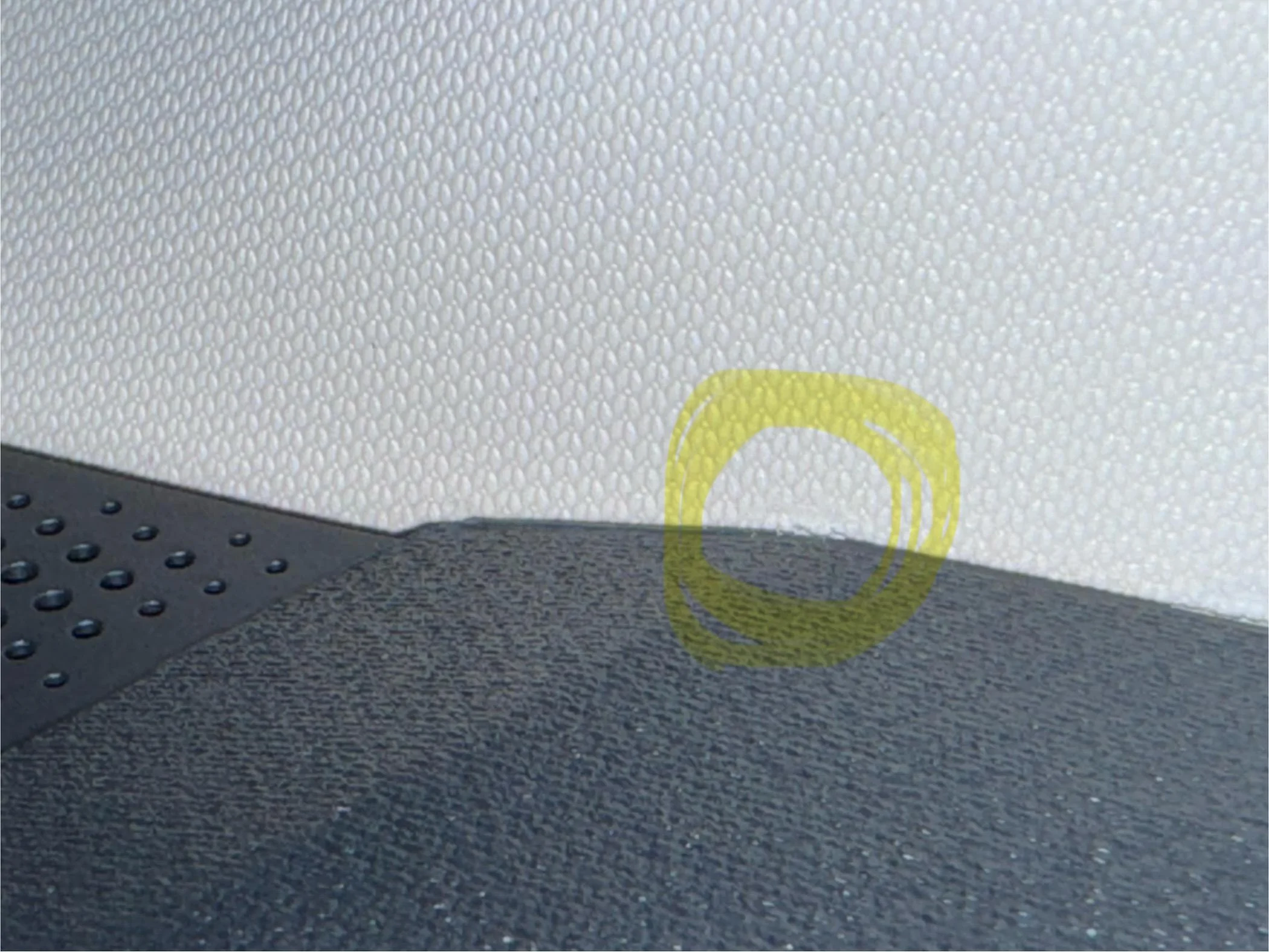

I fixed one of my more recent rattles. Found that the passenger side air vent was moving enough with vibration to have contact with the dash components. Placing a hand on the top of the dash was curing the rattle and so was holding onto the vent. I placed a tiny amount of foam under the gap between the dash and vent housing which is circled in the picture. No rattle after 2 days.
Ya know, I’ve never heard a rattle or any noise in my Mavs cab until I start reading these posts. Now I hear them all the time! 🤣
