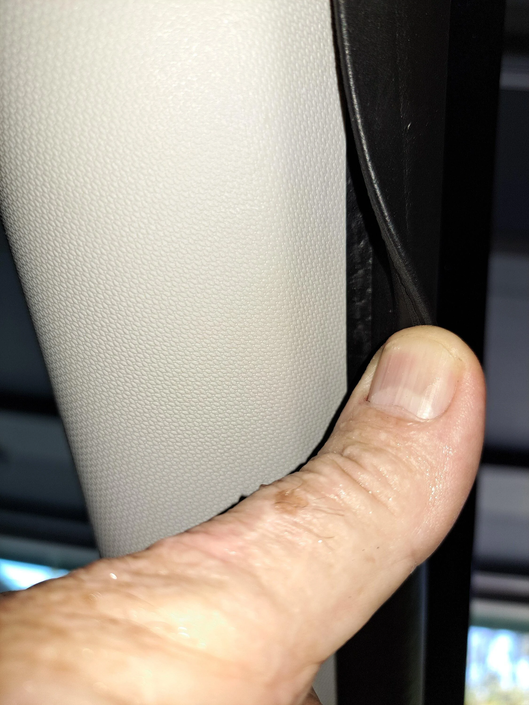

To all of you out there with the annoying dash rattle, I had the rattle on bumpy roads like many of you and got no help from my dealer fixing it. I remembered an earlier post of someone saying that they ran a wire down the pillar post for their auto dim mirror and after they put the plastic cover back on their rattle stopped, Well by chance I looked at my pillar plastic cover and guess what? The rubber trim was on the wrong side of the cover only 20% was over the cover and the rest was under the cover,so I used my key and slid it down the cover moving the rubber onto the outside of the cover and the rattle is now a distant memory!!
