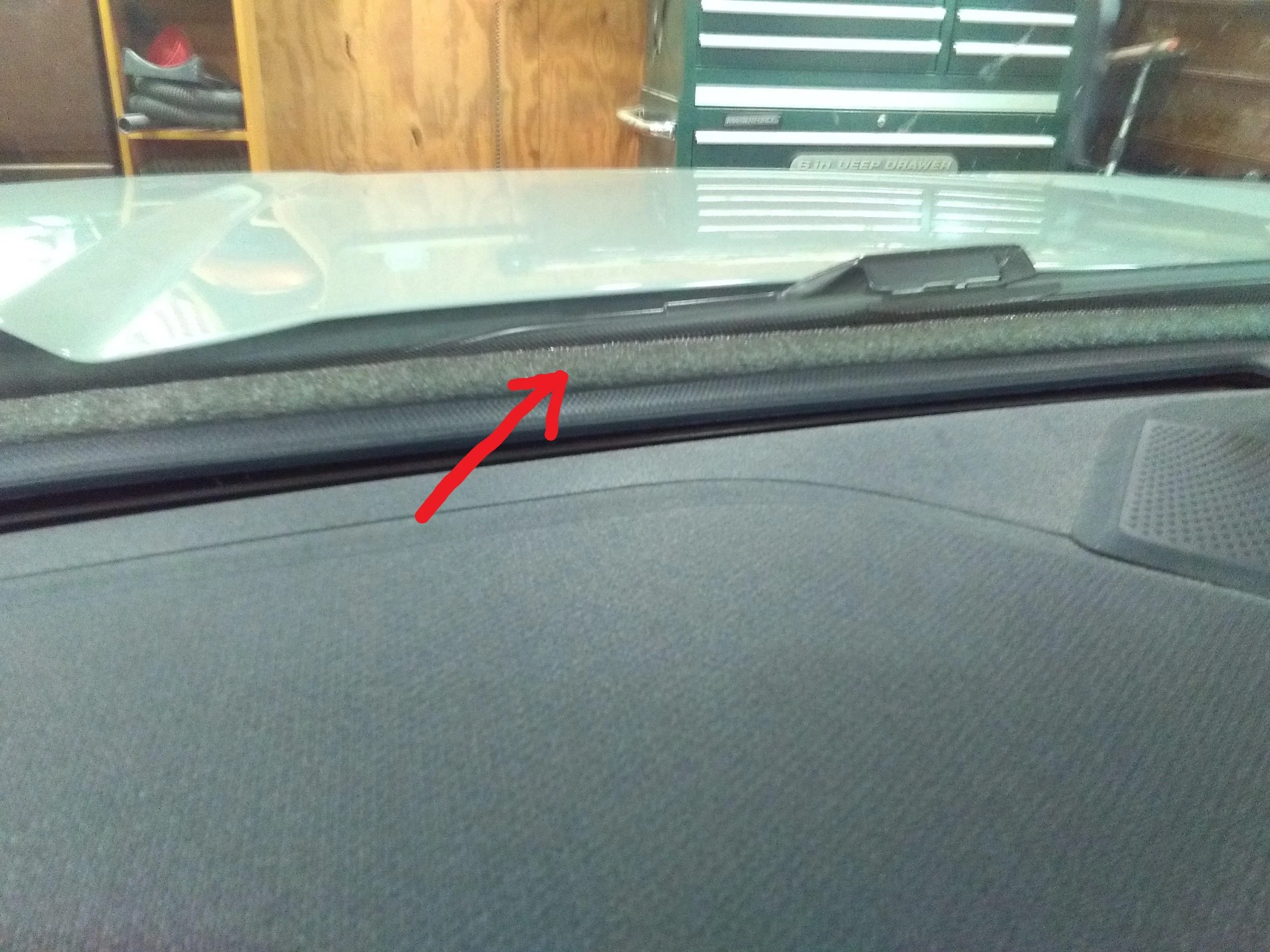

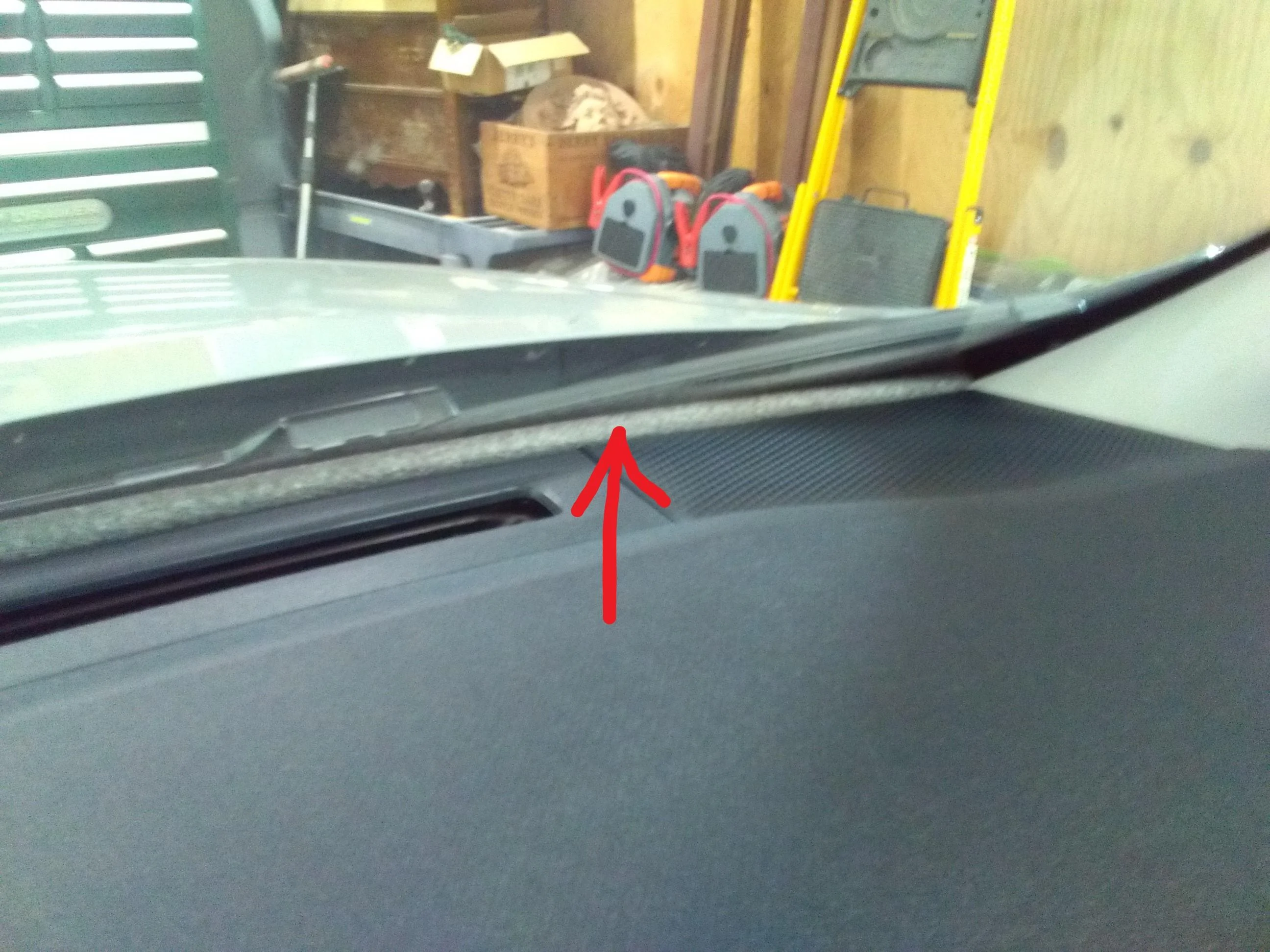

I posted this elsewhere on this forum (I'm not experiencing this rattle so I haven't tried this on my Mav) -
This was a fix for my 1st Gen Tundra (and a lot of other folks too). It was a dash rattle where the windshield and the dash meet. Backer Rod from HD or Lowes; $4 for 20ft. Just tucked it in and the rattle was 99% gone.

What thickness of backer rod do you use? Thanks!
5/8" on my Tundra but 1/2" may work better on the Maverick. But $5ish a pop pickup both and see what fits best

I read your post and bought both 1/2 and 5/8 backer rod from my local ACE hardware. On my Lariat (with the acoustic windshield) the gap between the dashboard and windshield is not uniform. The 1/2 fit OK until it got about one third of the way across the dash when it was loose and then got snug again about two-thirds the way across. I pulled that out and installed the 5/8 which was snug all the way across. I left it little proud so it would make full contact with the windshild and the edge of the dash. It actually looks like factory. If it goes bad from sunlight/heat, it's cheap to replace and it takes a couple of minutes.
So far, the noise is gone. Mine only happened on gravel roads (we live on a gravel road).
Thanks for your help.
