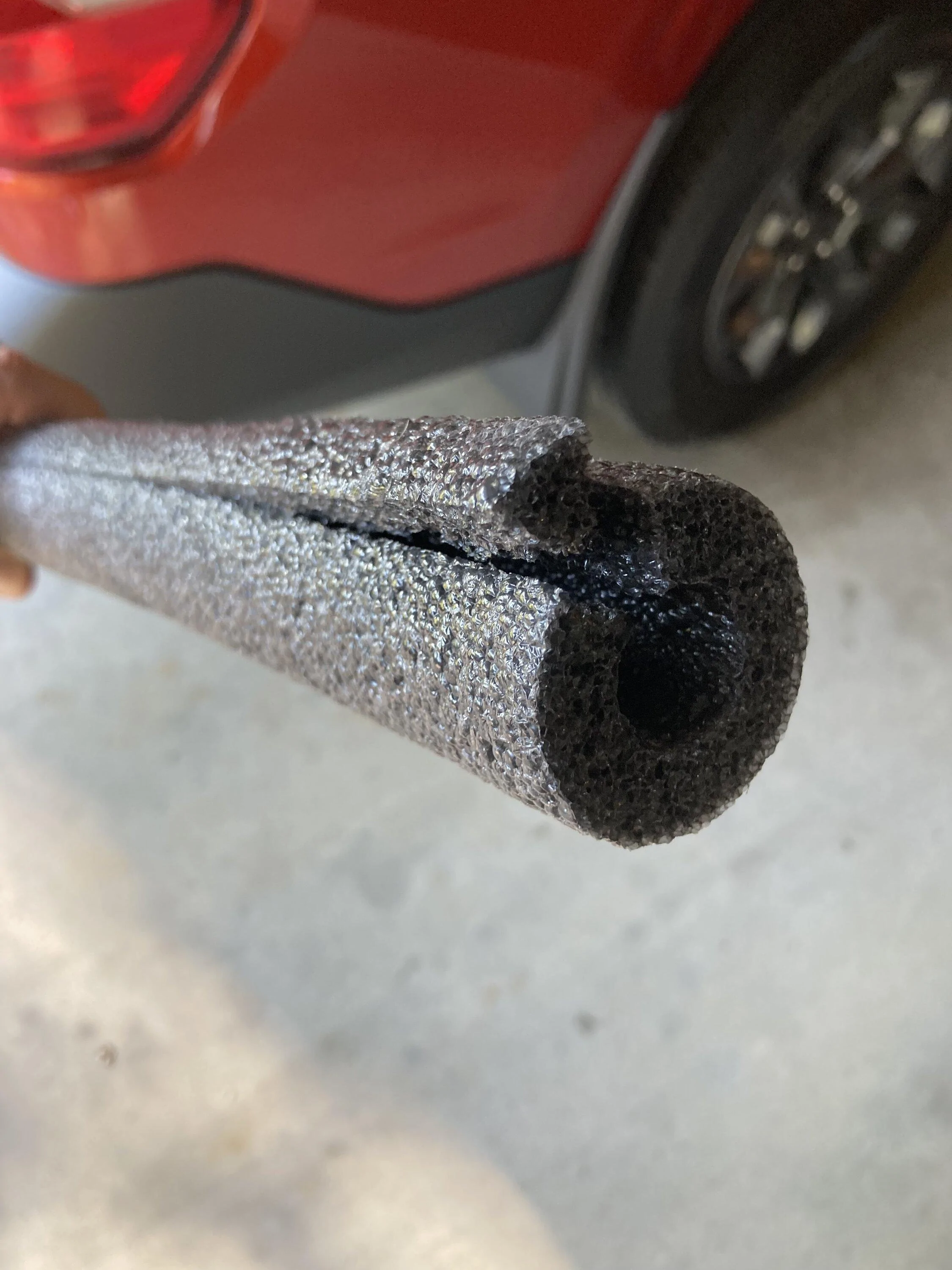

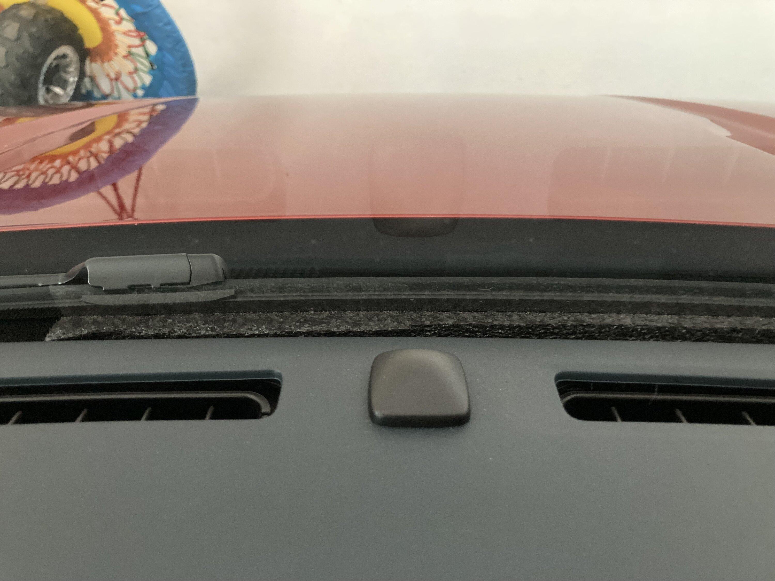

I've had good results on past vehicles including my current 23 Mav.XLT.... bought 1/2" by 6" pipe insulation for under $2 at Home Depot/Lowes, cut 1/2" strips about 10" long and used a plastic spatula to stuff the strips across the the dash at the windshield. I left about 1" unstuffed on each strip for easy removal in case the process was unsuccessful. It has worked well so far, my only rattle being my key chain
