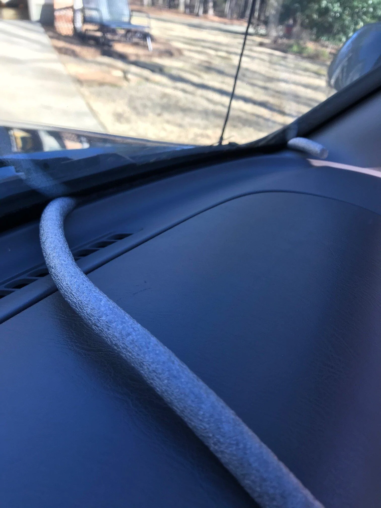

I posted this elsewhere on this forum (I'm not experiencing this rattle so I haven't tried this on my Mav) -
This was a fix for my 1st Gen Tundra (and a lot of other folks too). It was a dash rattle where the windshield and the dash meet. Backer Rod from HD or Lowes; $4 for 20ft. Just tucked it in and the rattle was 99% gone.
This is basically the fix that ford has . They did this it did not work. They removed the windshield tabs , rattle still there . Said need to replace the dash skin. 2023 xlt hybrid
