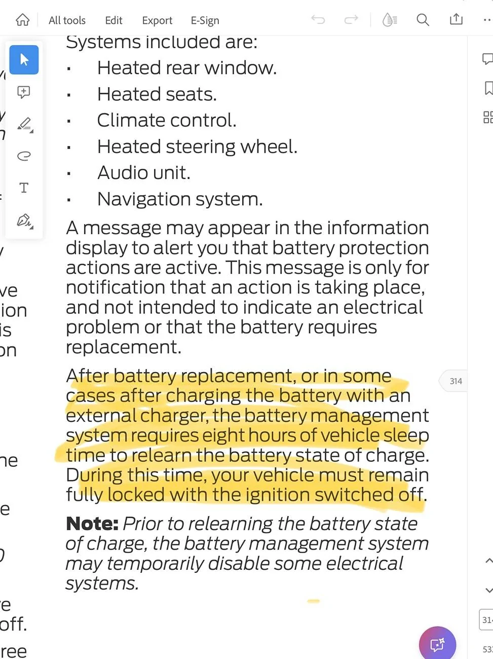

I don't see anywhere it's going to know it's an AGM.
I do see it says to do the same reset routine that's been mentioned.
The battery is in the engine compartment.See Under Hood Overview - 2.0L EcoBoost™.
Your vehicle has a maintenance-free battery. It does not require additional water during service.
If the vehicle battery has a cover and vent hose, make sure you correctly install it after cleaning or replacing the battery.
For longer, trouble-free operation, keep the top of the battery clean and dry and the battery cables tightly fastened to the battery terminals. If any corrosion is present on the battery or terminals, remove the cables from the terminals and clean with a wire brush. You can neutralize the acid with a solution of baking soda and water.
We recommend that you disconnect the negative battery cable terminal from the battery if you plan to store your vehicle for an extended period.
Note: If you only disconnect the negative battery cable terminal, make sure it is isolated or placed away from the battery terminal to avoid unintended connection or arcing.
If you replace the battery make sure it matches the electrical requirements of your vehicle.
If you disconnect or replace the battery and your vehicle has an automatic transmission, it must relearn its adaptive strategy. Because of this, the transmission may shift firmly when first driven. This is normal operation while the transmission fully updates its operation to optimum shift feel.
Battery Sensor Reset
When you install a new battery, reset the battery sensor by doing the following:
  1. Switch the ignition on, and leave the engine off.
Note: Complete Steps 2 and 3 within 10 seconds.
  1. Flash the high beam headlamps five times, ending with the high beams off.
  2. Press and release the brake pedal three times.
The battery warning lamp flashes three times to confirm that the reset is successful.

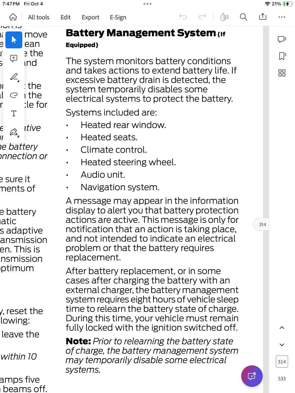

Battery Management System (If Equipped)
The system monitors battery conditions and takes actions to extend battery life. If excessive battery drain is detected, the system temporarily disables some electrical systems to protect the battery.
Systems included are:
  • Heated rear window.
  • Heated seats.
  • Climate control.
  • Heated steering wheel.
  • Audio unit.
  • Navigation system.
A message may appear in the information display to alert you that battery protection actions are active. This message is only for notification that an action is taking place, and not intended to indicate an electrical problem or that the battery requires replacement.
After battery replacement, or in some cases after charging the battery with an external charger, the battery management system requires eight hours of vehicle sleep time to relearn the battery state of charge. During this time, your vehicle must remain fully locked with the ignition switched off.
Note: Prior to relearning the battery state of charge, the battery management system may temporarily disable some electrical systems.
Keep reading. It’s later on the same page as above.
You must be using the non-updated non-current paper copy.
The possibly updated PDF for page 314 you referenced earlier is removing the rear lamp assembly, and the bulb specs and types.
https://www.ford.com/support/vehicle/maverick/2022/owner-manuals/
That page I showed is now on page 311 - and there is absolutely nothing about AGM under ANY of the pages dealing with battery for Eco-boost. There is no "later on the same page" as it ends with the Note I showed.
Page 312 after the page I entirely quoted is about Remove & Reinstall the Battery. Nothing on that page about AGM. It refers to the Specs pages starting on 355 - battery reference there:
Battery. BHEF-48H6
Which is not an AGM battery. But can be replaced by such!
https://www.fordpartsgiant.com/parts/ford-battery_bhef-48h6.html
But back to the original point - where you said the truck would learn it had an AGM battery and that's in the manual.
Where exactly is that?
What does it say - a picture would be great for others to see they had the info available.
Because I searched all 533 PDF pages for the 2022 Ford Maverick manual and AGM was not even found!

@Ringo ,
Ya - I had already quoted all of that. Wasn't later on the page. Might want to reread my post replies.
You stood by your point that it said it would learn you had an AGM battery.
So you were wrong. Just wanted to make sure I and many others weren't missing something in the manual about AGM batteries.
Perhaps you were remembering the fact it's a value in the BCM many have reported, that seems to be default set. If it's actually used for anything is another matter.
