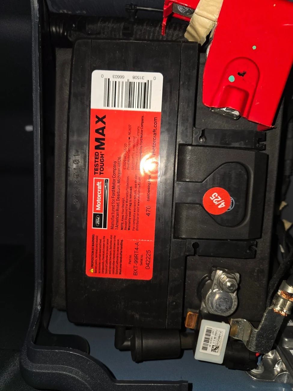

So I have had the deep sleep issue for a while now, thankfully it never went totally dead. Had it serviced yesterday and they replaced the battery. The service report shows replaced with AGM battery, but I dont think they did.
It does say Tested Tough, LMAO. What does that mean? It looks just like my 3rd battery, which was also 470 CCA and not an AGM, but a bigger CCA battery than it came with. When all else falls, throw a larger battery at it.
