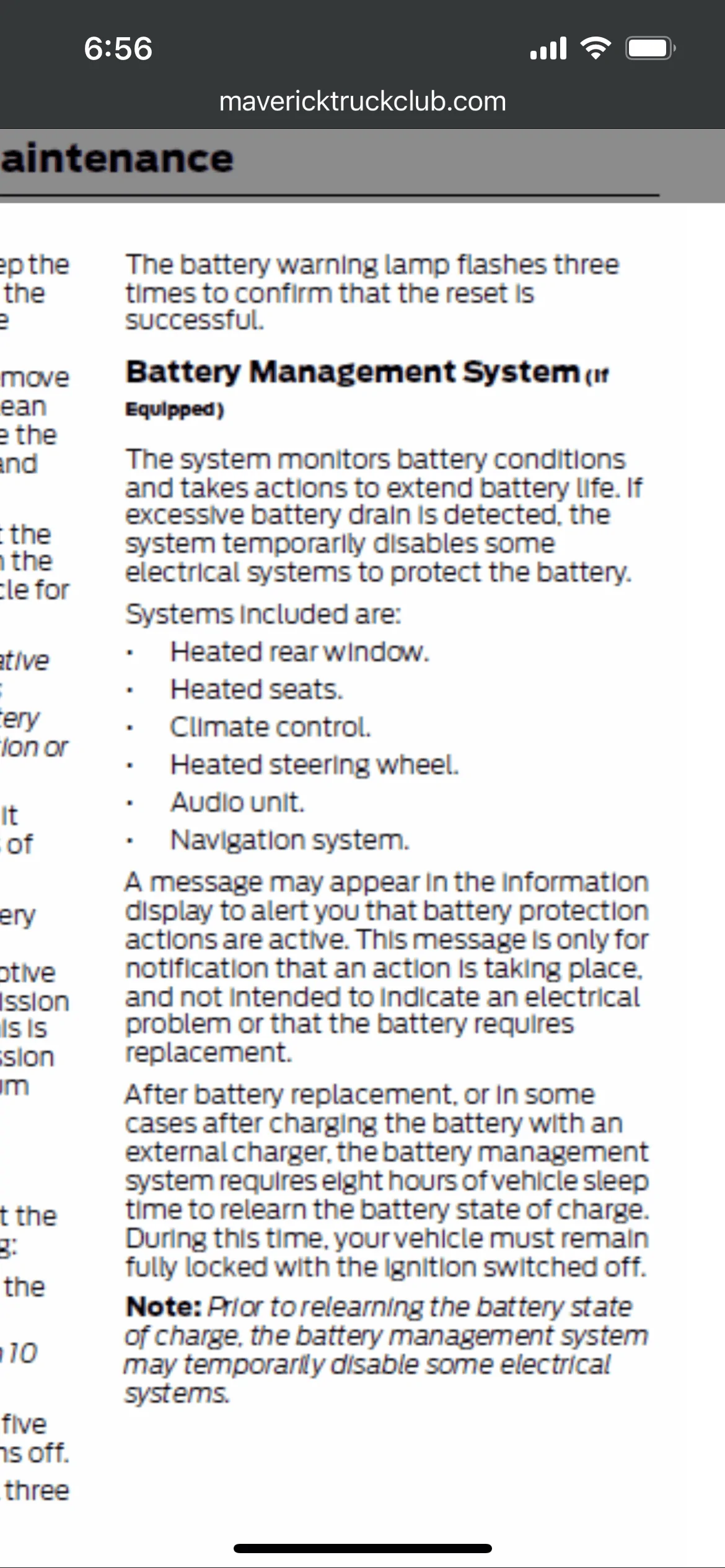

Upnash, I'd venture that deep-sleep was within minutes of turning if off? - There's a 40-50 minute period of time immediately following shutdown during which there's a pretty good draw on the 12v battery, until most of the electronics shut down. Contrary to what you expect, right after driving isn't the highest battery voltage level or SoC. (Been monitoring mine for the past several weeks with a little low-power Bluetooth device).
Since the dash, head-unit, and lights all go out, it must be the onboard electronics, but who knows what in tarnation its doing for that period of time, and its always about the same amount of time. Then the SoC & Voltage readings pop up, and will gradually drop by around 1% per hour (give or take). I'm sure the 1% is the radio awaiting a possible Ford-Pass command to unlock, honk, start, or request for vehicle status (tpms/oil-life).
The factory battery does NOT like being drawn low, and never fully recovers. Mine was absolutely fine until I spent the afternoon washing & detailing it, after which I received my first deep-sleep message. Friendly reminder, DON'T do it with the key on your person or within range of the truck , particularly if you have a Lariat with the proximity key. Even spraying water at the handle to rinse it off will cycle the locks, let alone wiping or polishing the area. - Might as well cycle the ignition on/off, and everything turns on for that 40-50 minutes. Ever since that day mine has thrown random deep-sleep messages, although performing a 'Recovery' with the smart battery charger seems to have helped considerably, but still not 100% back, so while it helps it isn't 100% restoration.

Replaced my Ford battery also. Only a year and a half old. Ford said it was ok but decided to spend $200 on a better battery just for peace of mind. Now I will monitor the voltage levels more closely. The BMS was new to me and I ignored it at first. That probably allowed the voltage to get too low for too long and damaged the battery. There is a reset procedure for the BMS after a battery replacement or boost charge.
