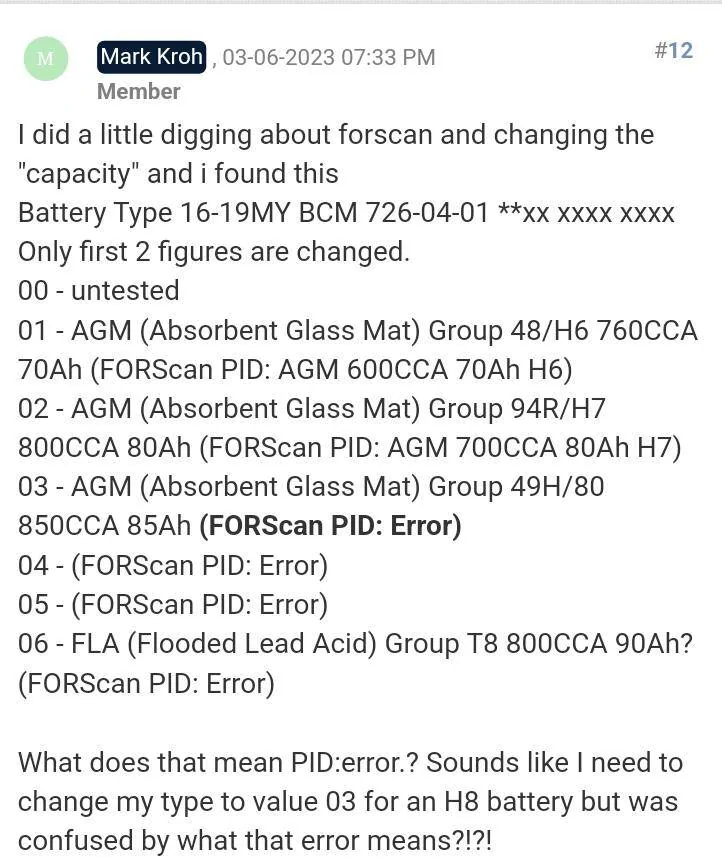

Ok did some looking and found couple things:
#1: someone in F150 forum using forscan to set battery type to AGM. This was 2021 so maybe the codes then are not the same now and/or may have different ones for valid maverick. From what I've read the 01 is for a BC AGM and the code 02 is for AGM... etc.
#2: a link to different f150 thread has 86 posts from someone asking about installing different battery. Member bluegrass post quite a bit on the Ford BMS and in one past halfway if I remember correctly stated the different items (8+?) that the program used to charge the particular selected battery (variables different for different batteries, etc.).
Need to find the table for all Ford allowable battery types and their xx codes.

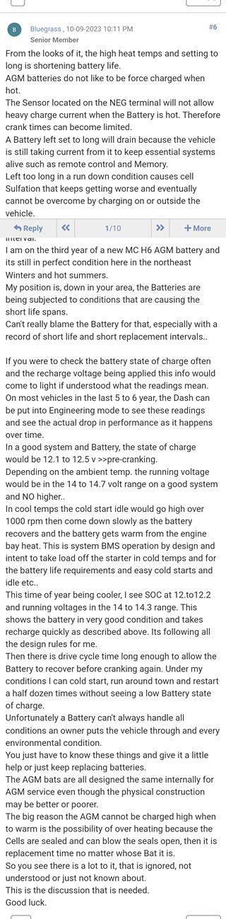

Good luck to you also. In post #16 this thread I posted link to F150 forum discussing Ford's BMS. Control program for it selects vehicle it's in as well as battery installed. I suggest reading it paying attention to bluegrass members posts. He comments when BMS charges and doesn't charges and why. Here is screenshot of one post.

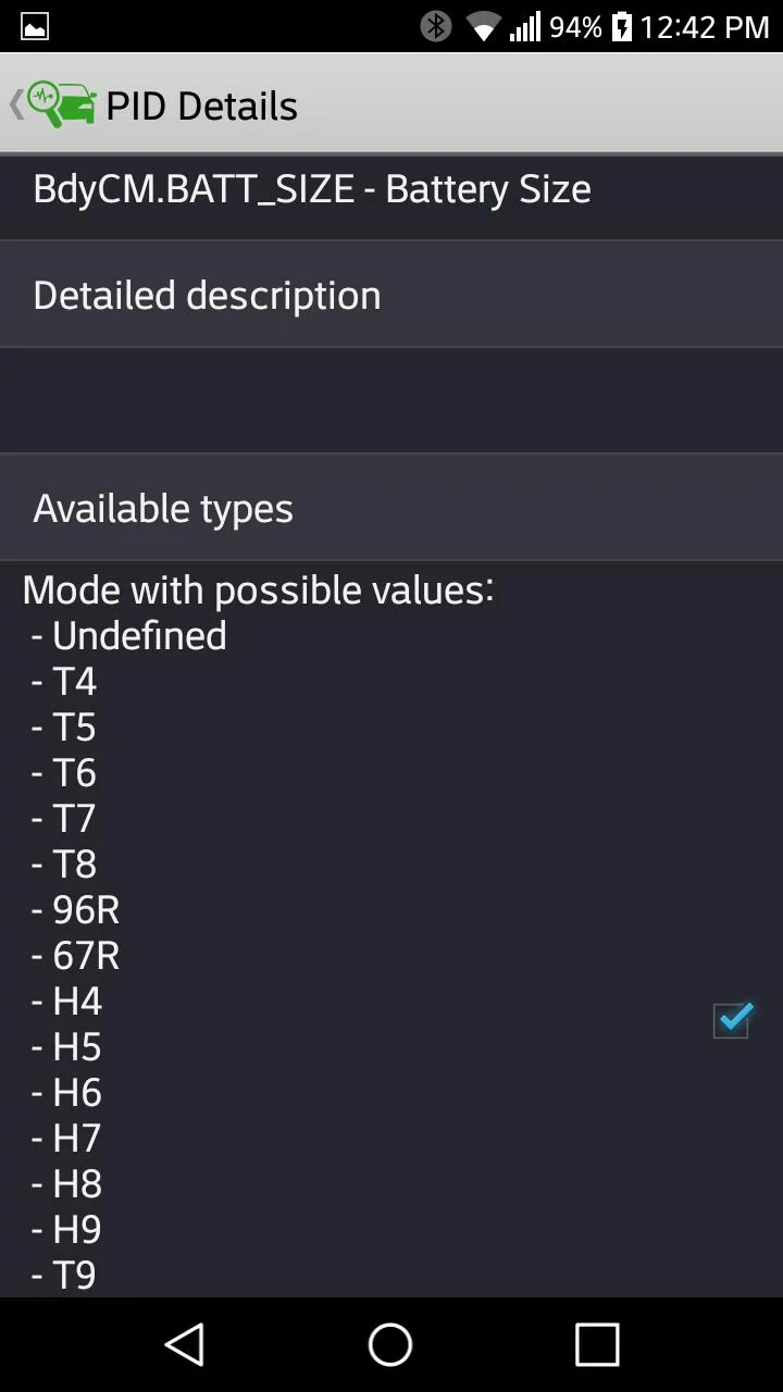

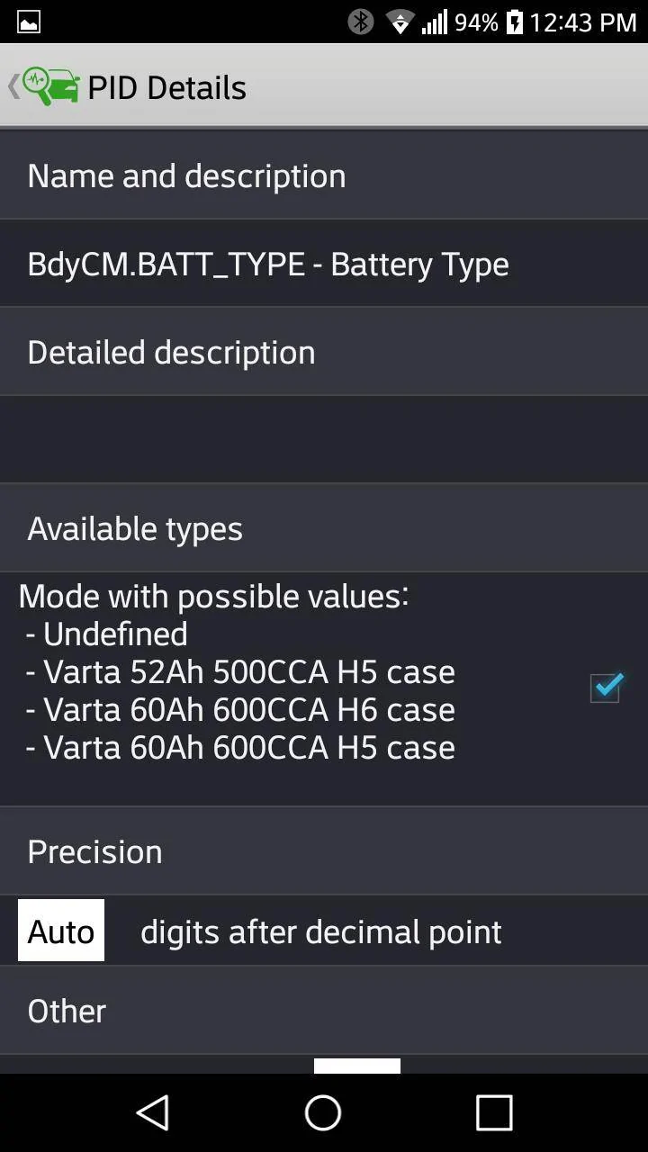

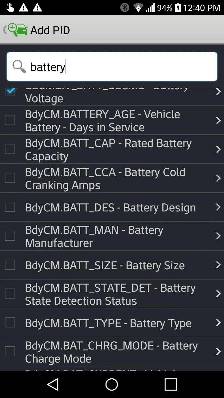

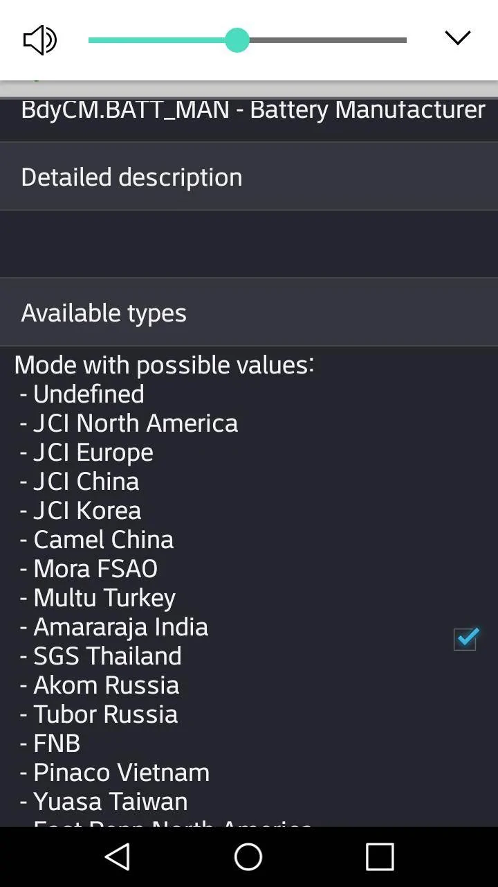

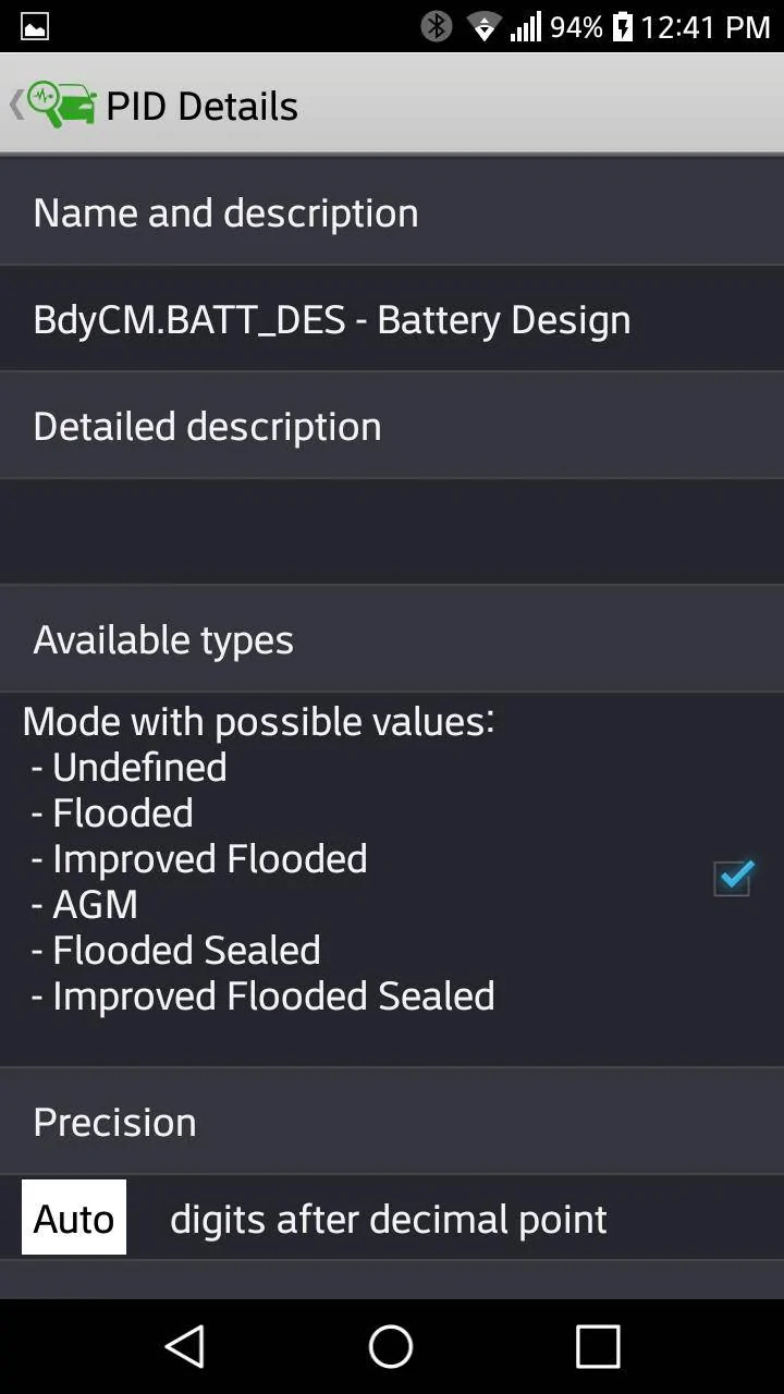

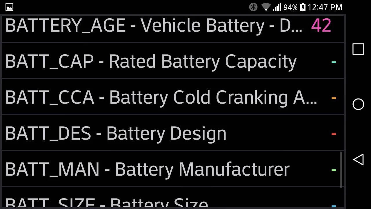

Here's some PID's with settings or values for Maverick that I'm thinking don't matter - IE value not used elsewhere if even stored. I'm thinking some of these likely came with code already written so they just kept them, and only use what they want. Or they forgot to access it.
But the module may store other info, much like the PCM logs seconds of engine idle time but not in a PID I can find.
2 of these do have values to display - Days in Service (or since last battery sensor reset in my pic, maybe not best to do that routine unless actually a new battery), and Battery Charge Mode - Standard.
I wonder if an algorithm uses that days of service...
Battery Capacity & CCA holds a value - but mine had no values so must not be used.
The check marks are in the middle of the options - not selecting an option - why I think it's not used on actual display of values.
