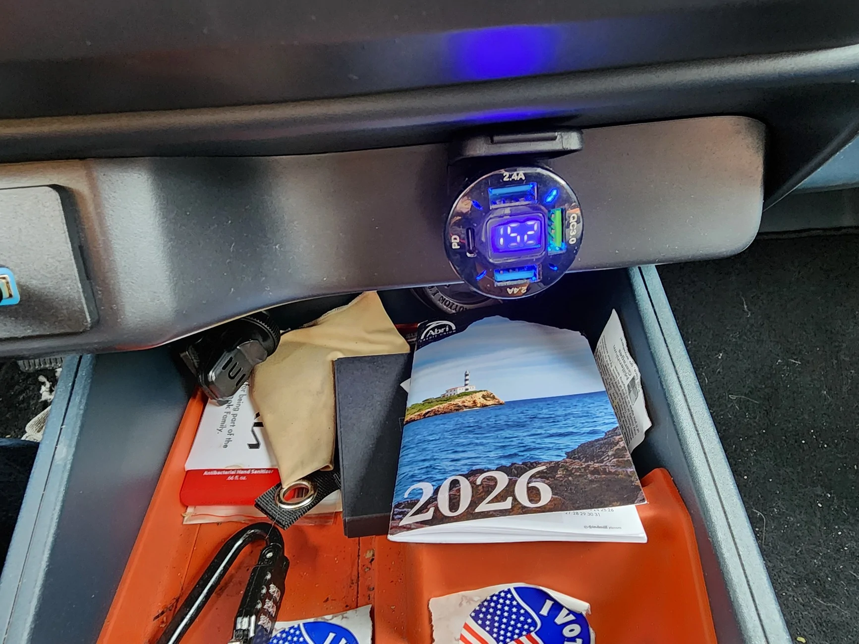

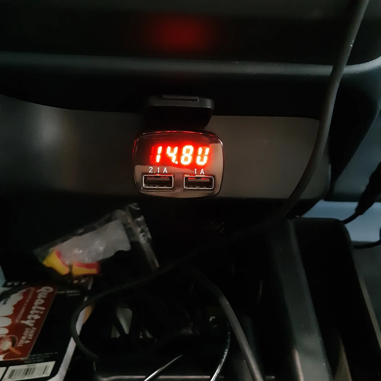

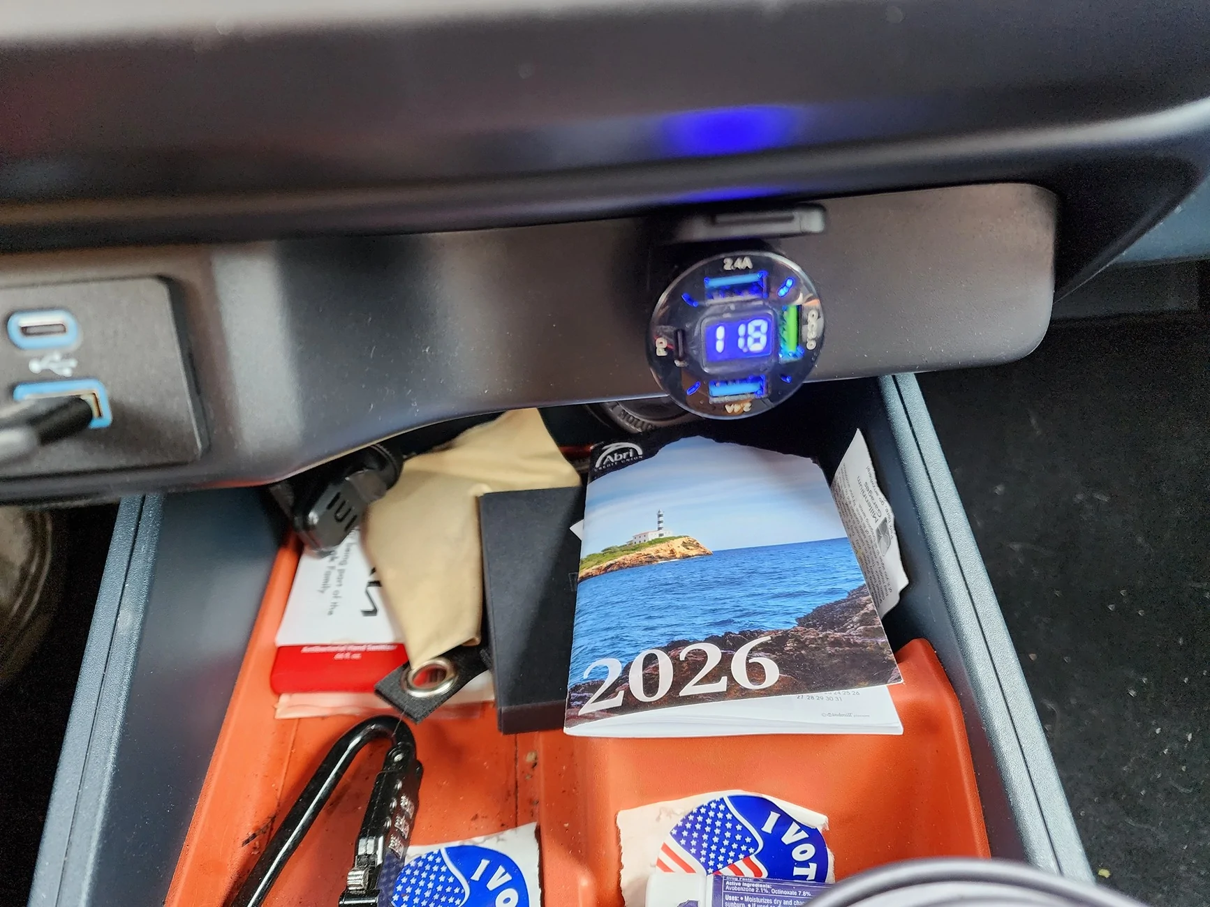

I leave my Mav parked 2-3 weeks in summertime and have had zero problems. How do you monitor battery charge? I have a voltmeter in the cigarette lighter socket and it's been steady at 15.2v driving and 11.8v sitting with the ignition on.
With the vehicle on you should be seeing more than 11.8 volts.

Thank you for posting that picture.
I know they're not highly scientific instruments but I get 14.8 to 15.2 on mine while driving.
I know they're not highly scientific instruments but I get 14.8 to 15.2 on mine.
That is not a picture from me. Not sure who you were meaning to reply to. I monitor our voltages with a logging device (Ancel BM200) on the battery itself.
Gary,
You're right I meant to quote TimothyD.
I'll edit it.
Actually I'm glad I made the mistake otherwise I would have never known about the Ancel BM200
Just the ignition is on so the battery has a load on it. When the ICE runs it goes up to over 15v. I think if I tested the battery by itself it would be over 12v. That's why I asked how they test the battery.
