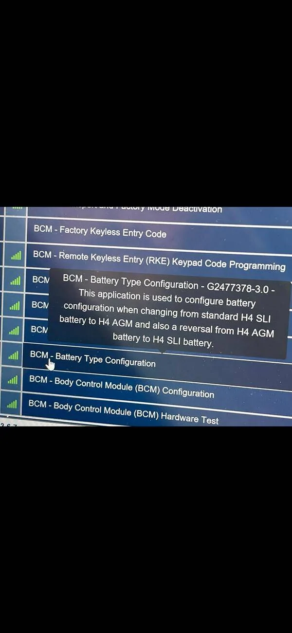

The EB's are already programmed that way since they were intended to come with AGMs - except that short production run that is now under a recall to replace to AGM's.
ETA: I guess it's possible you could be parking in garage unlocked since you brought it back.
So perhaps it would be a good idea to charge it up, then do the correct process locked overnight.
Besides - it's a user replaceable service item, so there wouldn't be a setting unavailable to reach by the user that was required.
Comment above is from Hybrid owner, probably didn't catch this thread is mainly about EB's.

Fear not!
