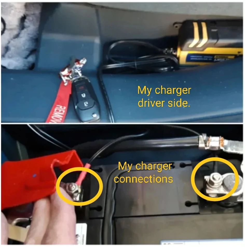

I wonder if the way I have my charger hooked up makes a difference. I have my charger hooked up directly to the battery.
It's been hooked up like this now going on 2 years.
Do I get a better charge, without the possible resistance of hooking it up under the hood 🤷🏻‍♂️
The two times that I've had to charge my battery, was while telemetrics fuse 11/12 was installed.
I'm sure the Noco charger is reading resistance as part of it's decision for the desulf routine - you may be getting a truer desulf because it sees just what the battery has for resistance without the shunt in there. Probably a good thing!
Great post,
How often do you plug in your hybrid?
From what its been showing on the forum, connecting to the battery instead of connecting to the ports under the hood removes the system of seeing you charging the battery, and may give the system a false reading for soc.
But I also read when the truck is off the system doesn't keep track of current going in if you use the ports under the hood.
So far I have not done that test yet.
As for getting a better charge this way, i doubt it, the voltage drop is negotiable since your current may be about 1-2 amps.
Hey if this works for you, go for it.

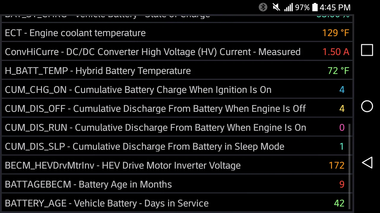

The simple BMS system is tracking cumulative charge when Ignition is ON.
That's the only tracking for charging.
Would be interesting if you could charge with system ON while it's doing it's own charging from the HVB also (it would probably stop though once it saw charge going in). Don't most chargers state turn vehicle off, for a reason? Some even say remove from vehicle.
BMS sees nothing of external charging if it's OFF.
Which makes sense actually.
Because it also tracks all the discharging times - Engine off, Engine on, Sleep mode.
I've not found any others looking at all the BCM PIDs.
It's attempting to match those up - charge as much as it discharges.
If it logged external charging - which we do because it is doing a poor job with matching those up (or old battery) - then it would just back off it's normal charging amounts to get it matched again.
Which would then require more external charging. Vicious loop there.
@johnDeere - I'm wondering if you are getting something very different in your system readings, not because of Forscan changes, but because you have 2 deep cycle batteries attached. Right?
At least 1.
Be interesting to see what the BMS Relearn thinks of your battery, what Ah it's assigning, and max.
Actually proving the system seems to have some ability is what your's does when it thinks the battery is topped off, only seen that 3-4 times, after recharging, and a new battery.
12.8 V, and that's when I've actually seen discharge from battery, not charging.
That's fits the tracker Cumulative Discharge Engine On or Off.

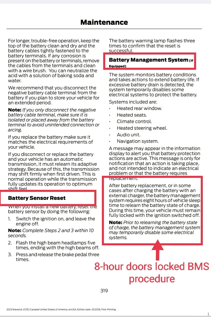

I guess we can comment on BMS, battery type, battery size, plug in chargers, SOC until were blue in the face, but the main problem and the reason for this thread is that what I am seeing is this battery drain when the key is turned off.
What is still on when we turn off the key and why.
Its not the fuse 11, I have it pulled.
Its not auto updates, I have it turned off,.
is it a current draw through the ACCM, I have that fuse pulled too.
I have power point time out set from (factory) of 4500 to 60 seconds.
I just checked the 120V outlet behind the seat, and when I turn off the truck, it powers down, with no delay.
Its just hard to recover this current drain when you only drive for 15 minutes per key on-off cycle.
