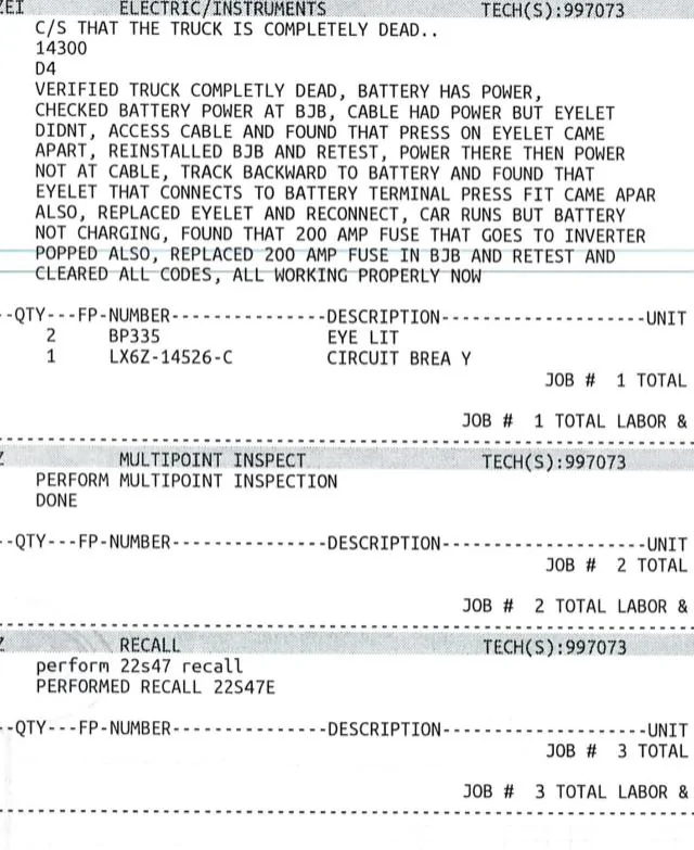

Yes!!!!!! documented AMP rate on inverter to 12v
200A
thanks poster that had been a unknown.

Wife's 8 month old Maverick with 6k? miles died in a parking lot last Tuesday. Dealer wouldn't pay for towing; said they couldn't service it for a week (today); said they didn't have a loaner. Today they said it needs a new wiring harness and those are backordered with supply chain issues, and couldn't give a foreseeable repair date. To say I am unhappy is an understatement.
If you search the website there's a video of the battery cable terminal that is at fault, You could take to a reputable repair shop and get it fit in a day, You would have to check with dealer to see if any problems with your warranty
