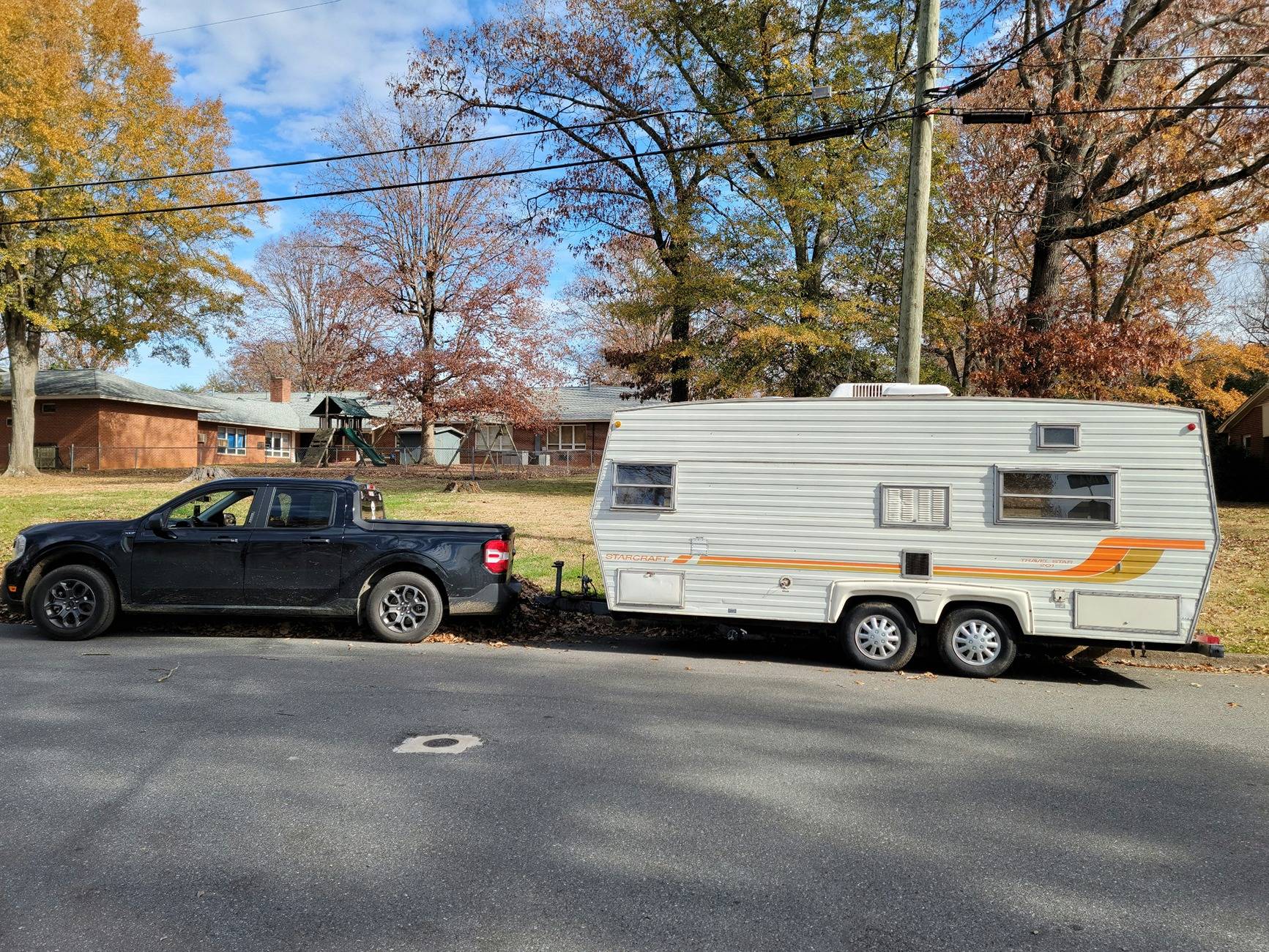

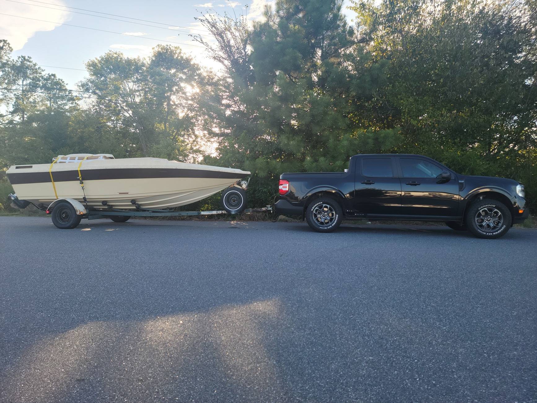

I towed a 3780# travel trailer 1100 miles (from southwestern NC to Houston, TX) with mine in stock form at 65 mph averaging 15mpgs. Then after a lift and 265/65/17s I towed a boat a little farther, I didn't weigh it, but I think it is a coincidence your axle failed at this point.
Those raised Whites on Black do look guud!

Glad you have had no problems. I’ve had the boots replaced once after they started leaking and then the axle replaced just last week on this trip I took from San Antonio area to Colorado.
Am I seeing a lift/leveling kit? The front end looks a bit high,,,,,,
Raised white letters were a requirement after the lift. It is also good that I was I was able to find some that weighed 40#. The downside is I now have 45k and need the passenger axel. I am going to ask if a dealer will cover it under warranty, but I'm not too optimistic on that. I did find I can order the axle online from a dealer in Florida for about $115.00
