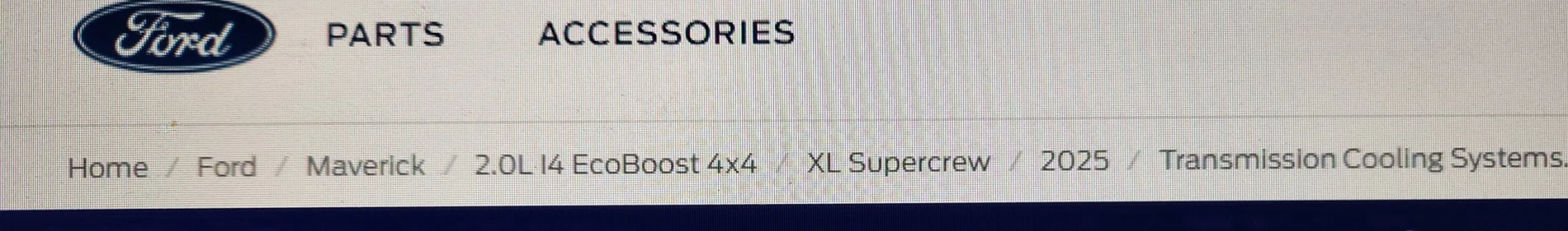

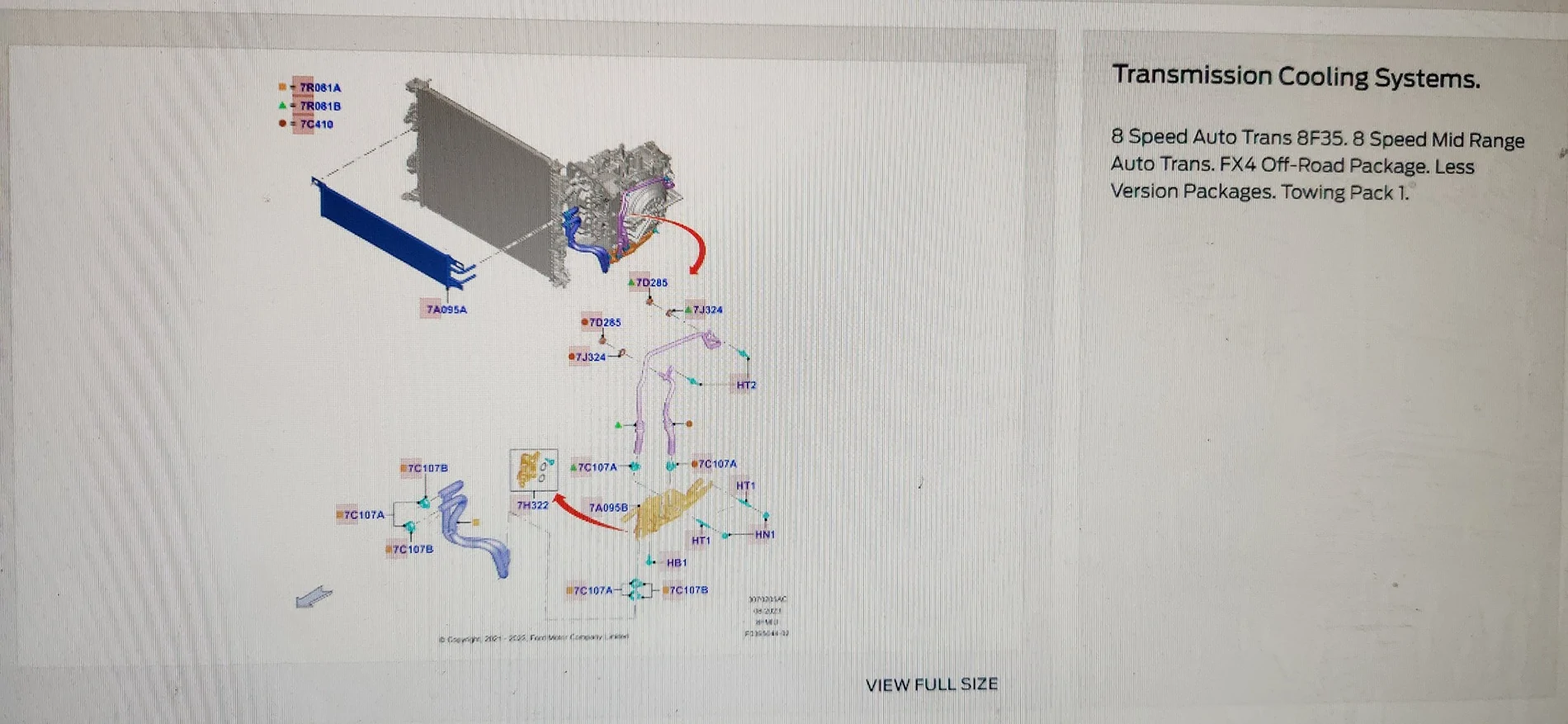

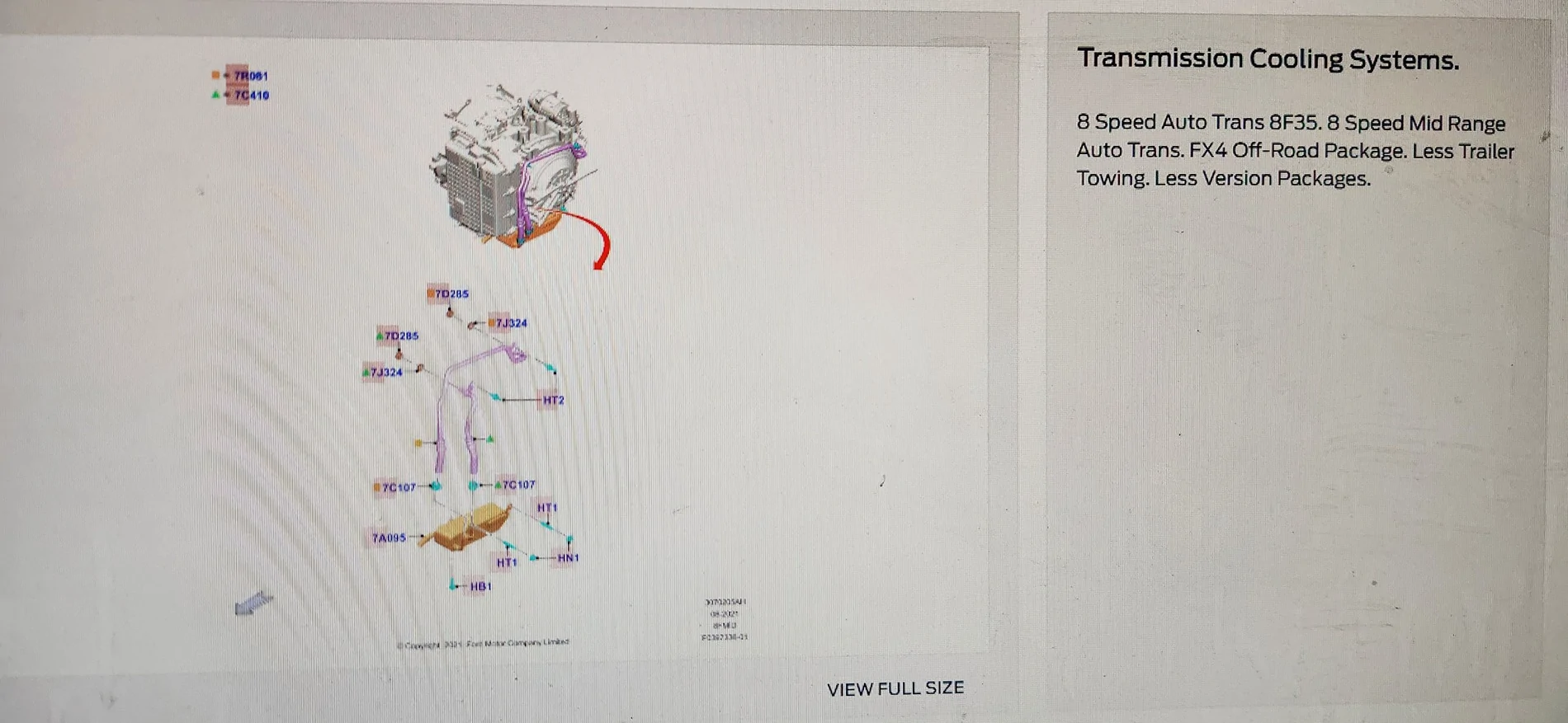

*update*
I was questioning why my 4k towing 2025 didnt have the auxiliary transmission cooler.....I was told ford modifys options based on the delivered climate.....region. The dealer looked up my build sheet and the AuX Trans Cooler was checked - "not installed"

WISCONSIN. that was the only reason the dealer could think of as to why it wasnt installed. Some notes in parts say different climates

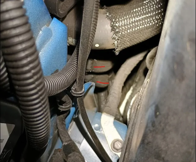

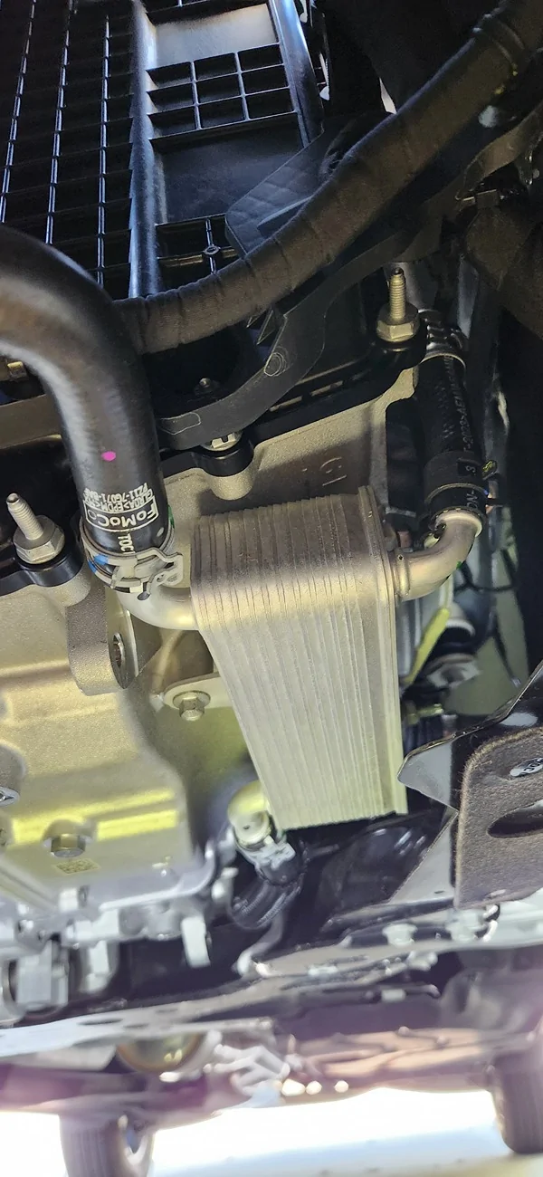

I was under the assumption the 4k towing had two transmission coolers. One smaller heat exchanger mounted on the transmission and an air cooled cooler mounted on the front radiator. I checked my new 2025 2.0, awd and I only have the cooler mounted on the transmission.
The 53Q option states...Aux auto Trans cooler.

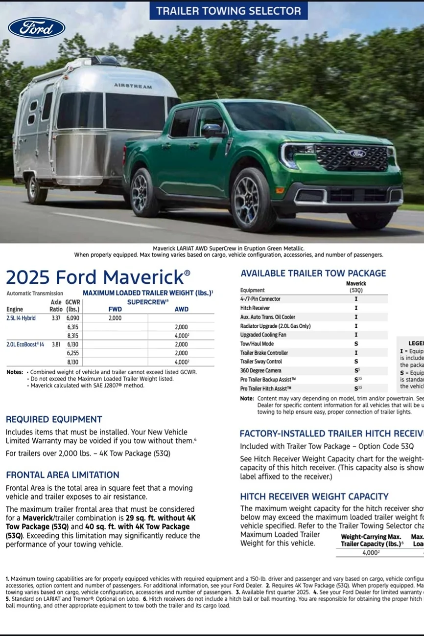

Not sure were you got this info from but the only document that should be held with any clout is the order guide.
The 2025 XL with 4K tow does not come with an auxiliary trans oil cooler just that is has one.

Not sure what you expect me to do about it. I'm just letting you know that according to the order guide the 4K tow package does not come with an secondary trans cooler.
My 2022 XLT is equipped with the 4K tow package and the order guide from way back then mentions nothing about it. Just that is has a single trans cooler.

Only Hybrid 4K has the auxiliary cooler.

case closed thanks. 2nd dealer just called and said no 2nd cooler for 2025 EB.
Glad to hear the second dealer confirmed what I already posted.
