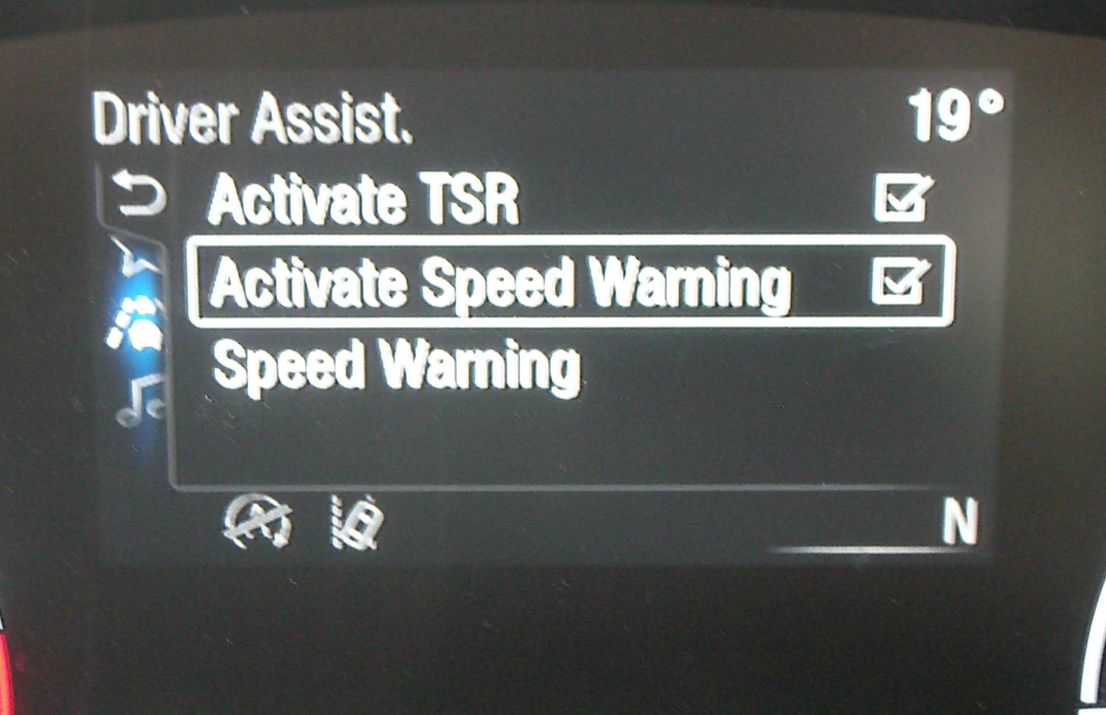

Got this working but don’t see all the other options others have, just these.
I don’t want anything beeping or going crazy if I happen to accidentally exceed the speed limit going down hill😉
Ford Maverick Traffic Sign Recognition (TSR) FORScan mod (confirmed working) IMG_3088
Ford Maverick Traffic Sign Recognition (TSR) FORScan mod (confirmed working) IMG_3089
Automan21
Mel
Nov 30, 2023
1,065
927
CT
‘23 XLT Eco AWD 4K Tow

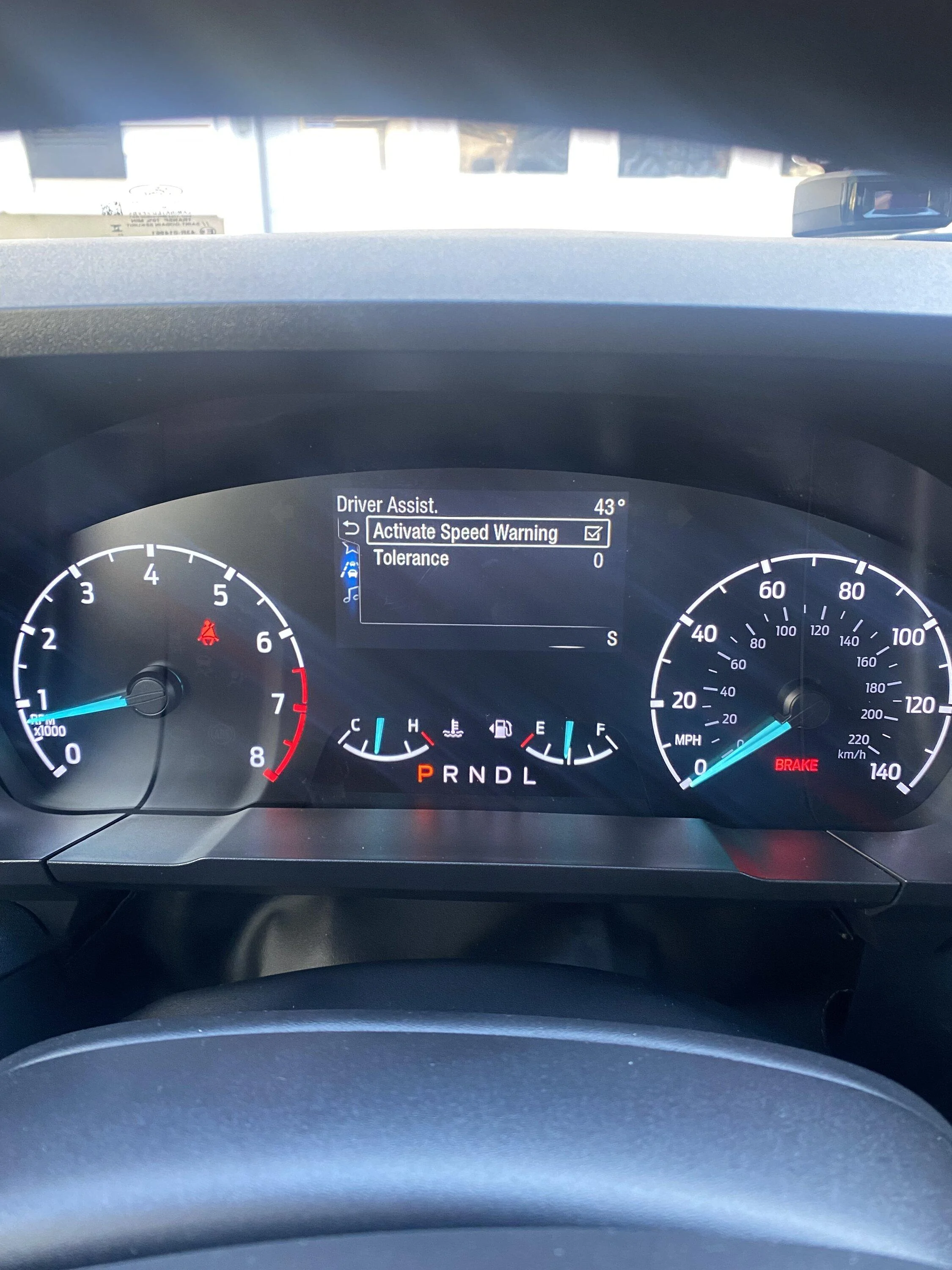

I don't have this one coming up. The activate TSR one.
Eventhough I got this to work at my first try at FORScan I hope I didn't mess anything up. I did use the easy mode to change things not the numbers way.

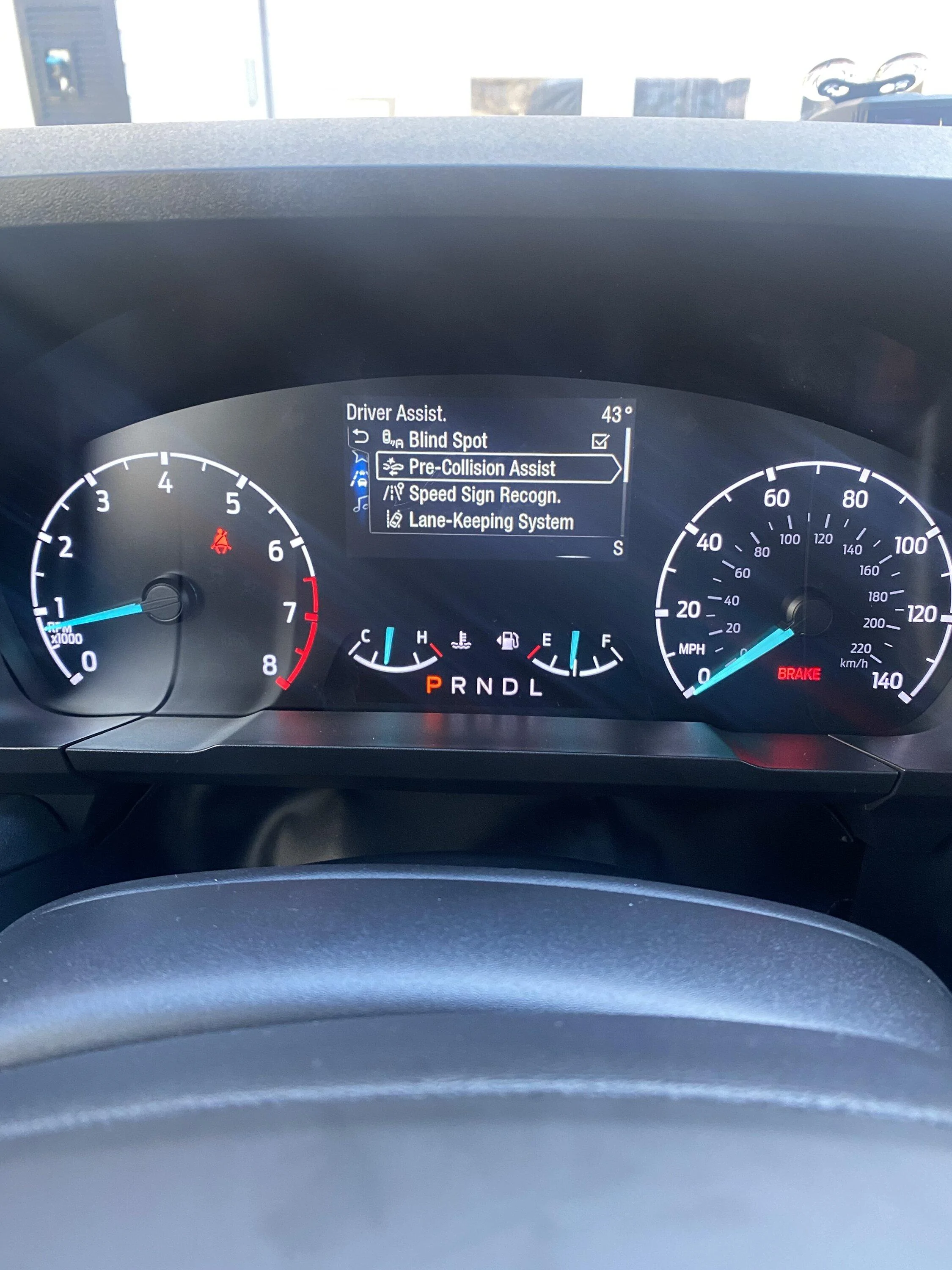

If you enable the TSR option in the IPC then the menu appears. You may not actually need to, though, as just enabling it in the IPMA will still allow the instrument cluster to start showing the sign indicator. Ironically that's actually one of the factors between getting the round signs and square signs in the Lariat cluster, it seems.

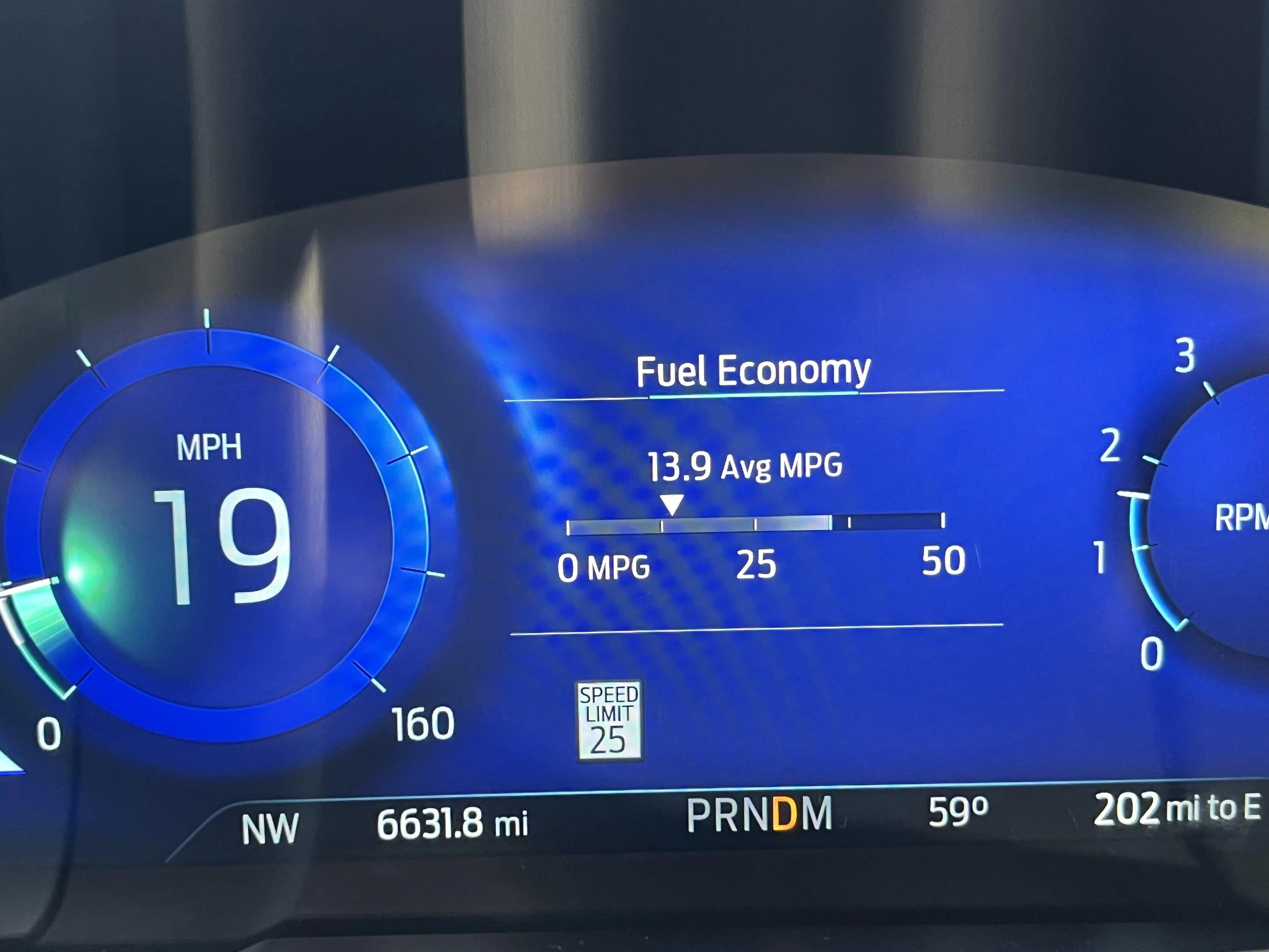

I have a '23 EB Lariat Lux FX4 Tow. I successfully enabled TSR in easy mode, but initially had the round signs (European?). When I changed the IPC to enable SLIF, the square signs (US) appeared as they should. See post #452 for the simplest of instructions, although I enabled the TSR in the IPC. This gives you the I/O option on the cluster (for Lariat's, at least).

Just want to say thanks. Tried this again this morning, after thinking it did not work to enable the US style speed limit signs on my 24 Lariat, and it worked perfectly. Very happy to have the square signs now, after trying before and thinking I was stuck with the Euro ones.
Thanks again to all who contribute!
