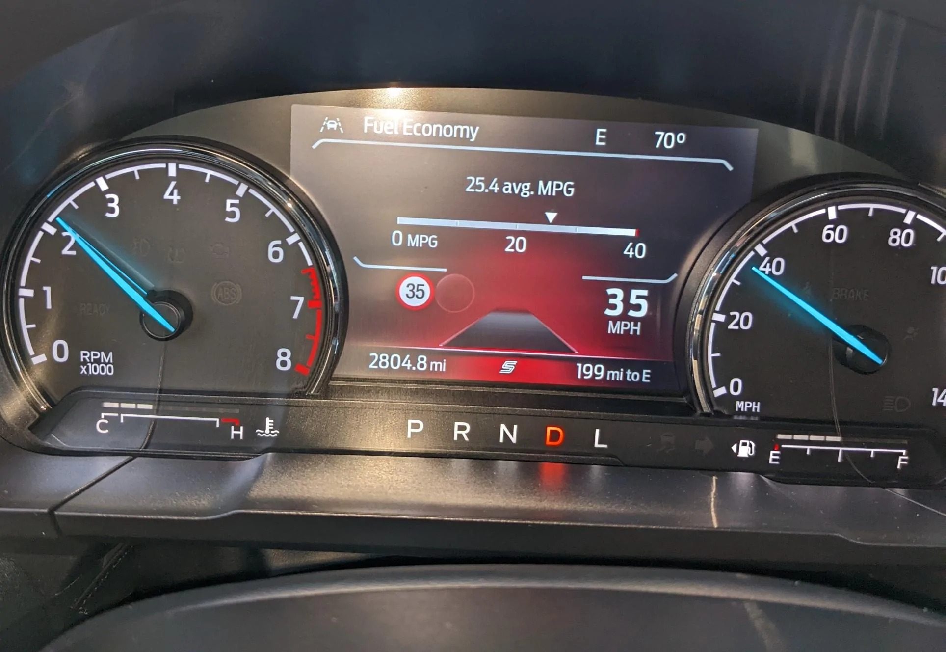

So I messed with this again today trying to just get the speed limit (left) circle to only show. With either SLOIF or SLIF both circles are still showing. Has anyone been able to get only the one (left) circle to show and not have the translucent (right) circle showing?
SLOIF (Speed Limit Overpass Information Function) aka speed limit and no passing sign
SLIF (Speed Limit Information Function) aka speed limit only sign recognition
Ford Maverick Traffic Sign Recognition (TSR) FORScan mod (confirmed working) PXL_20220321_000116641

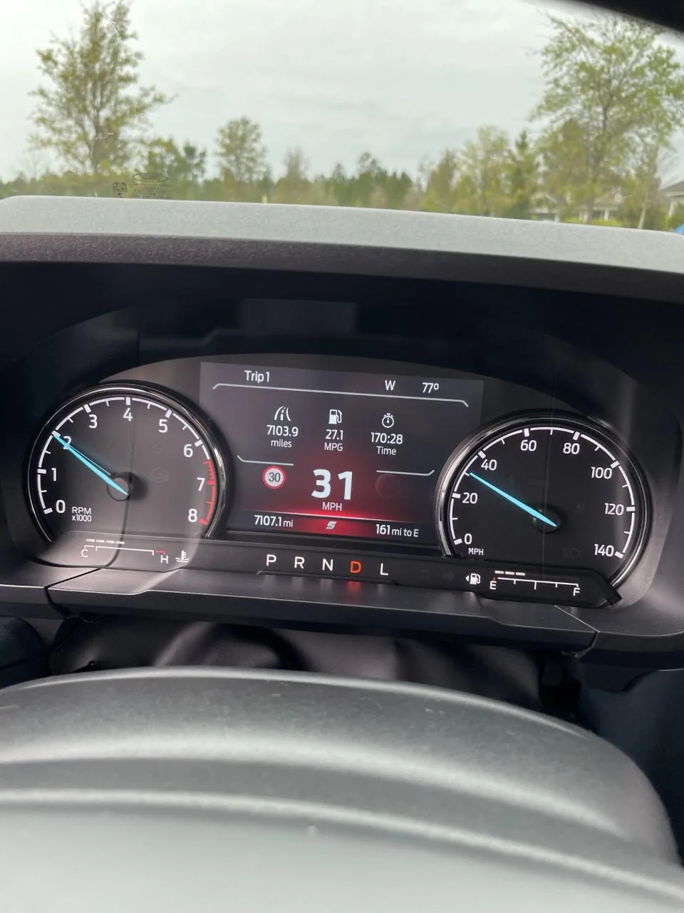

Just enabled it. Need the latest version of 2.3.47 March build if you want the easy modes.
Edit: tested and working! Perfect mod if you have teenage kids!
Ford Maverick Traffic Sign Recognition (TSR) FORScan mod (confirmed working) IMG_20220321_162646542

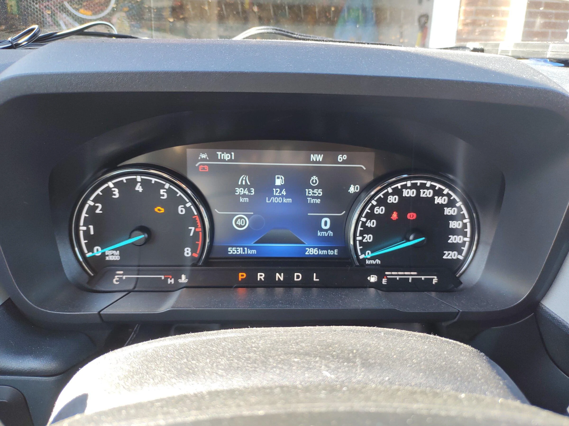

Hey guys, i was having trouble writing this mod until i installed this test version sent from Forscan
https://forscan.org/download/FORScanSetup2.3.47.test20220310.exe
(not sure if the link will work) but its a Test dated march 10th. Anyways easy mode is available for both IPC and IPMA modules. I'm not sure what the right "ghost" circle is supposed to show.
Truck is a 2.0 AWD FX4 4K
Using Surface Pro
Forscan 2.3.47 test20220310
Vgate vLinker FS
Ford Maverick Traffic Sign Recognition (TSR) FORScan mod (confirmed working) Dash

The right circle is for "no passing" signs. I'm not sure that there is a way to get rid of it. I have not figured it out yet.
