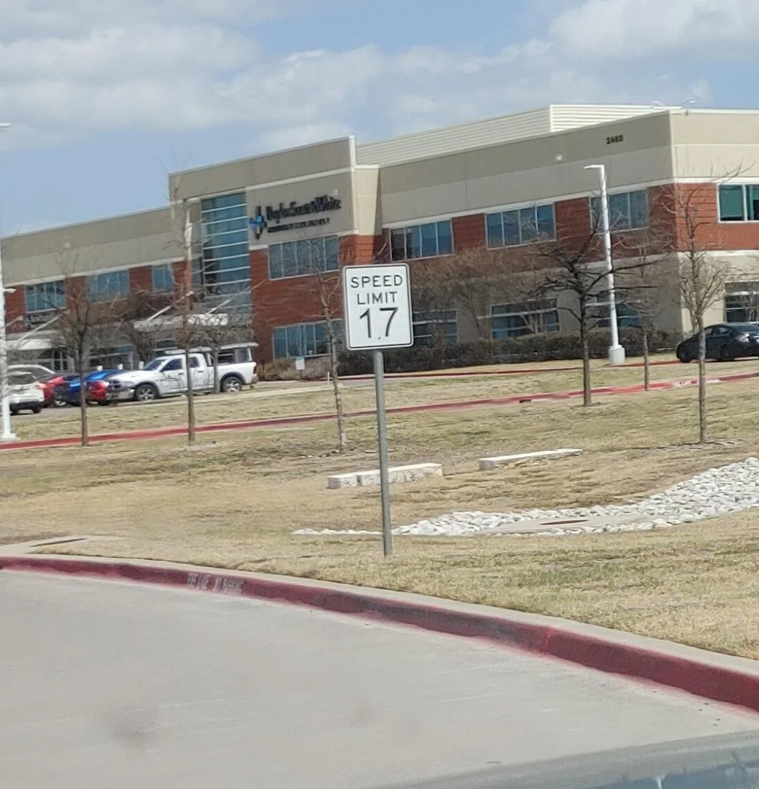

FYI, these signs don't get recognized.
Ford Maverick Traffic Sign Recognition (TSR) FORScan mod (confirmed working) edited_20220317_131041
