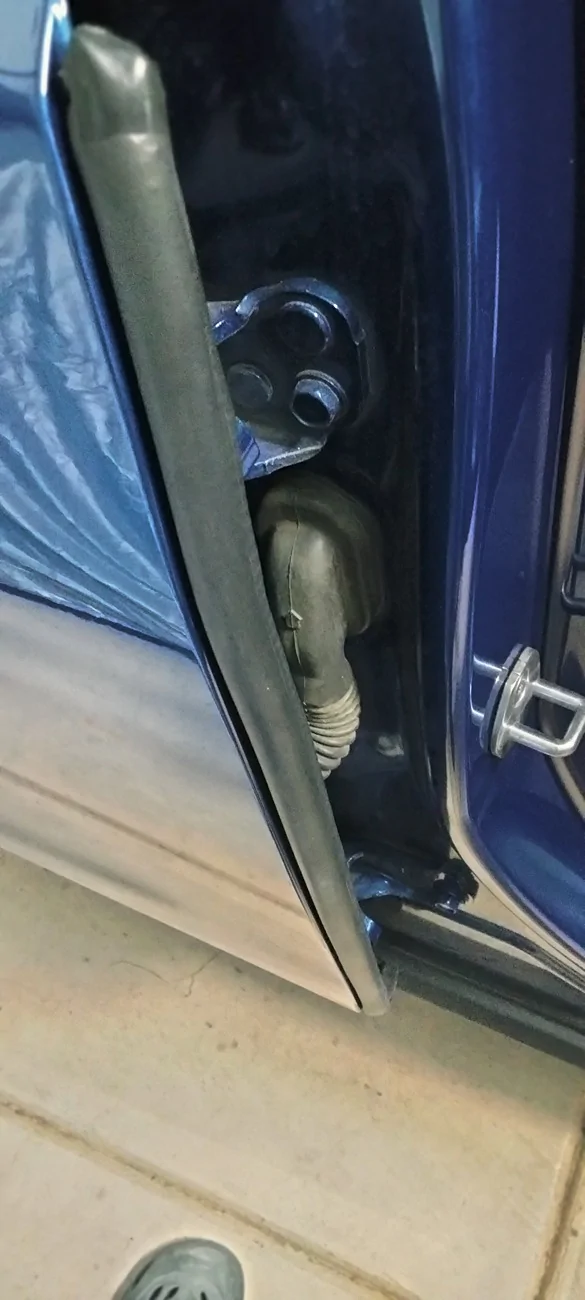

Amazon (The delivery, ad, ordering platform for small businesses) delivered today, couple days early. Here are the results. I got the door weather strip. It installs on the front edge of the rear doors. I hope it keeps out the dust.

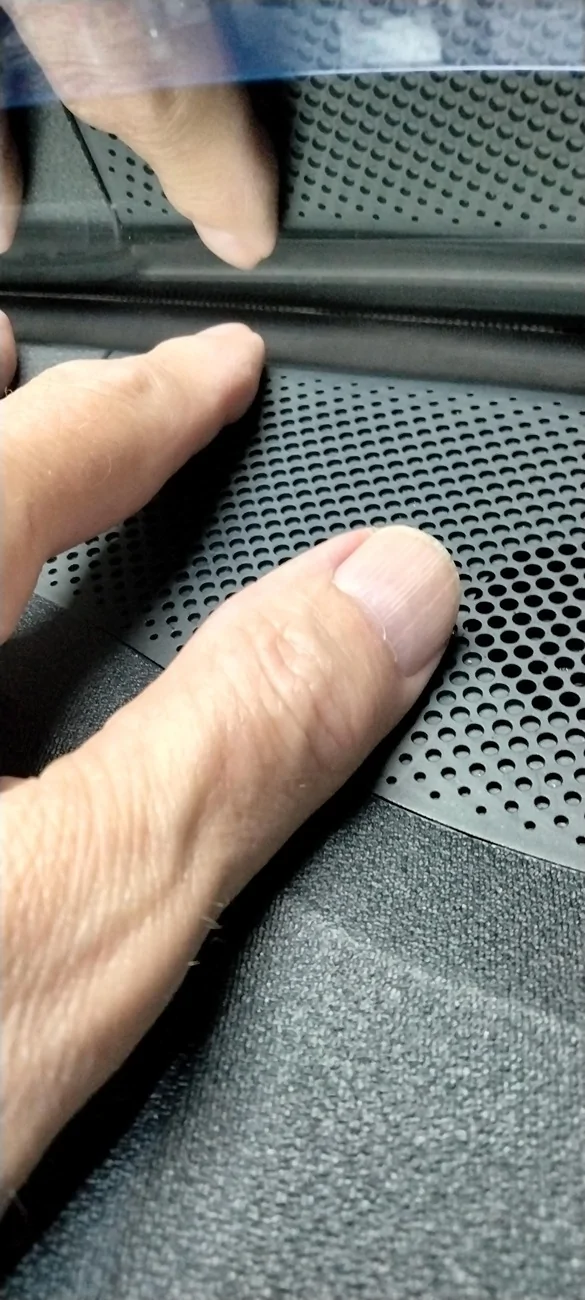

I installed the dash strip. You can not see it very well. It may keep stuff from sliding into that area.

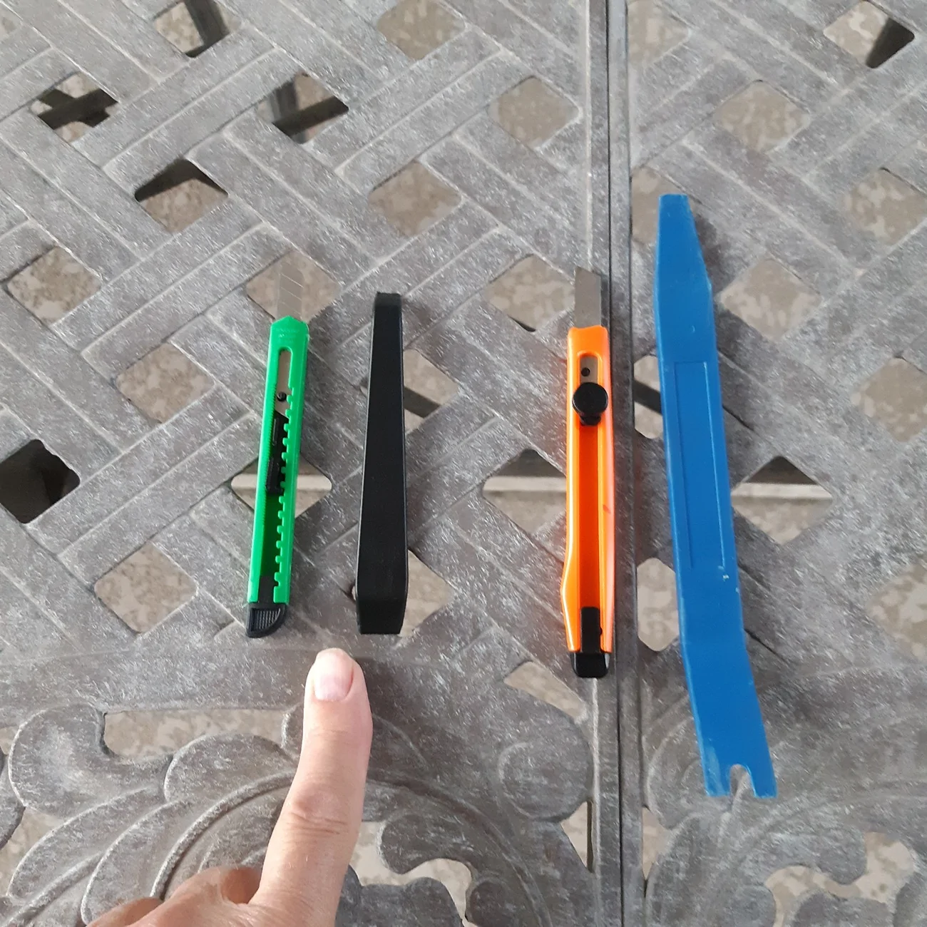

The dashboard sealer came with these mini tools👇👇

I grabbed one.
My thoughts are that it's not really big enough for the task. The crevice between the dash and windshield is quite deep, if you push it in as far as you can so it fills the void and stays put, it will be well past the dash plastics and not offer much compression to keep rattles and squeaks at bay. I'd consider stuffing in a backer rod first and then this rubber strip over top of that as it looks fairly nice when pressed in. I didn't bother trimming it, just pressed the overhang into the side pillar gaps.

Amazon delivered today, couple days early. Here are the results. I got the door weather strip. I hope it keeps out the dust. The dash weather strip you can't tell. The dash one is in there we'll see how it works on the passenger windshield vent rattle.
Looks good. I hope they keep the dust and rattles at bay.

I grabbed one.
The backer rod idea is brilliant. If you try it, let us know what diameter works.

The problem with backer rod is it will disintegrate with exposure to heat and sun. Let me think, where is the most exposure to sun in my Maverick :idea: That is why it says for use to fill gaps to be caulked. I wouldn't want it turning into dust along my dash. I tired it to seal the gap on the bed rails under my cover. After 2 weeks it was starting to crumble.
I hadn't thought of that. Great point.

Yeah the kit came with what looked like a mini crowbar which I didn't use. Using my fingers was more than enough to get the job done to my satisfaction. Oh boy that sounds suggestive...
If I had pushed it any further down I would have been basically impossible to take off if I wanted to in the future.
Hmmm? Side affect of too much finger?
