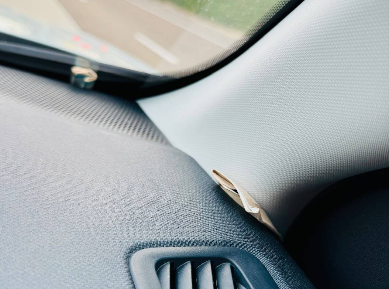

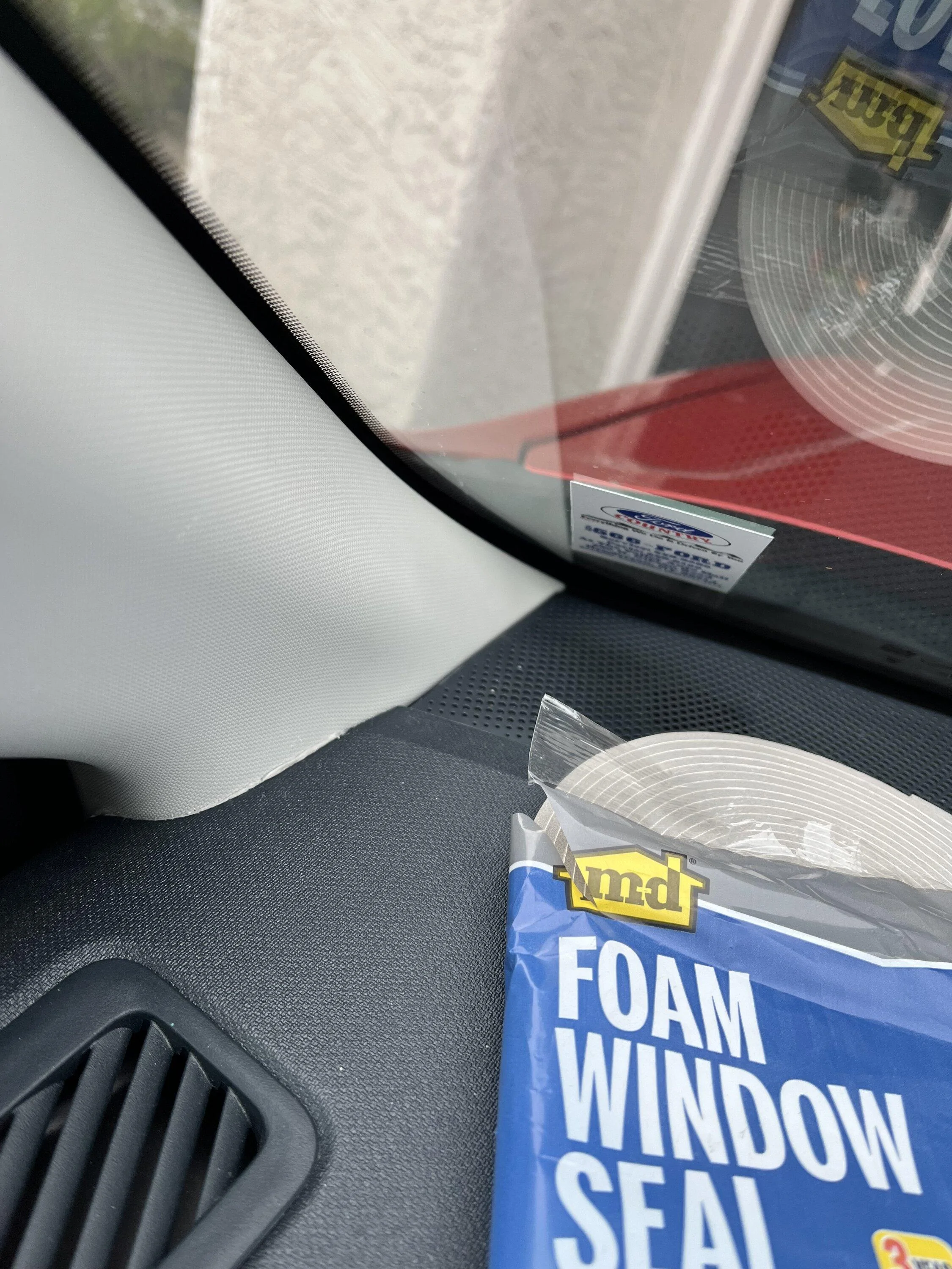

Hi, thanks for sharing your experience with this issue, do you mind share a photo of where exactly you have insert the foam, and did you insert the foam from the glove box or from the top? Thanks
AUTUS_FL
Paul
Oct 1, 2021
141
197
Saint Cloud, FL
2022 FORD MAVERICK XLT HYBRD;2021 HONDA REBEL 1100
Hi, sure thing. I tucked the foam in at the top between the windshield and the dashboard using the auto trim removal tool kit, on both sides(passenger side rattle noises was more critical). See photo attached
Hope this helps!
