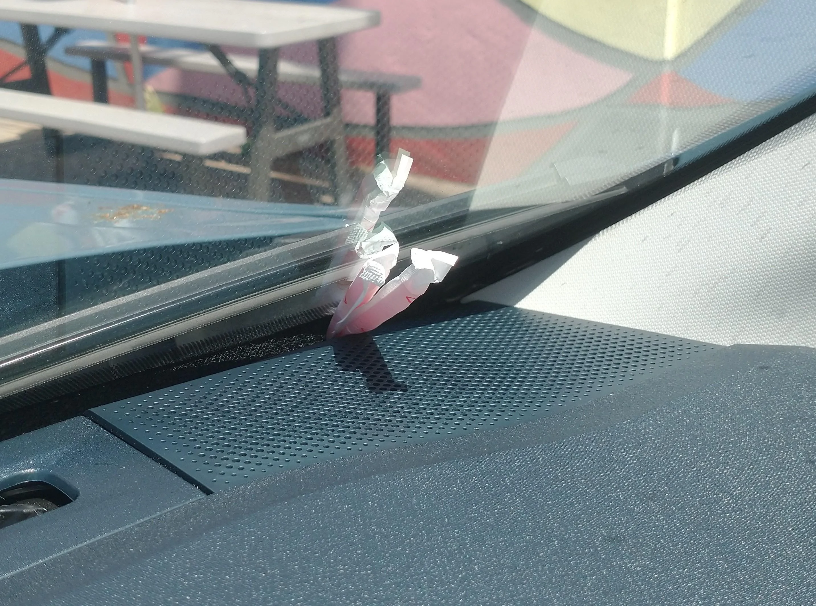

I finally isolated my dash rattle and fixed it, without tools in less than 1 minute. And it cost absolutely nothing!
Now that I know how to do it, I'm going to get more straws.
Really though, it will inform now where I put extra foam pieces between the dash and the windshield to create a little bit of a binding effect.
It looks like your "sounds" are coming from the passenger side? My sound which is more of a jittering sound than a rattle are straight ahead on the driver's side. So, inspired by your straws, I used a piece of foam and stuffed it between the dash cover and windshield. It solved the problem 95% but if the pavement is washboard, there is still some noise. My theory is the noise is the dash cover vibrating against the defrost duct that connects to the underside of the defrost outlet just below the windshield. I'm going to stuff something into the holes in the duct to see if I can cushion the duct. I am scrounging for medium density foam from packing material. I doubt I can get my fingers into that area from under the dash so I am focused on trying from above.

Mine seems to come and go with outside temperature. When its warm/hot, I don't hear a rattle. I live in SoCal so it is warm most of the year. These rattles can drive you nuts for sure. I will keep searching for a solution.

I have the dreaded dash/windshield rattle as well. Got really bad in the recent cold snap. Planning to shove some sound deadening foam pieces between the speaker cover and glass to see if that helps.
