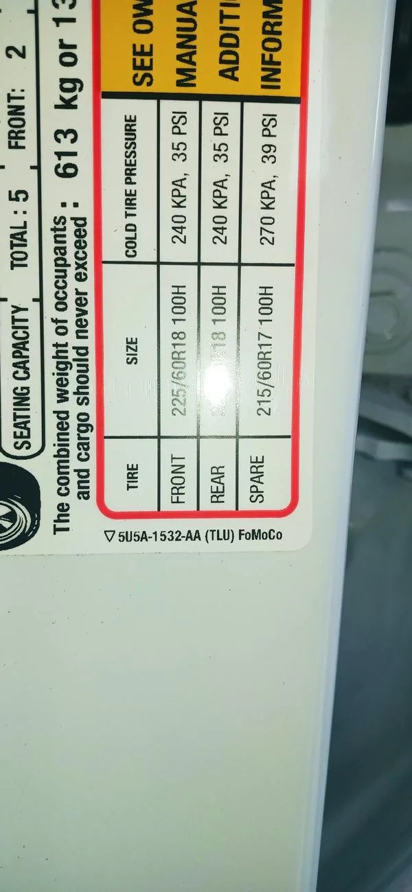

So what's the actual size of the rim that comes with the fake full size tire ? I'm looking to mount a 245/65 on it. Thx
Ford Maverick Spare Tire Wisdom 20240707_184352
The "fake" full size spare is actually 215/60/17. Your tire might fit the wheel, but I suspect it would ware unevenly if used any length of time.

Not sure that is the “fake full size” he’s talking about; that looks like the temporary spare.
The 17” diameter rim is probably consistent across all truck spares, but the rim for the T155 spare on your image is significantly skinnier than the usual stock rim width. Likewise, that T155 tire is nearly 3” skinnier than the OEM front/rear tires shown.

You are correct, my bad on that one. @Waterick has the correct size on the sticker.

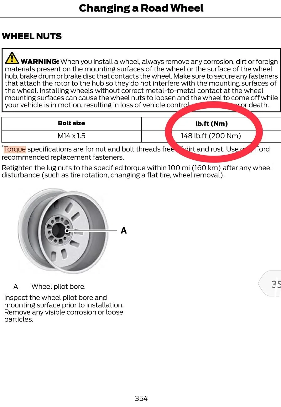

So I should get a spare breaker bar, just for changing the spare. I think I saw somewhere the torque was 100ft/lbs if I remember correctly
148/lbs
The spare rim is the same 17X7 steelie from the XL- Should be fine if its balanced.

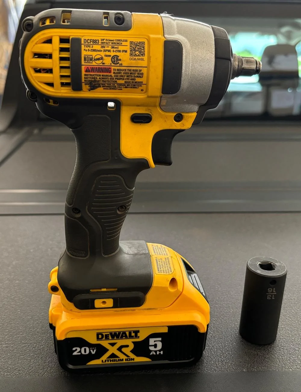

Here's what I use. Best tool investment I ever made. Portable, lightweight, only goes to 150#. Makes changing tires/rotating much easier.

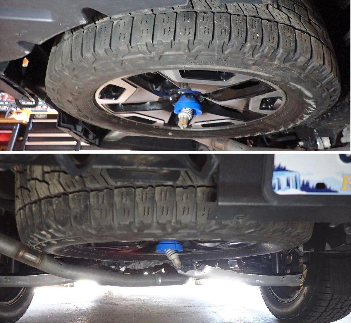

First thing I did is get a matching full size wheel w/TPMS sensor and matching tire and ditched the doughnut Ford provided. A Falken 235/60/R18 fits with a little room to spare. A breaker bar with deep sockets is a good thing to carry also. Good practice for when I need to do it on the road.
Does the outside part of the wheel have to face down? Or is there a way to mount it up to protect it from road debris?
