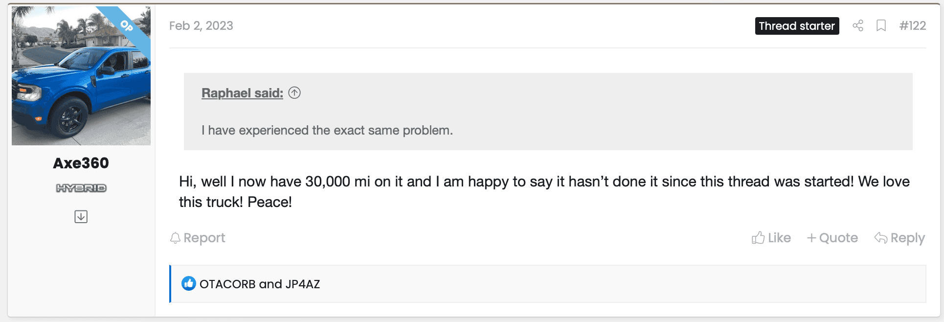

I USED to have the shudder occasionally switching between the Engine and Electric Motor. Particularly when the engine isn't warmed up.. But it seems once I'd had racked up more miles on my truck it disappeared. Maybe something settled in and resolved itself? I'm at 16k miles and my truck is 1.1 Years of age.
Same with this other member
Ford Maverick Shuddering Hybrid Screenshot 2023-03-08 at 7.31.19 PM
