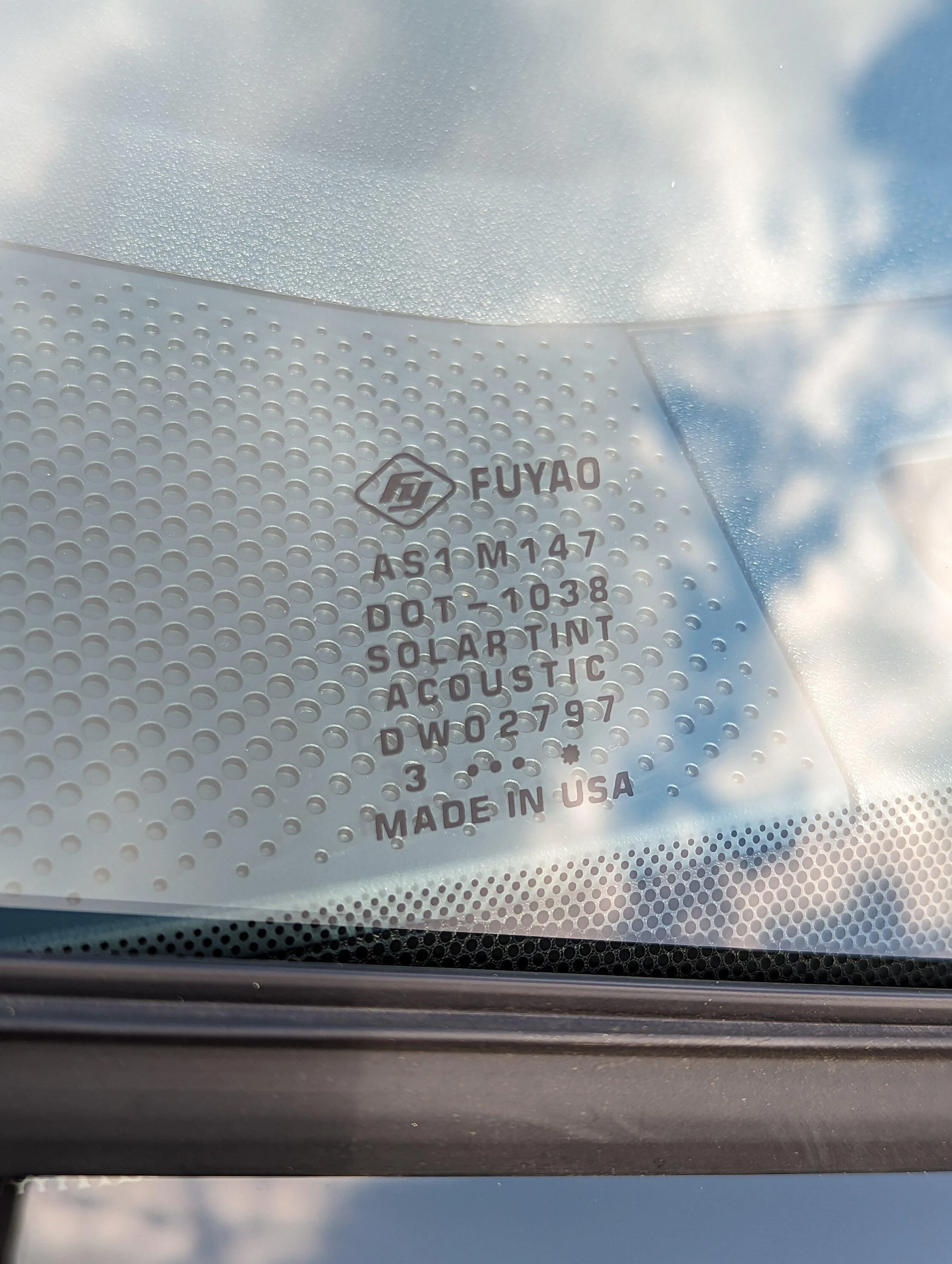

I had this rattle. I also just had my windshield replaced by Safelite. I intentionally did NOT get the OEM windshield. I got an OEE one instead. It is acoustic and solar coated which is a nice upgrade from the stock XLT. It also does not come with the alignment pins. I think that is why some have the rattle return with an OEM replacement, but less so with the OEE. Here is the windshield part number.
Ford Maverick Rattle in the dash (a minor yet major annoyance) PXL_20230908_190644401
I drive it for a week and report back if the rattle has returned.
Update: It's been over a week and the rattle is gone. Other more minor and lower pitch rattles have emerged though.
Did the acoustic glass make a difference in terms of interior noise? I was thinking about trying to get either the Lariat's acoustic glass or the Safelite version. How much extra was it?
ejouie
Evan
Sep 21, 2022
379
476
Newnan, GA
'23 Ford Maverick, Atlas Blue, FWD, EcoBoost, XLT
It dropped the average dB from 73.1 to 72.6.
I don't think there was any extra charge. It was still my glass deductible.
