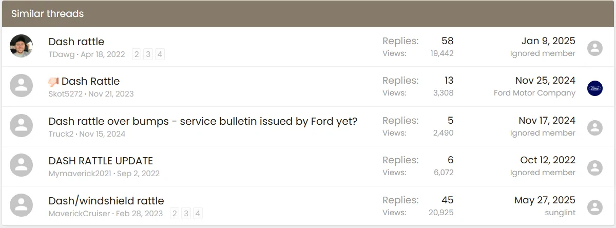

Scroll down, and one of these is bound to have a solution as applied by one of our forum members...
Ford Maverick Rattle in the dash (a minor yet major annoyance) 1767967674297-yi
