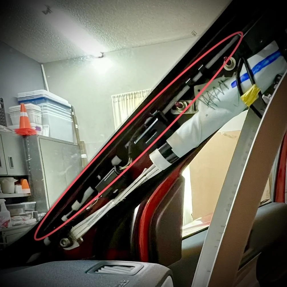

If pins are removed and rattle remains, double check exhaust tubing for side curtain air bag…might be tapping against the A-pillar metal.
