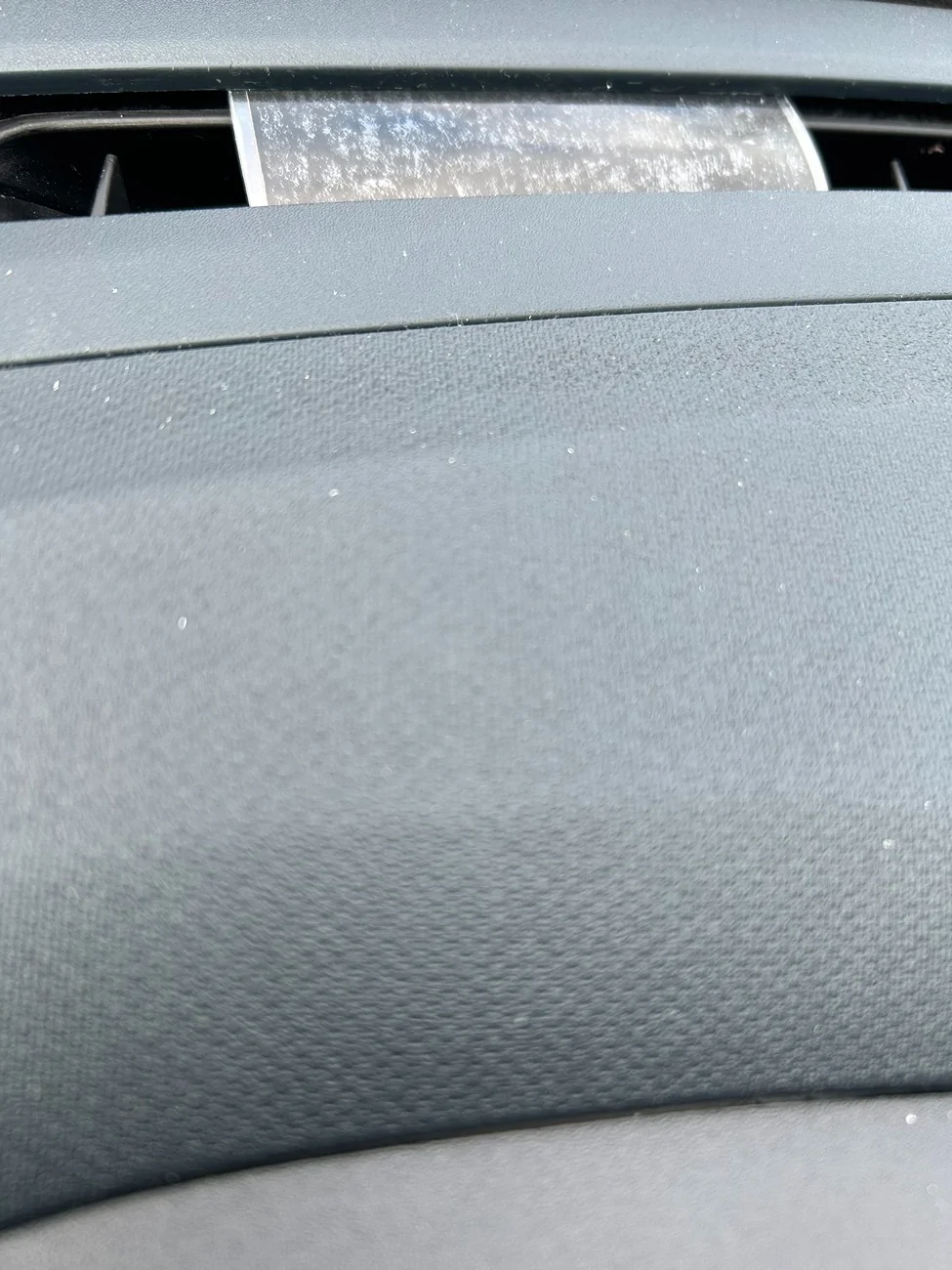

That would be great to see. Thank you.
The Mylar makes it appear shiny in the pic (though I don't notice it at all), black duct tape would get rid of that if it bothered you. I used it to thicken the cardboard, so it wouldn't move around or slide down.
I just folded it over between the vent and the plastics on each side and this particular rattle went away.
EDIT - maybe small half round molding, with a slit, would do the same but look better...
