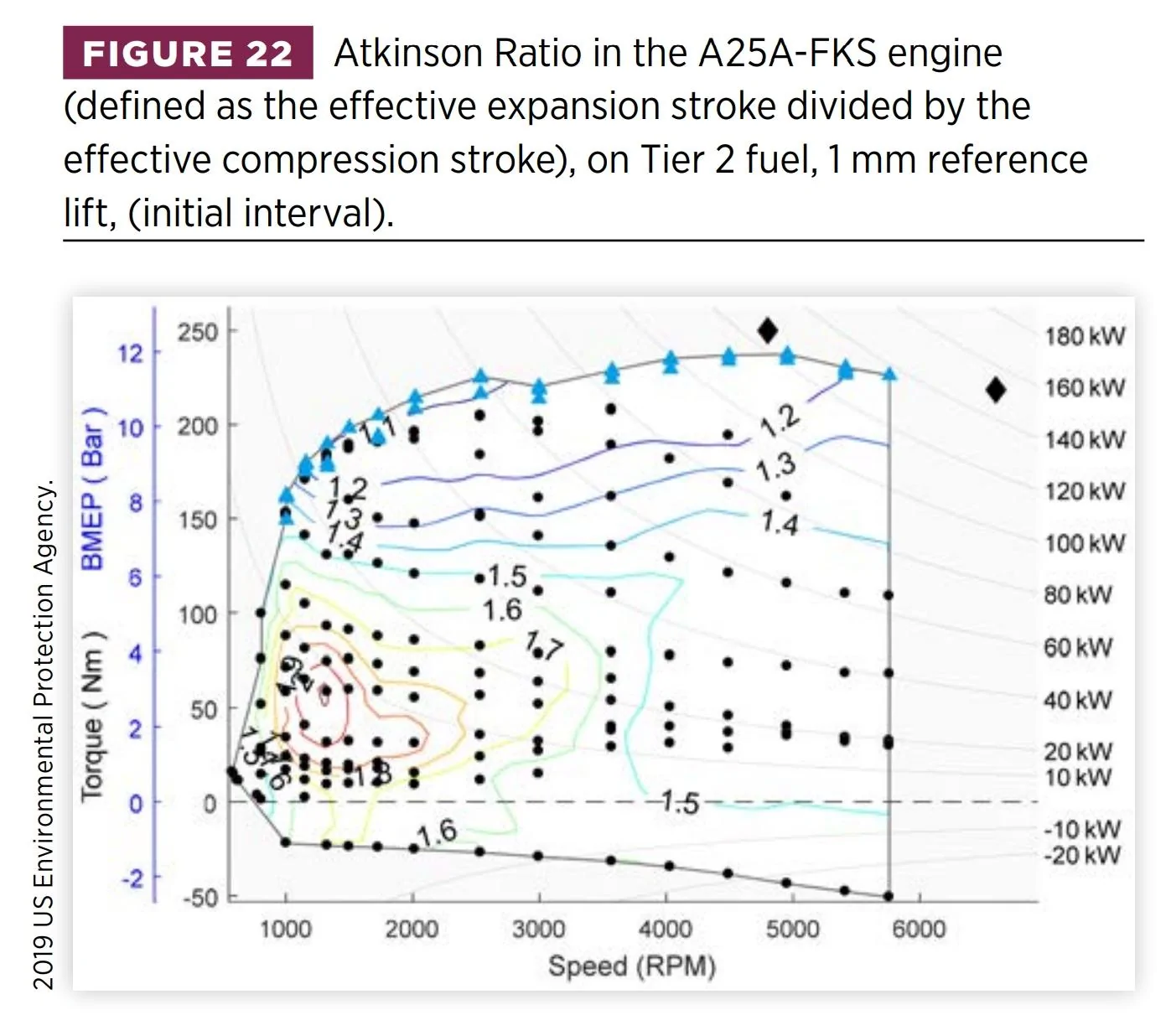

According to the specs the 2.5l hybrid is 13:1 compression ratio.
The effective compression ratio is much less since we are not comparing Otto engines now. Atkinson cycle engines perform slightly different in that you actually have flow reversion out the intake since the intake valves are still open during the compression stroke.
Yes, though that is really because the air is still moving and has a pressure wave. Once the compression stroke starts, the intake only remains open as long as manifold pressure at the valve is greater than the pressure of the cylinder (very simple understanding version)

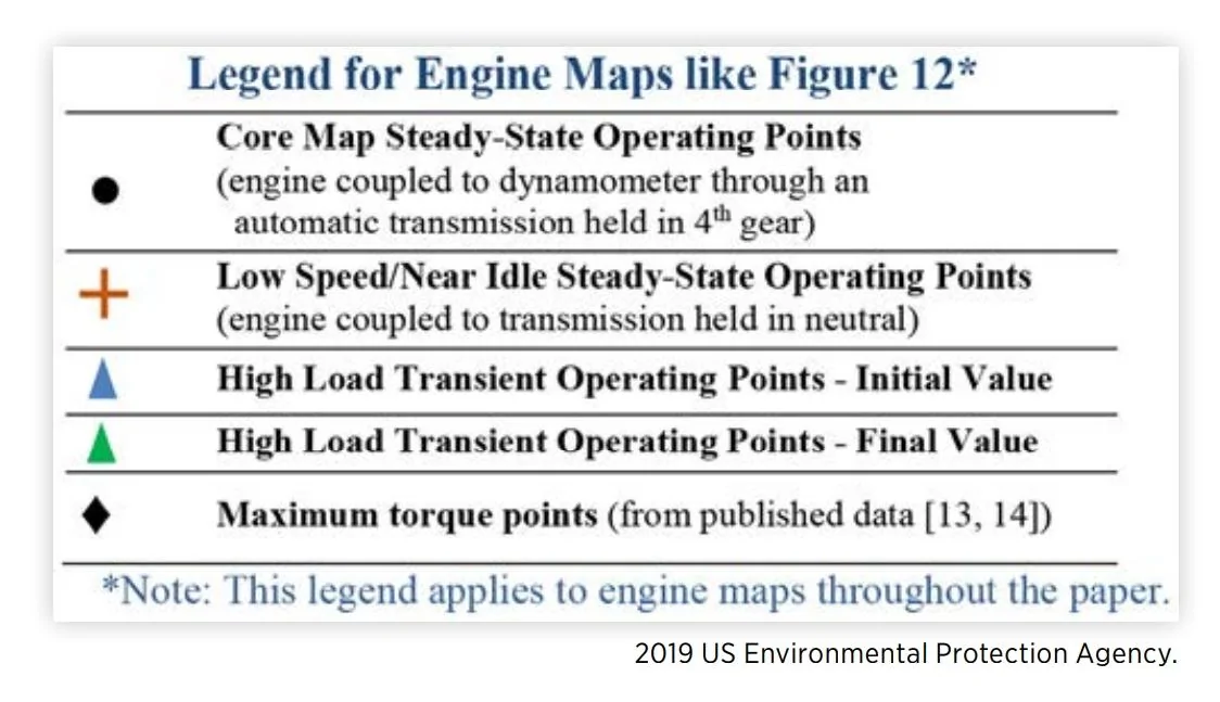

... Once the compression stroke starts, the intake only remains open as long as manifold pressure at the valve is greater than the pressure of the cylinder (very simple understanding version)
I think that might apply in normally-aspirated engines, but an Atkinson has only just started at 10% underfill (very top color contour). I'm seeing more than twice the expansion-to-intake volume at low RPM. The symbols are defined in the key.

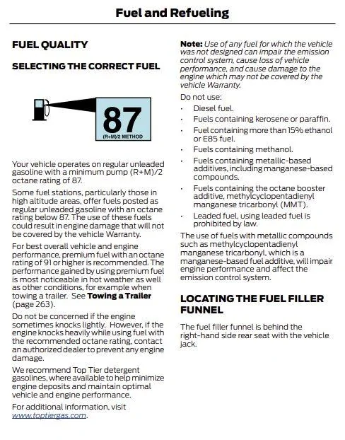

I just looked it up in the Maverick Owner's Manual that I downloaded from Ford.
87 octane is fine.
91 or higher may give you a better experience in some situations.
There is no single answer for everyone under every condition. Try different grades and use what you like.
Here is what the manual says on Page 172:
Your vehicle operates on regular unleaded
gasoline with a minimum pump (R+M)/2
octane rating of 87.
For best overall vehicle and engine
performance, premium fuel with an octane
rating of 91 or higher is recommended.
The performance gained by using premium fuel
is most noticeable in hot weather as well
as other conditions, for example when
towing a trailer.
