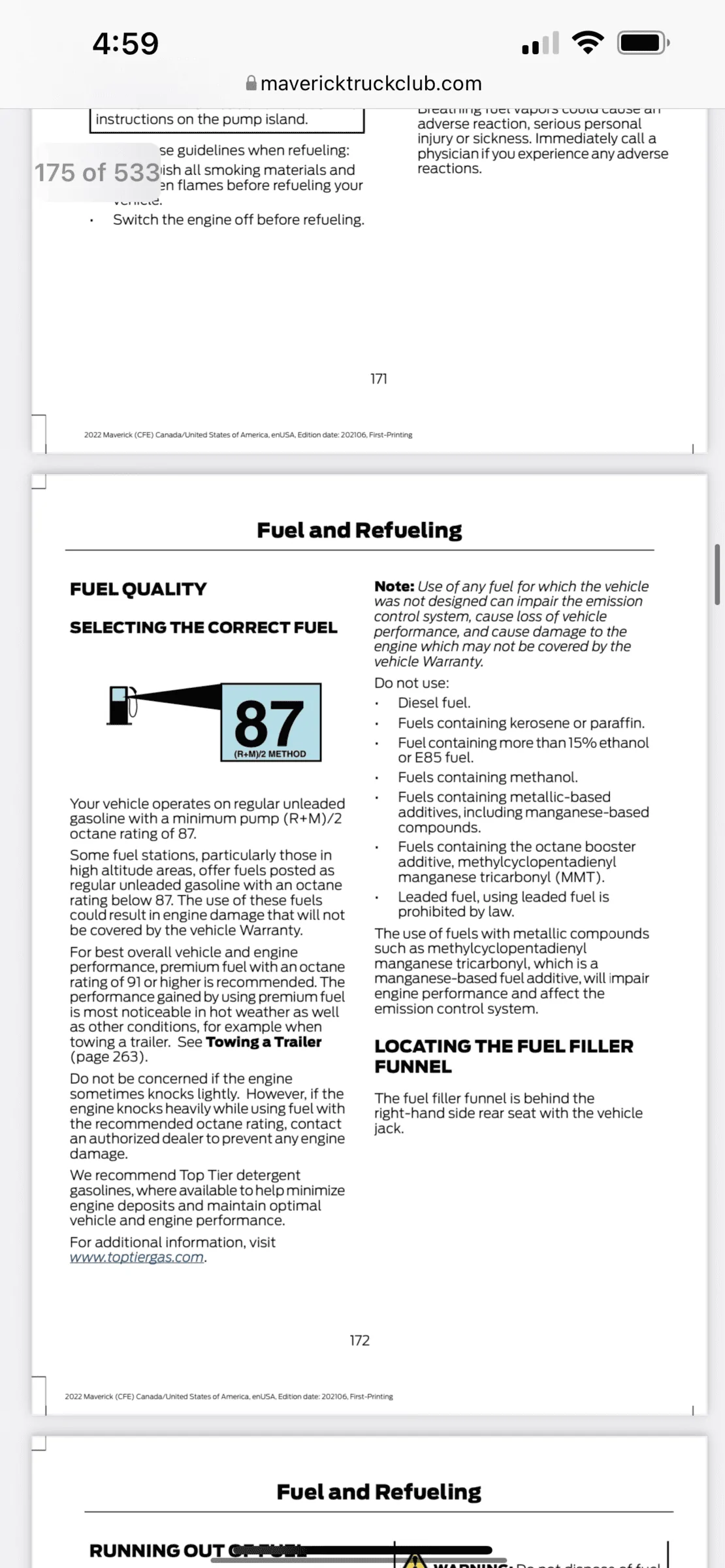

Rnmedic45
Doug
Oct 2, 2021
107
107
Central PA
F150, 65 Galaxy ,2020 Spyder
Your vehicle operates on regular unleaded
gasoline with a minimum pump (R+M)/2
octane rating of 87.
Some fuel stations, particularly those in
high altitude areas, offer fuels posted as
regular unleaded gasoline with an octane
rating below 87. The use of these fuels
could result in engine damage that will not
be covered by the vehicle Warranty.
For best overall vehicle and engine
performance, premium fuel with an octane
rating of 91 or higher is recommended. The
performance gained by using premium fuel
is most noticeable in hot weather as well
as other conditions, for example when
towing a trailer. See Towing a Trailer
jewc75
Nov 24, 2021
796
918
18 Z06 12 Mustang 22 Maverick 93 Lightning 19 GTI
I was just going to post this. I run ethanol free 90 octane and get 27 mpg with mixed driving. Some people should learn to read the owners manual.
