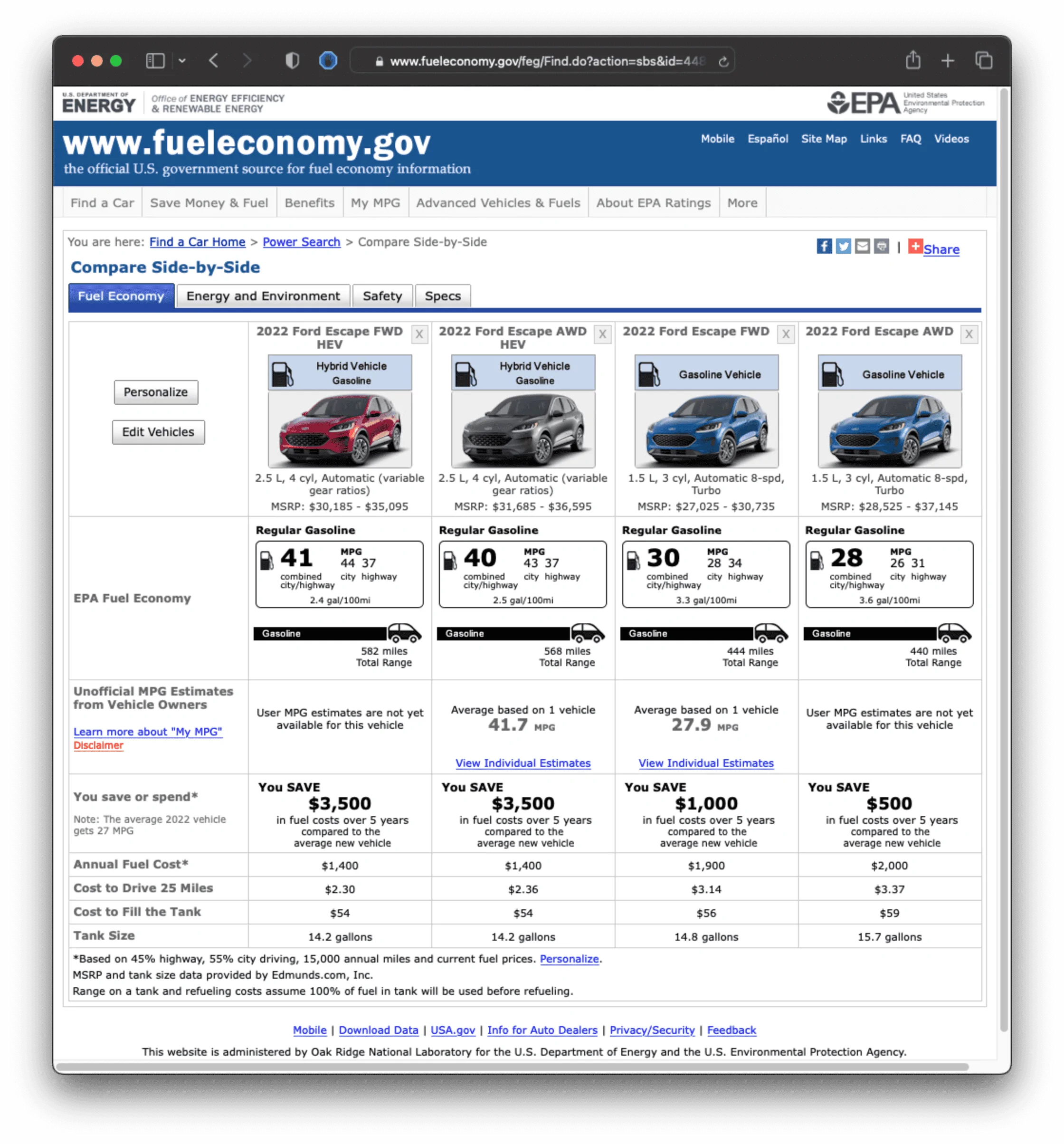

Except Ford has already done both with the Escape (driveshaft) and the Corsair (motor). Guess which is the cheaper vehicle.
Also, AWD doesn't impact the HVB size on Escape AWD or Corsair GT (PHEV) AWD. Corsair GT uses the one HVB for both MG1 and MG2 on the eCVT, and the eAWD motor on the rear axle.
My Escape FHEV AWD not only has the same HVB as a FWD hybrid, the EPA rating only drops 1 mpg city and combined (highway remains unchanged).
Meanwhile Escape ICE AWD loses 2 mpg city, 3 mpg hwy, 2 mpg combined, so it gets a bigger tank to compensate.
