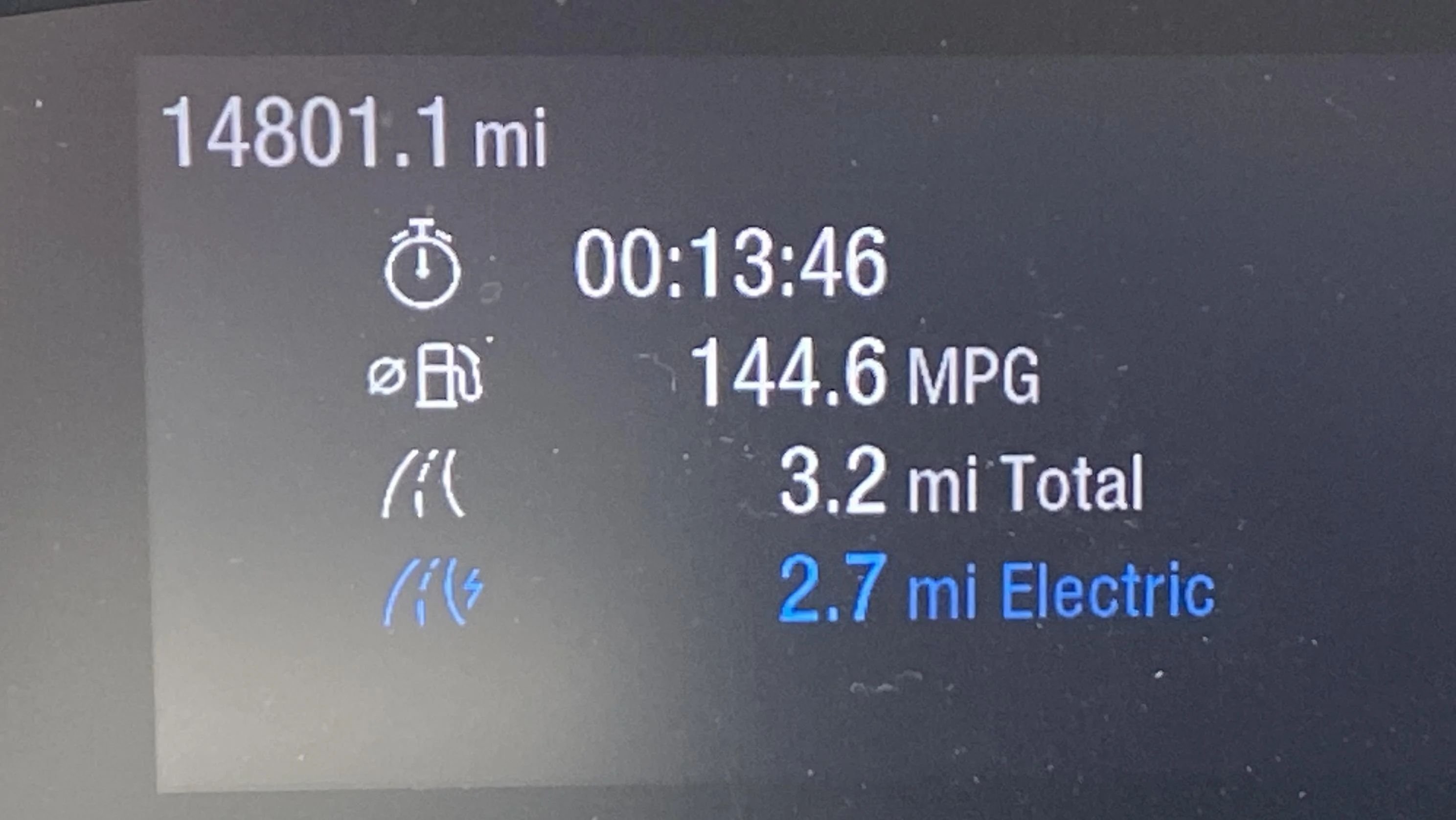

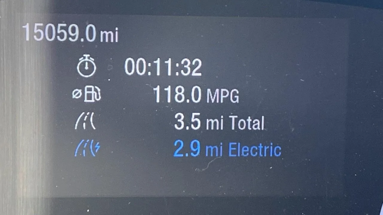

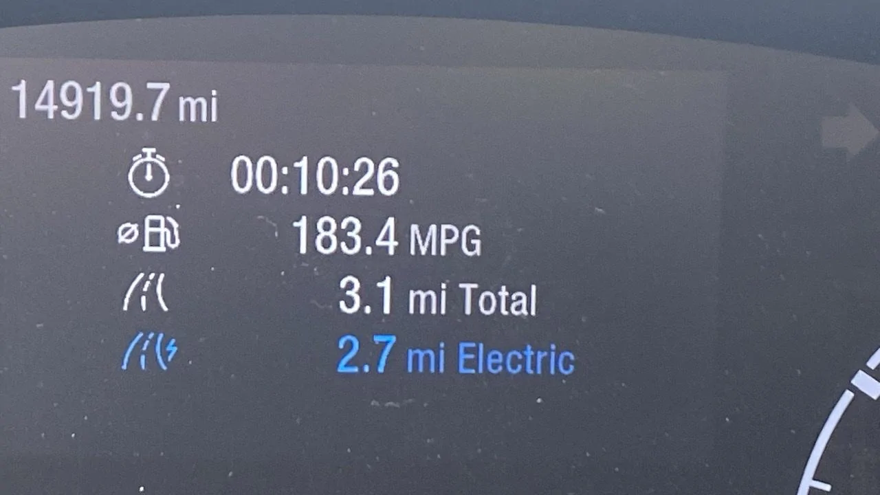

GPSMan
Jul 28, 2022
4,325
5,358
Many
Some people say short trips don't count. Why?
When I do this 100 times in 2 months during the same tank, I think it counts.
To be fair, this was on a warm engine already.
Ford Maverick Anyone added a second hybrid battery? 4B1F8318-CD59-4249-80BA-CA81B8D614EA
Ford Maverick Anyone added a second hybrid battery? 3576314C-C3E4-47CC-839B-711C81A8672D
Ford Maverick Anyone added a second hybrid battery? 1698094802915
But.... I do this every lunch break, 5 days a week. Tell me why we need a larger battery.
Out of 11 minutes of driving, my engine ran a total of 32 seconds. Yes, I timed it.
And this won't work so well in cold weather. Nice, 73°F here.
